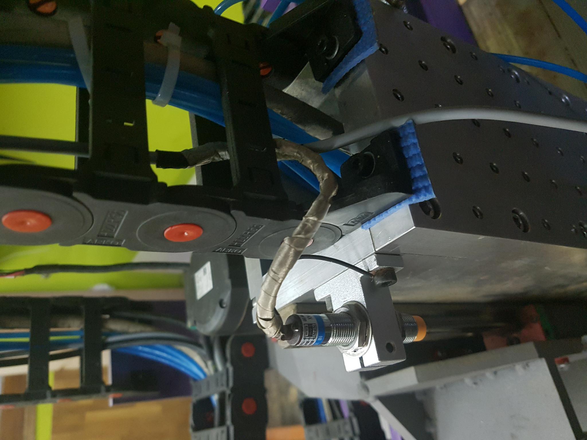

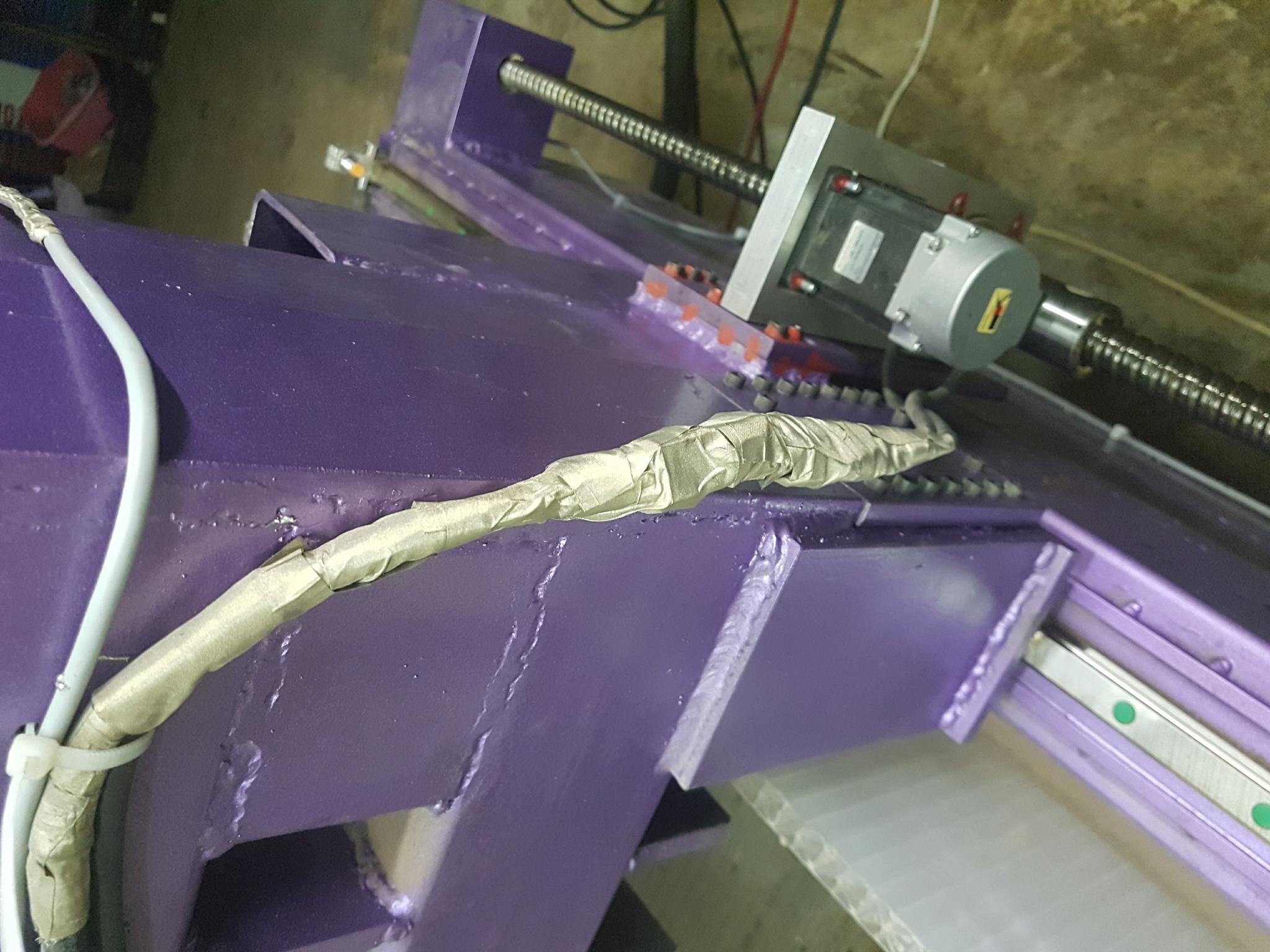

    Hardwired. And buy yourself conductive tape from Aliexpress, so motor, limit switch and similar are properly grounded both sides

    Just curious, Boyan - how do you deploy your conductive tape? Would you mind elaborating?

    Quote Originally Posted by GND View Post
    Limit switches and servo connection example. may be not "by the book" as it must be using collars bolted to frame, but works fine

    Thanks Boyan - so essentially shielding?
