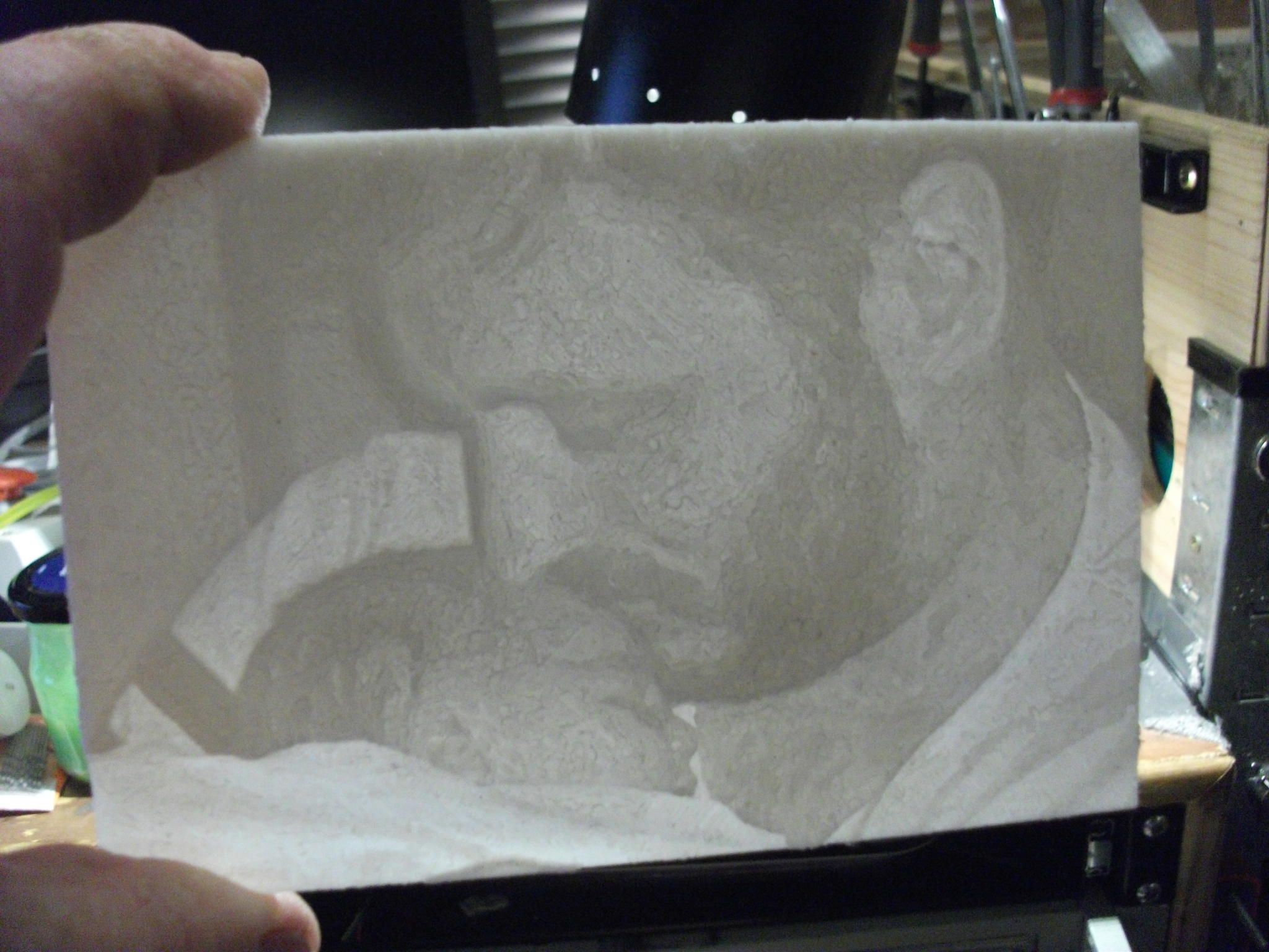

    My son is interested in Fusion 360, he teaches design and technology, so hopefully he can get a freebie. I an interested in it because I am getting titsed off with what sketchup can't do or won't do properly (I would never spend money on that software, it is crap). My son is interested in laying photos onto sculpted forms. I want to 3D print a case for an electronic (MIDI) harmonica I am developing.
    In the meantime here is a lithophane 3D printed from a photo using Cura. My first attempt, I am very happy with it.
