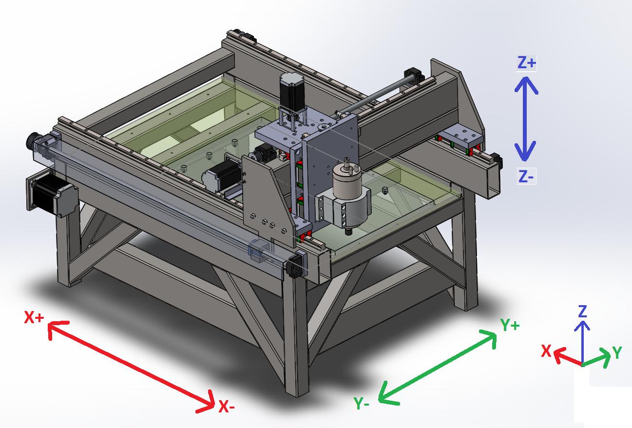

    Hi guys, might be a bit of a daft question but just wondering what the typical setup is for homing/axis direction on a moving gantry type router? I ask because mine currently looks like this (left hand rule coordinates?) shown in home position:
Name:	CNC Router Coordinate.png

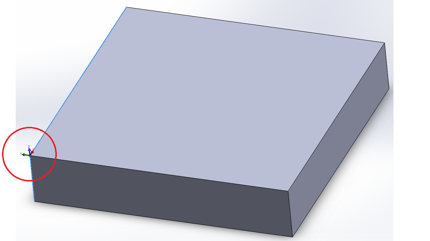

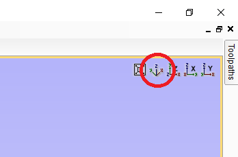

    But most CAM packages seem to use a 'right hand rule' type coordinate system where Y is in the opposite direction:
Name:	Aspire Coordinate.png
ID:	20478Click image for larger version.
Name:	SolidWorks Coordinates.png
    Have I just got this wrong and simply need to reverse the Y motor in Mach3/home at the bottom right corner of the machine or is there another way of doing this?
    Thanks.
    You need to use a right hand coordinate system, as that's all that mach3 supports.
    The actual Home position can be anywhere you want.
    Gerry

    Thanks Gerry, I will reverse the Y axis direction and also reverse the Y home position. This should keep me within positive machine coordinates, as going negative on MC will only confuse me more!!
