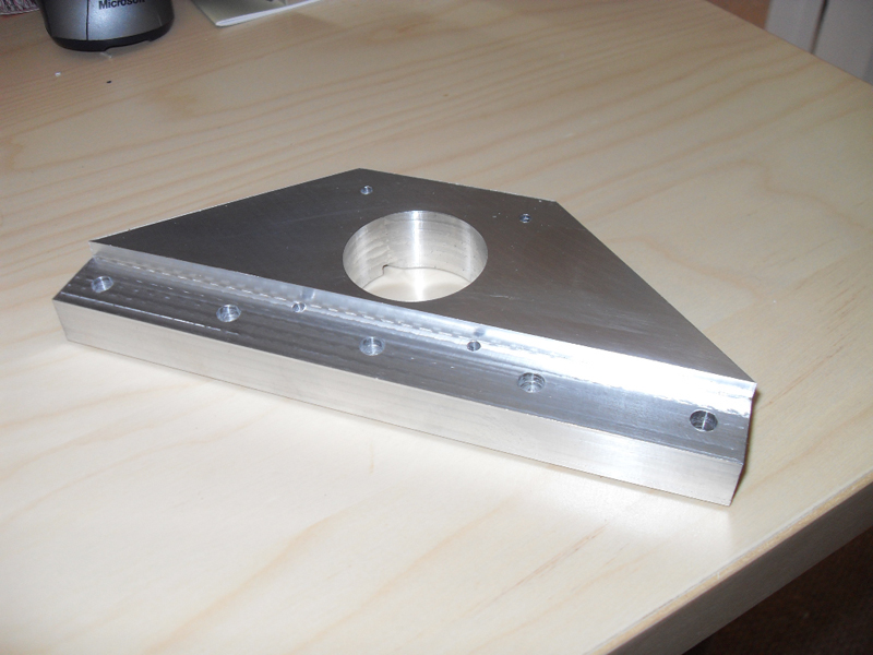

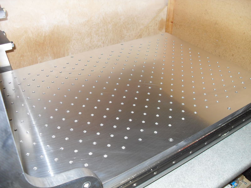

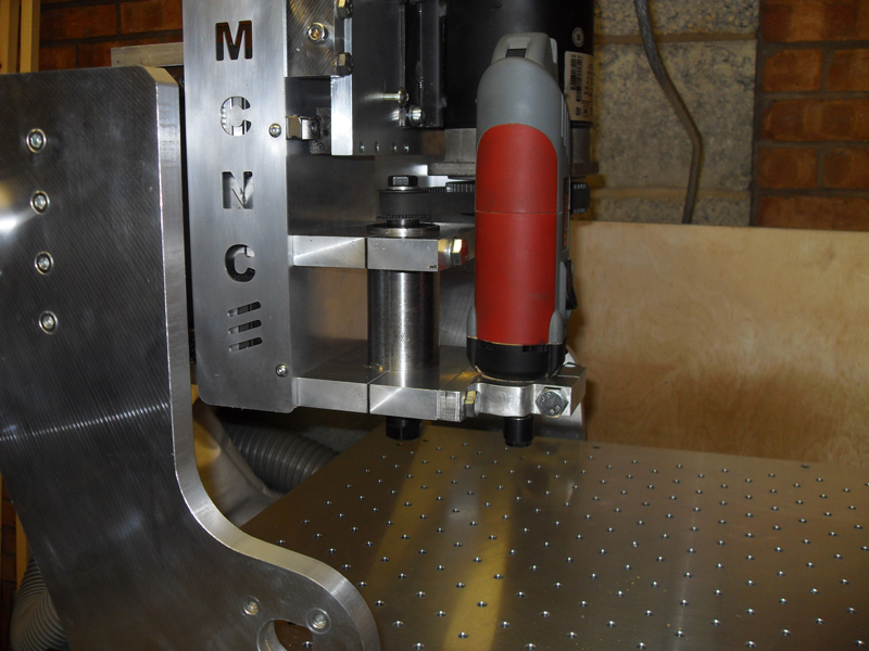

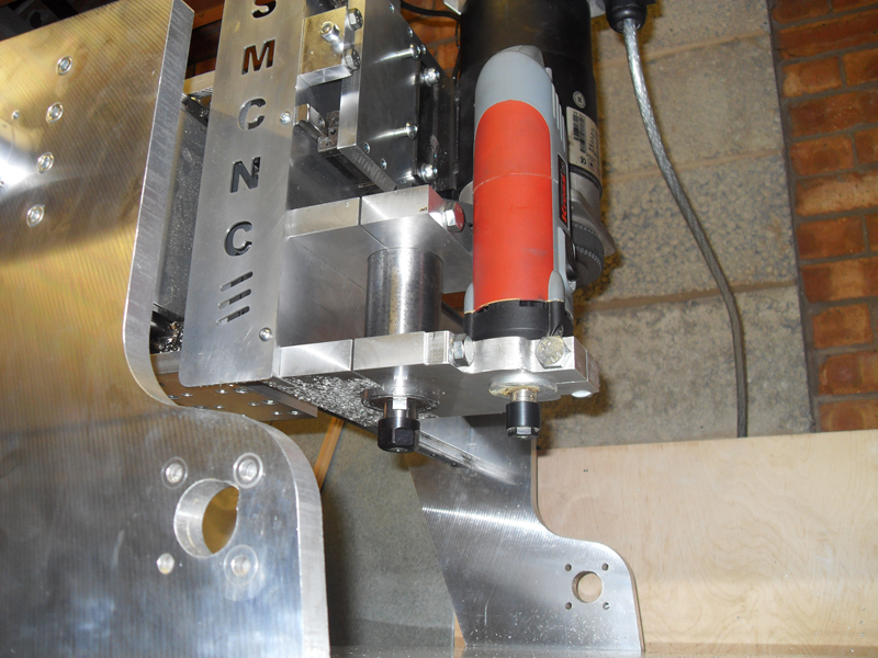

    So I have attached some build pics which I have been taking while putting it together for you all to take the piss, point out the faults, tell me how nice it looks, etc etc.
    There are 2 issue's I have with the machine at the moment and I am hoping for some sensible solutions please......
    1 - The steppers run a bit notchy when at low speed, this may be normal but I am pretty new to all this, still seems to mill nice. Tried them on various microsteeping settings which did not make a difference and also Roy's advice from DIYCNC which made a slight improvement but I am still not 100% happy with them.
    2 - Vibration on ballnuts when running between 1500 and 2700 mm per min, especially the 1m x axis. The nuts are lined up spot on with the screws to the point were I have been shimming them with shim steel to fine tune them. I can make the vibration go away by putting slight side force on the screw in any direction near the nut when running but did not think that was a solution. There is a very slight runout on the X axis screw in the centre and I mean very slight... bigger ballscrews, better quality or more grease???
    The MDF bed is only temporary, I plan on making a T slot bed later on. Need to do a bit more testing and fine tuning first.
    The large holes surrounded by the 4 smaller ones in the sideplates are for the built in 4th axis when I get round to it, that was John S's idea!
