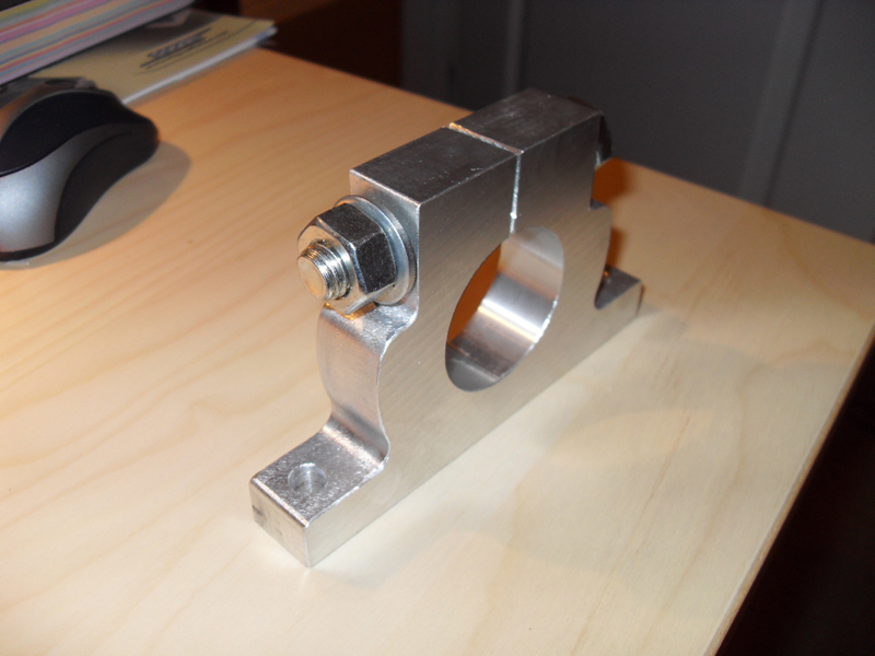

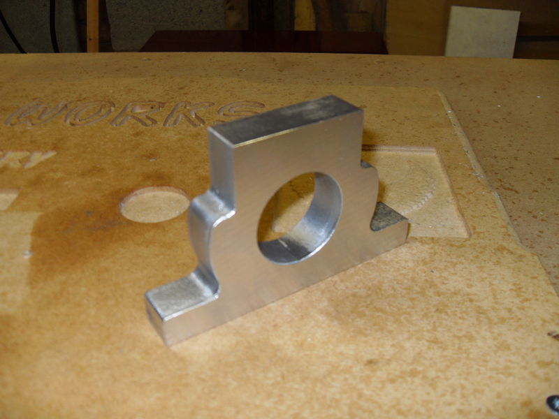

    Just been playing with my new toy.
    Just made this.....
    Cycle time 7 mins
    Cutter - Solid carbide 6mm dia 3 flute endmill
    Spindle speed - No.2 on Kress router
    Depth of cut - 2mm
    Feedrate -800mm/min
    Made a bit of noise and a lot of mess but i am quite impressed, just did it all in one pass, next time i will rough it and finish it then it should come out even nicer.

  4. #14
    Yabut when Kip gets his free to a good home plasma working it will do the same thing in 5 seconds in hardened steel to 4 microns.
    Alltogether now "We don't want no skeenking alloy"
    :rofl:

    Quote Originally Posted by Hemsworthlad View Post
    Stop it Now. . .. . your teasing me on purpose.:nope:
    Looks great to me just has is mate. . . . . If my machine cuts like that I,ll be well chuffed.
    Another pic below of the finished article, just had to finish it off..!
