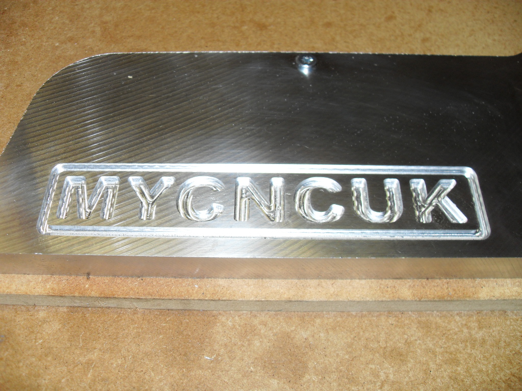

    Photo of same logo in aluminium.....
    3mm cutter
    600mm/min
    took about 10 mins.
    I think I could seriously speed it up by taking less material in one cut and up the feedrates, going to have another go now...

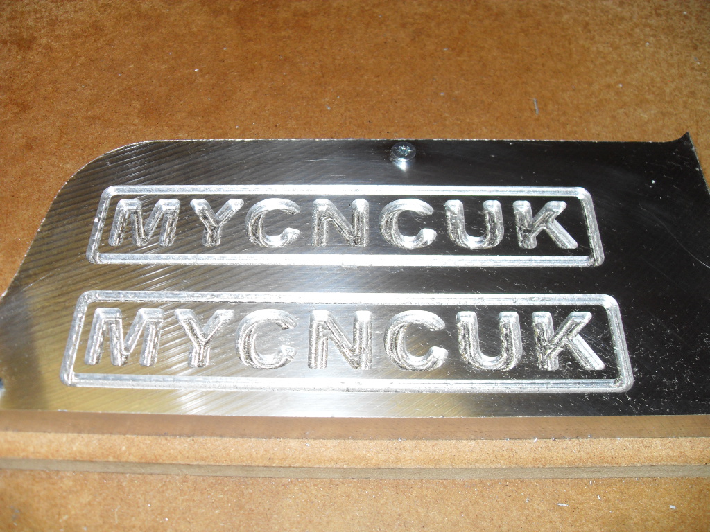

    Nice job john, what cutters did you use for that??
    Just had another go at the MYCNCUK logo with different method -
    3mm coated carbide cutter running at between no.3 and no.4 on the kress.
    Finish depth 3mm both times.
    1st time -
    Rough it out with 1.5mm depth of cut @ 600mm/min leaving 0.5mm on the sides then finish it at same speed. Time taken - 10mins
    2nd time -
    Rough it out with 1mm depth of cut @ 1000mm/min, fancy ramping moves instead of plunging, leaving 0.3 in the bottom and 0.5 on the sides, finish cut at the same speed. Time taken - 11 mins
    Problem is cutter keeps getting clogged up, did not stop it just tried to dodge the large clogged up bits coming off the cutter now and again.
    Will be buying some proper cutters for aluminium tomorrow, see if thats any better.

    Steve,
    The problem is recutting chips, the less flutes the better as it's not the cutting action that's the problem, it's the space for the chips to go.
    A single flute router cutter works best in alloy unless you buy special cutters.
    Even then you need coolant, well more lubricant to be precise to stop the welding to the tool.
    WD40 is advise for aleoy and it works well but being tight I make my own, 75% paraffin and 25% ATF or any light hydraulic oil.
    Modify an oild spray gun to give you plenty of air but just a dribble of knacker laqueur.
    John S -

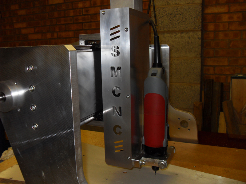

    Been playing with my machine again trying to get aluminium to cut nice and...
    John, you were right. (No suprise there then! )
    Tried a few different methods of profiling some 2mm aluminium sheet and came to the conclusion that slower is better with these 3 flute cutters that I have.
    After various speeds and welding some ali to a 3mm cutter (is there an easy way to get it off without breaking the tool??) I ended up with the kress set on 1 and cutting at 100mm/min with a full 2mm cut straight through the plate, started chipping lovely, gave it a squirt of wd40 and vacuumed the chips up now and again.
    I believe that any reasonably built router will be capable of cutting ali with the right speeds and feeds as the cutting forces are very low.
    I think I will be able to go a bit quicker with the 2 flute ali master cutters that I have ordered but I will let you know tomorrow.
    So here is a photo of my new Z axis sideplate.....
Name:	Z axis sideplate.jpg
