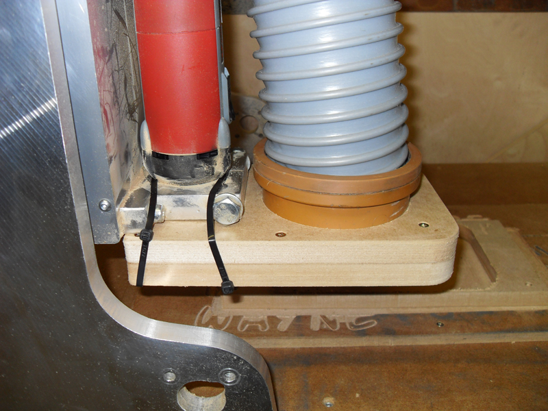

Been playing with my machine for a few weeks now and everything is running sweet, the only problem I have is getting rid of the dust / chips when cutting wood and MDF, its amazing how much crap a 6mm cutter can create in very short space of time! Up to now I have been using our old Dyson vacuum which to be fair does a reasonable job but not really up to continous use and will soon be dead if I carry on abusing it!
So yesterday I went out and bought myself a small(ish) dust and chip extractor (see photo's below) which came with a standard 4" flexible pipe, this baby is quieter, shifts a lot more air and is built to run continously.
Now I have seen the router dust extractor mounts that fit around the spindle with the brush's and plastic flaps but just did not like the idea. Seems to me that they will probably end up getting in the way when cutting or changing tools so.... I had an idea and knocked up and bit of a prototype out of a couple of bits of MDF and the top off of an old 4" drain pipe connector this afternoon (see pics).
First test run it worked very well, cut a few deep slots in some MDF and when finished there was little or no dust or chippings around at all.
Still a bit bulky but just wanted to prove the theory a this stage, final design will probably incorporate the router mount into it and make it all out of aluminium.
But before I go any further with this has anyone seen or used anything similar that may be able to throw a few other ideas into the pot???Last edited by HiltonSteve; 07-09-2009 at 01:25 AM.
07-09-2009 #4
Most of the professional ones have a brush curtain to contain the 'splash' from the cutter. Only problem I foresee is that if the base gets to large then it will restrict the x and y movement. It would be great if the system could actually surround the router could aid cooling but would be very hard to design.
