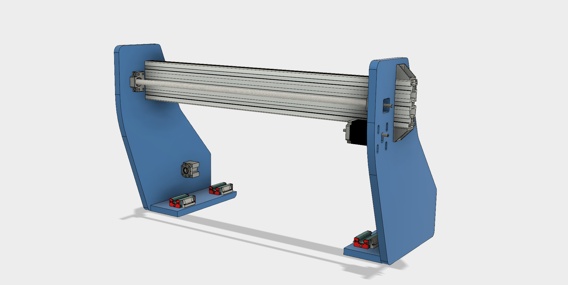

    I have been lurking here for quite a while and learned a lot in the process, so thanks to everyone for that!

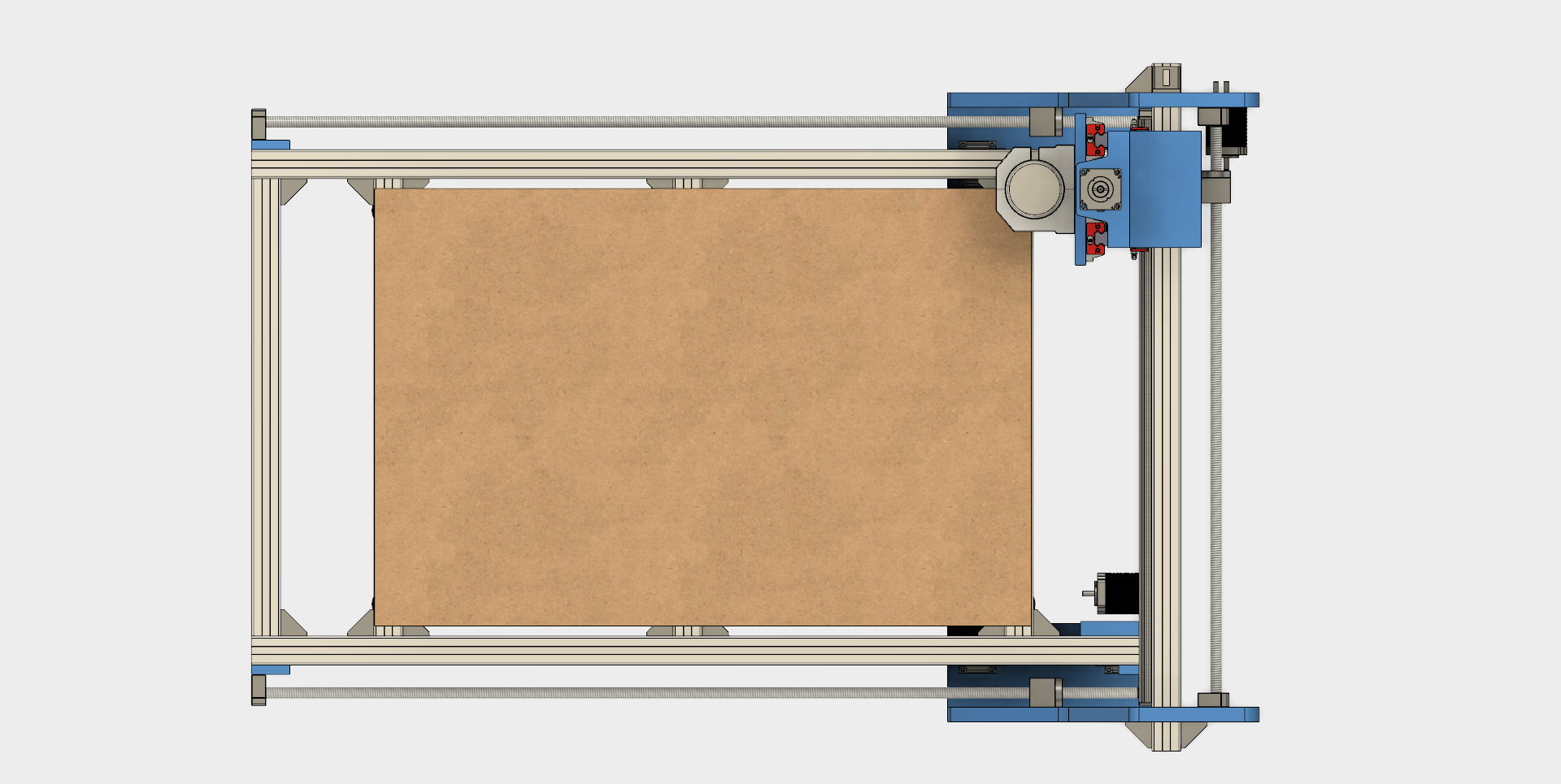

    I've spent a while designing my first ever CNC router based on what I have read here and elsewhere on the interwebs, albeit with absolutely zero experience in the CNC field, so would appreciate comments, criticisms and anything else you care to throw at it, bearing in mind that I have probably little if any idea of what you are talking about.
    This machine will be used for milling soft and hardwoods, plastics and probably some shallow aluminium engraving. The work are is 900mm x 600mm. Much of it is based around 120mm x 80mm t-slot profiles. I have not made any decisions regarding the electronics yet, since I want to get the design to a workable state first. All suggestions regarding the electronics are gratefully received nonetheless.
    The rails (20mm) for the gantry are located under the bed in order to save some width and reduce the amount of dust contact that will inevitably occur. No idea if this is a good idea, or a disaster in the making. Gantry walls are 20mm thick.
    All the motors will be drive belts, which will allow me to play around with pulley ratios. I have read a considerable amount regarding the belts-versus-direct-drive argument, but for my purposes I'm keen on using belts.
    Some piccies below, looking forward to comments, sagacious advice and no doubt some humorous comments with regards to the sheer noobiness of the design. Please be gentle :-).

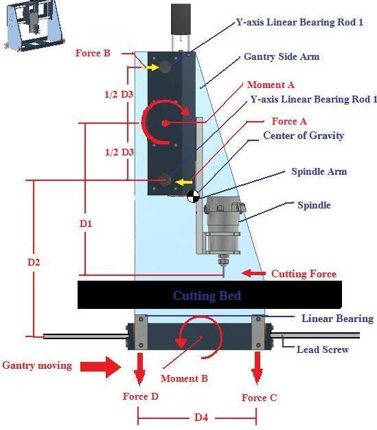

    2. Y blocks I would install on top rather on the bottom (it easy to make guard if you want to protect blocks against dust) - too big arm from bottom blocks to top of the gantry - think about forces

    5. Gantry should be connected on the bottom - not open. This make it stiffer and side plate a bit thin
    I was wondering about the pros and cons, so that's very helpful. Will have to look around for ideas to protect the rails from dust, or at least mitigate the issue.
    I was not sure about that. My thinking was that by using two Y motors, I could save some weight, and the two motors and lead screws would compensate for the added stiffness the connecting plate would provide. Is this incorrect?

    Gantry - more braces make it stiffer - joining them under bed will increase the weight but benefit you gaining by stiffer, more accurate machine are far more important.
