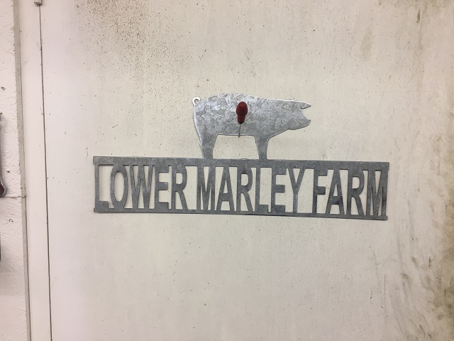

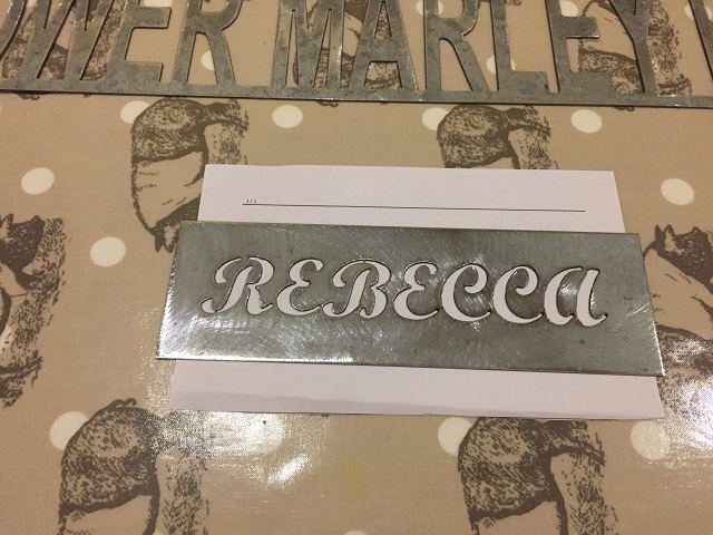

    Load picture into Inkscape (a free program) and use 'trace bitmap'. Save as an .SVG file, and load it into Sheetcam (not free but demo available free to produce Gcode suitable for your chosen controller using one of the many inbuilt post processors
ID:	20584   Click image for larger version.
