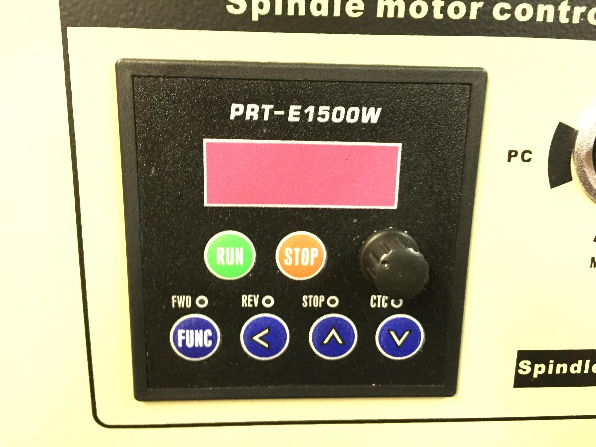

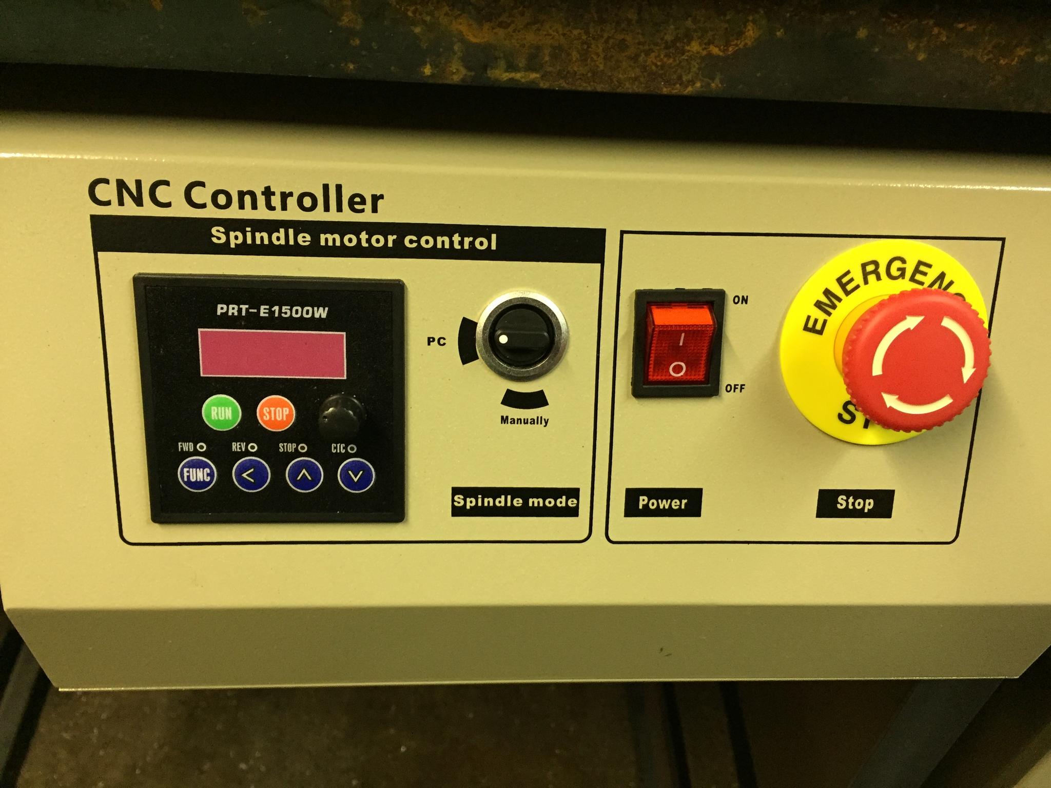

    Hi im still having problems getting my router working it's a 6040 with a 1500w motor. there doesn't seem to be any kind of a signal from Mach 3 to the machine,none of the motors have even tried to work. in the Mach 3 diagnostic's page port 1 pins current state are not light, is this correct. output signal 1 enable 1 is light.
    there is a red stop led light on the control box If i disconnect the parallel cable this light goes off, any help would be appreciated Click image for larger version.

    Right we now know what a PRT E1500W is. It's the inverter for the machine and not the control box.
    Did they supply a Mach setup file with the machine. It should end up blar-blar.xml ?
    If so you need to copy this into the Mach3 folder and when you start up, use the icon that says mach3 Loader and select that name.
    Try that and let us know.

    A really obvious question, if none of the motors have worked. The E-Stop isn't depressed, is it? (once pressed it'll lock in place and stop any motor turning - reset by rotating the mushroom knob clockwise). I know it's obvious, but look at the simple things first.
    Thanks John they didn't supply an xml file just step by step set up of ports and pins, motor etc which I've done and rechecked
