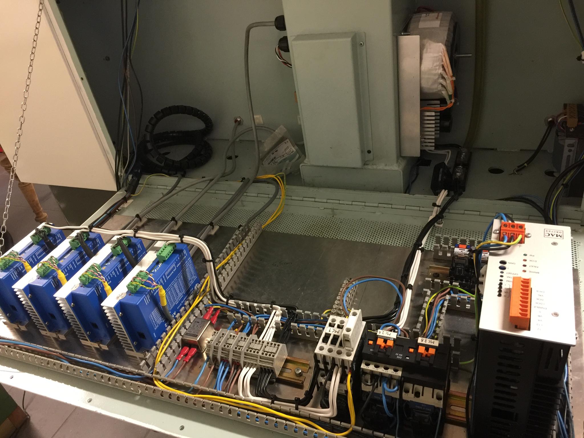

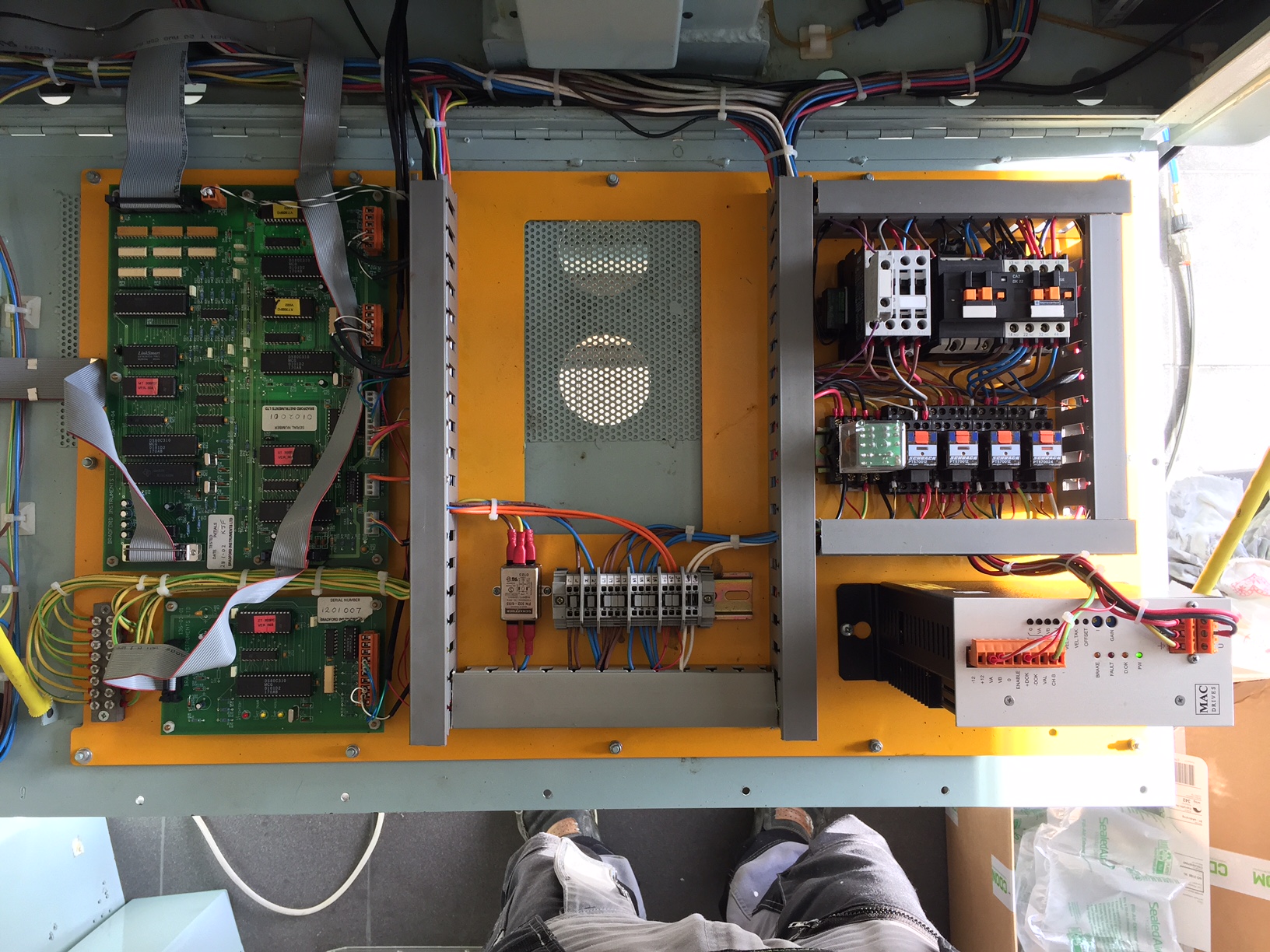

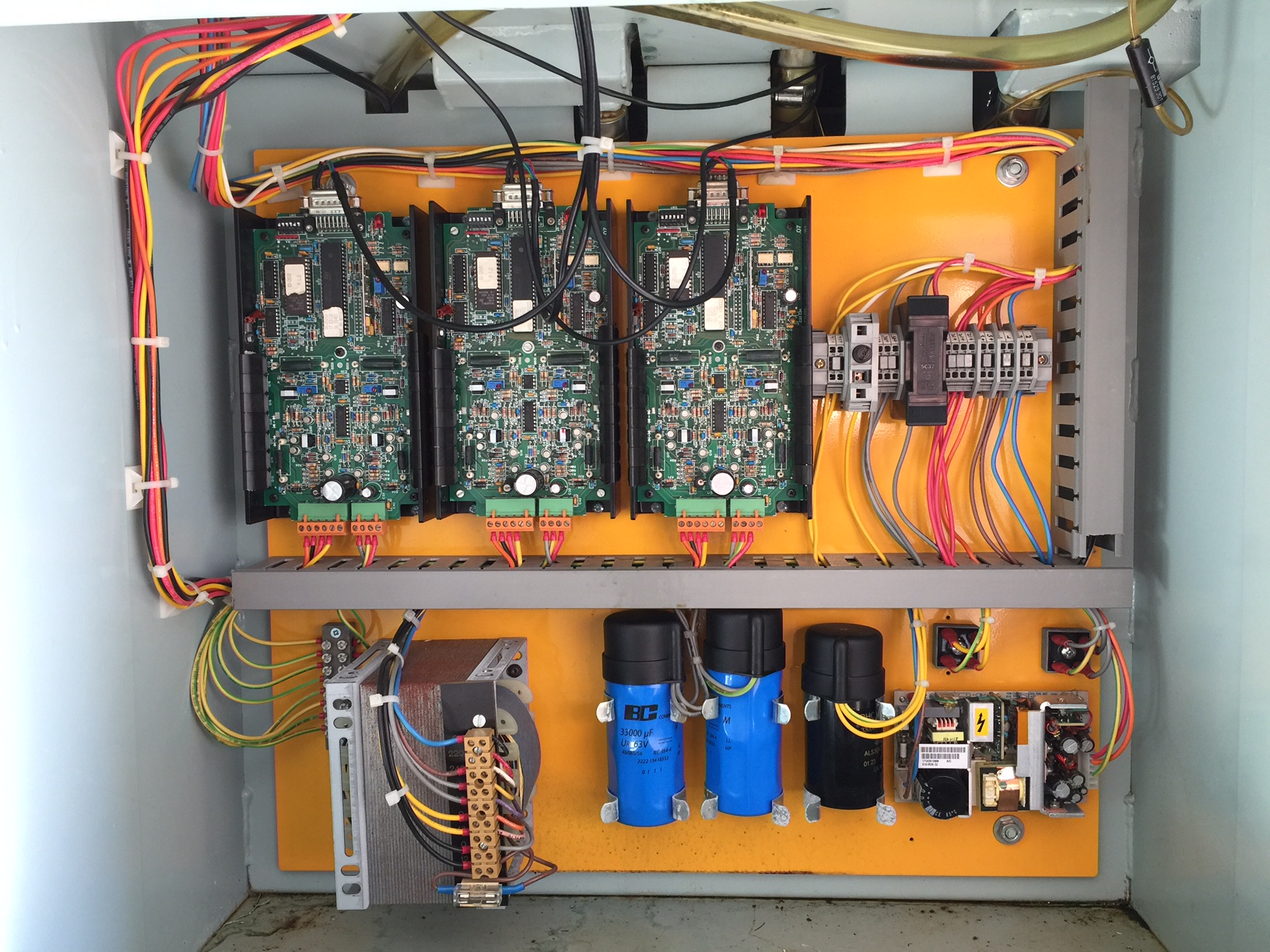

    Well inside and installed in my workshop, i installed the original software on my computer, powered it up and tryed to study the software.
    It was as simple as it gets, and putting it mildly a bit inadequate for my use. Planning for a 4th and perhaps 5th axis, i threw away the software and started to study the parts and electronics inside.

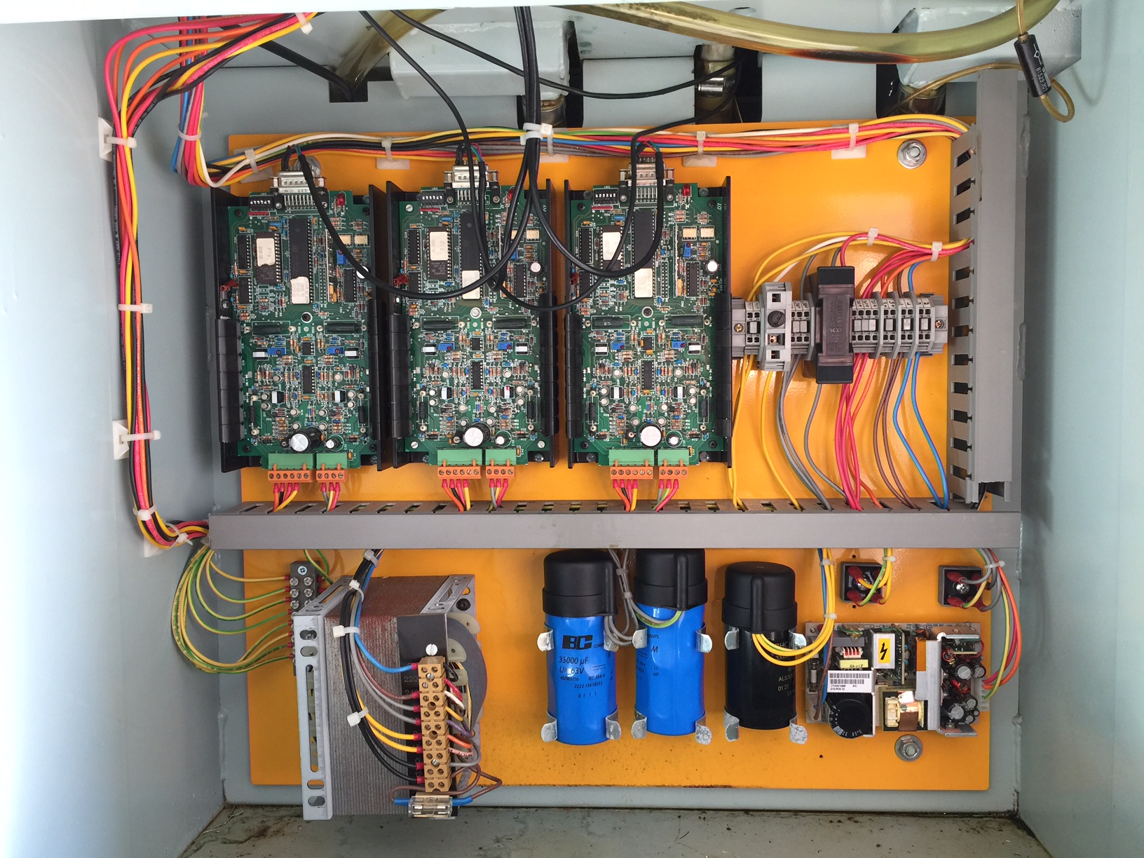

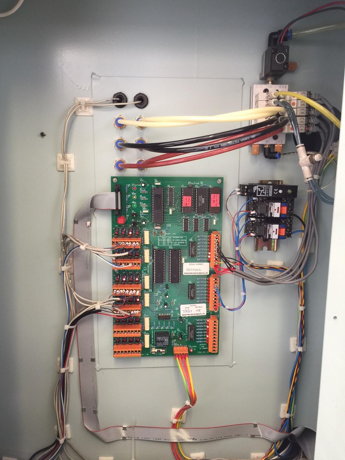

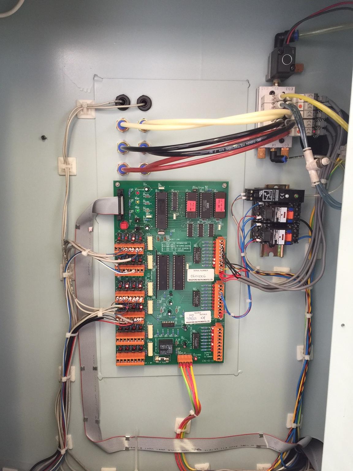

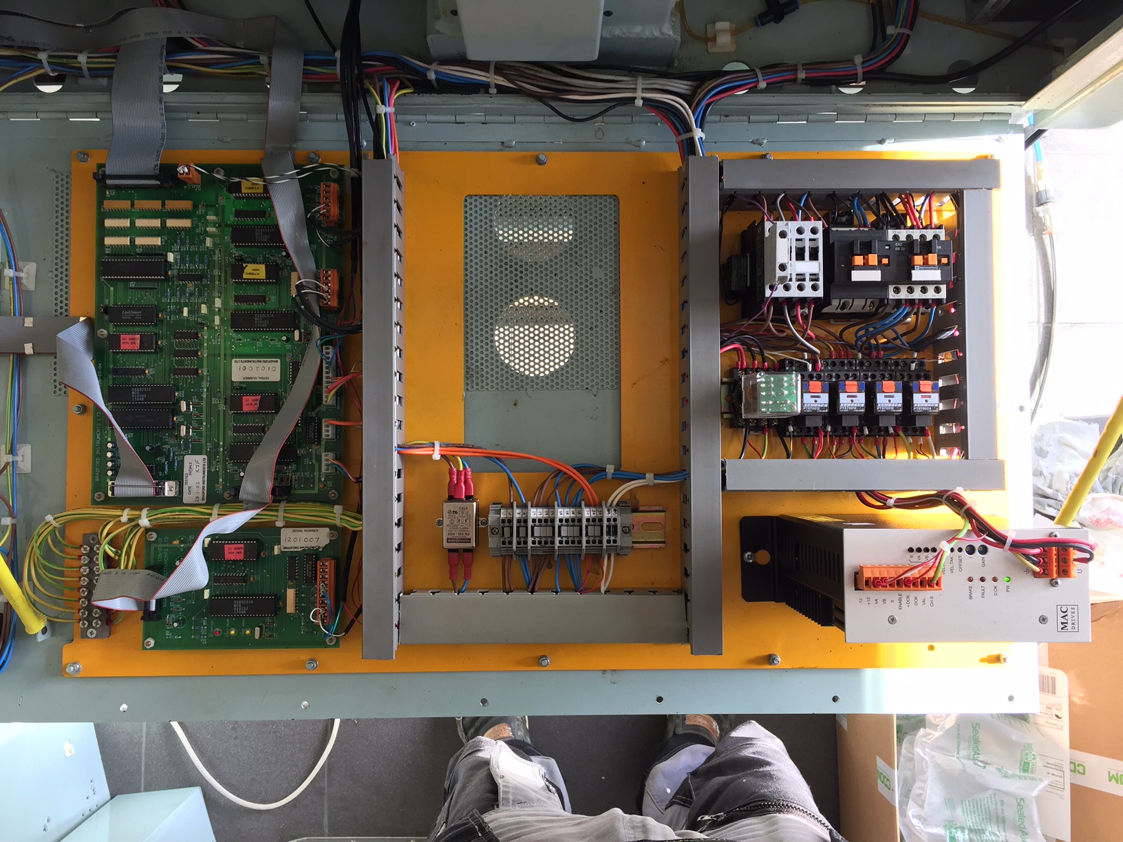

    Finding the data for all parts installed took me a couple of weeks(and i still havent found a wiring diagraphm or datasheet for the MAC/Sirel spindle driver).

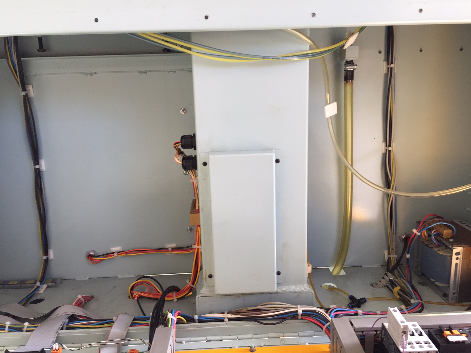

    Some of the electronics was if not ancient, at least antique and had to be replaced. After considering some advice from you guys at the Mycncuk forums, i decided to rip it apart for a full convertion.
    I`m glad i did, cause after a closer inspection i found some of the parts not worn out but slightly rusty, dryed out timing belts and a couple of malfunctioning inductive limit switches.
    But it was no doubt that this machine had seen little use and suffered more from being stored away and being all alone in the dark for several years. Poor thing :-)

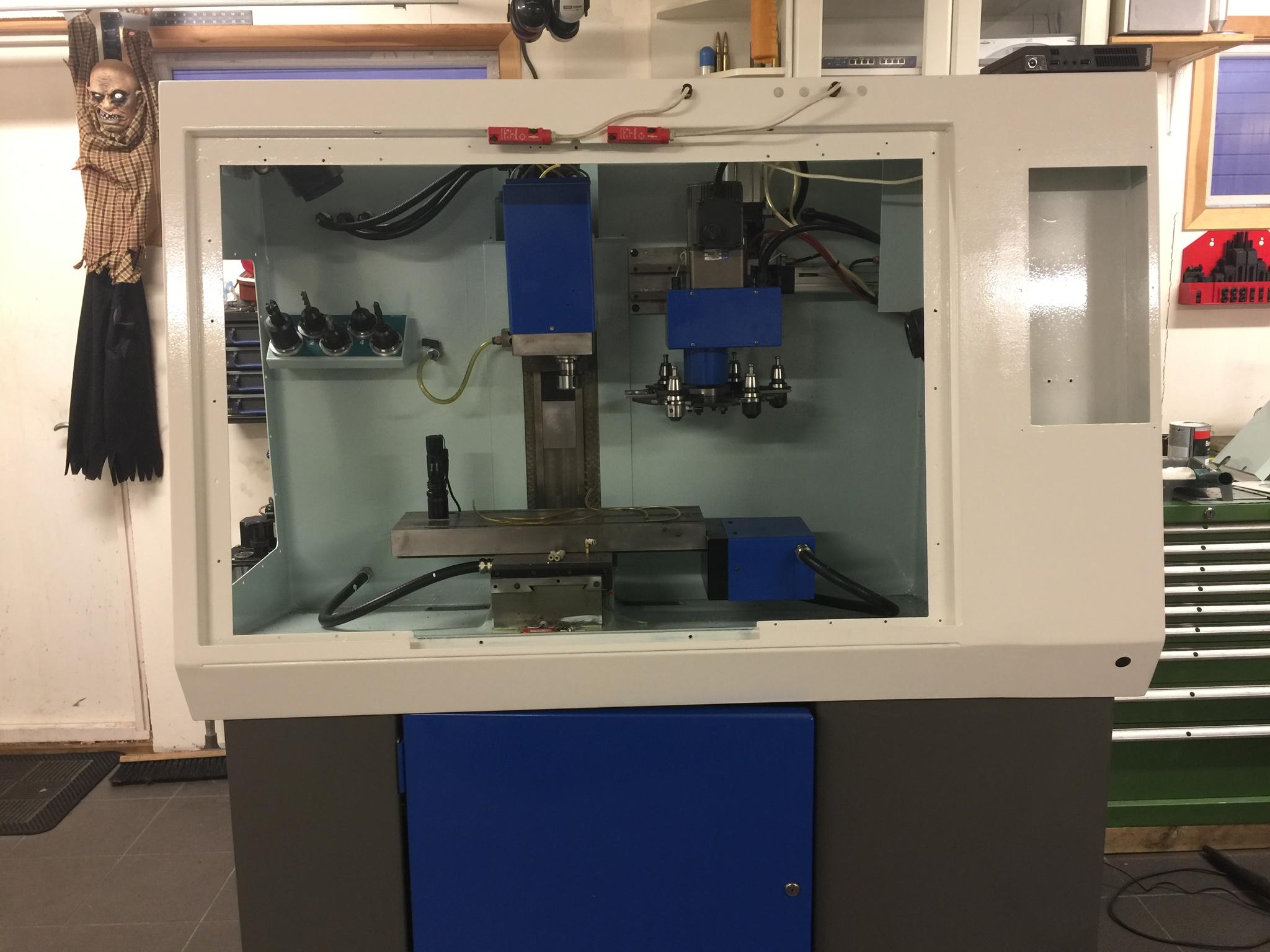

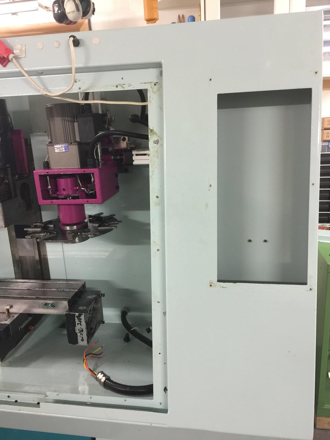

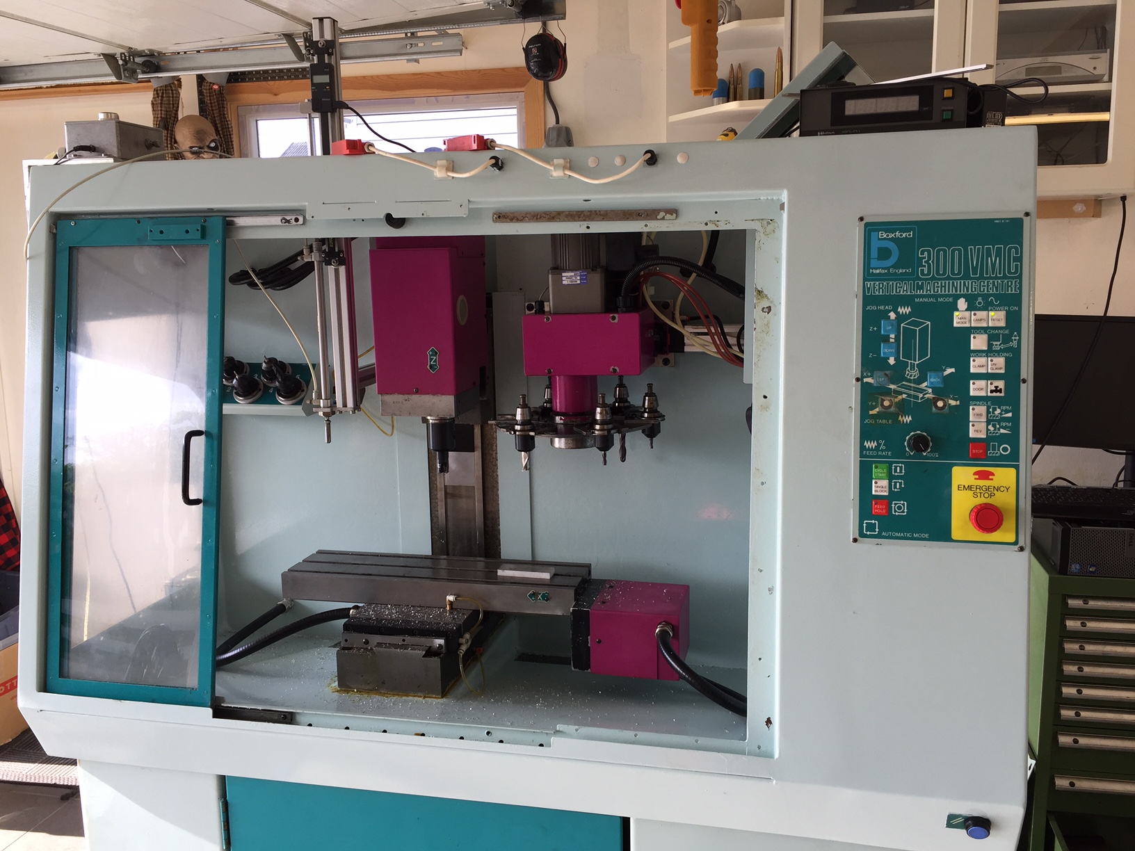

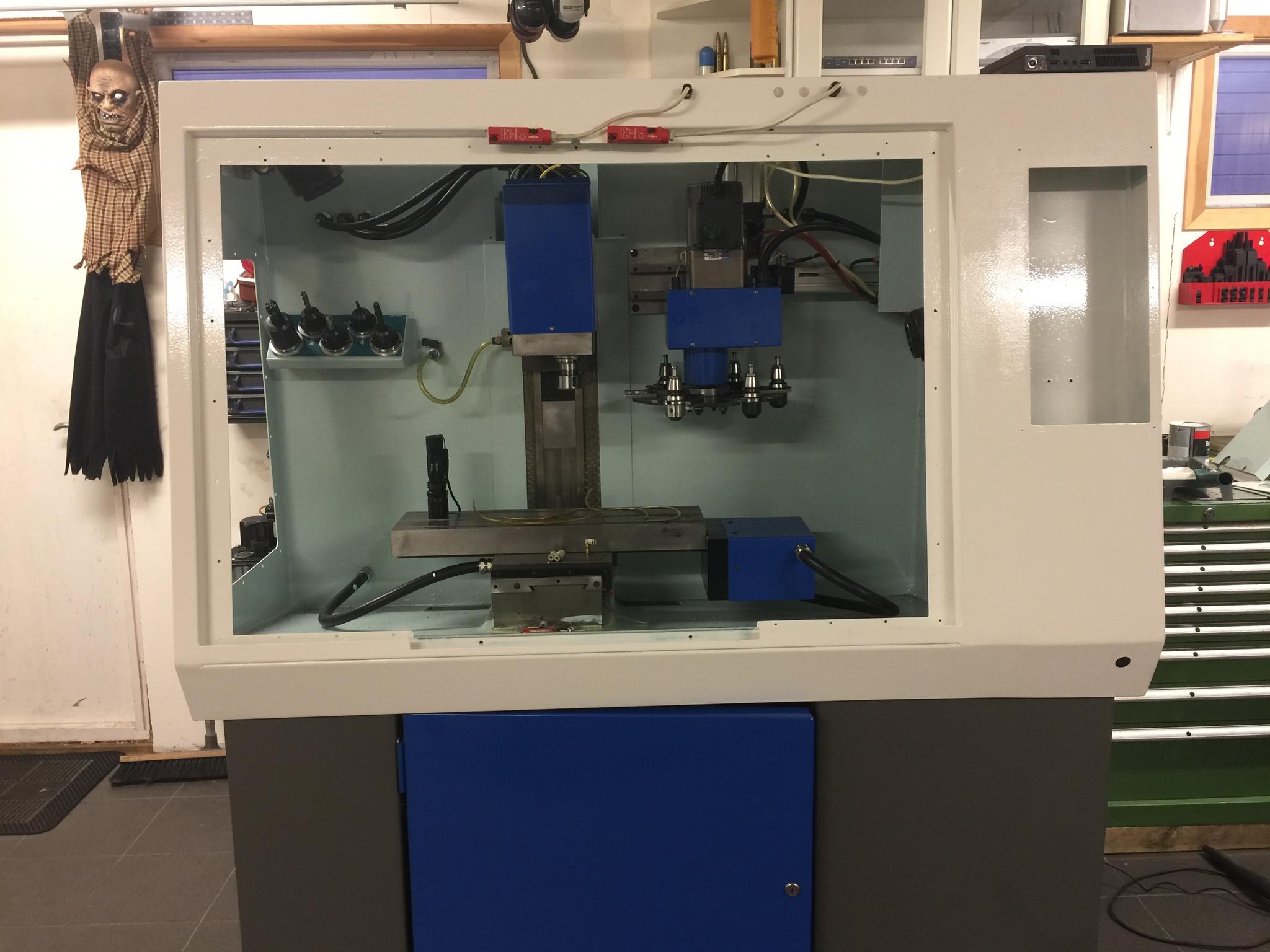

    The coloumn, base and saddle however was in good condition as well as the leadscrews and many other parts.
    The Boxford VMC300 solution is i think a perfect solution as my first VMC convertion. Just love the size of the fully closed cabinet with water outlet and individual compartments.

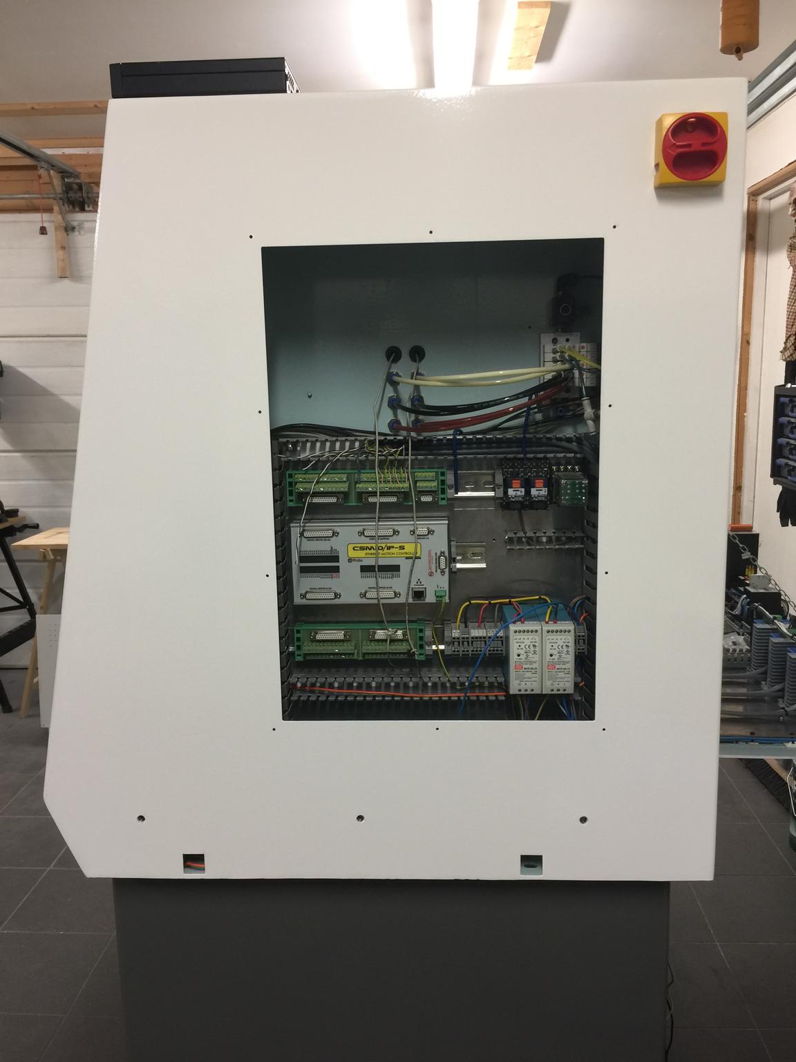

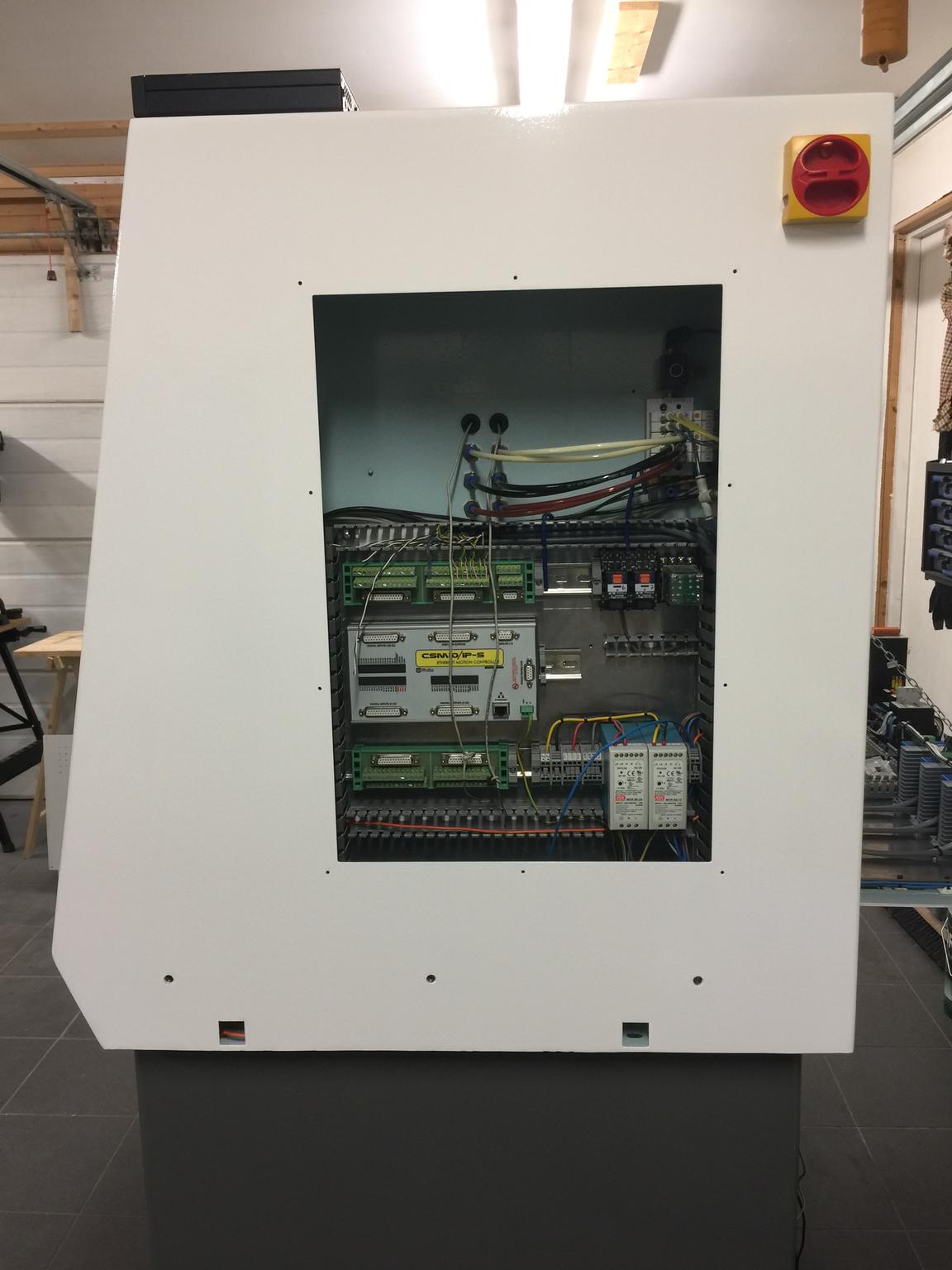

    Based on the original schematics, and datasheets found for all other parts, i started to draw new schematical wiring diagraphm using TinyCad.
    Tryed to calculate the most costeffetive solution for stepper/PSU solution, but i wanted a good controller and ended up with the CSMIO/TP-S from CsLabs. No regrets there.

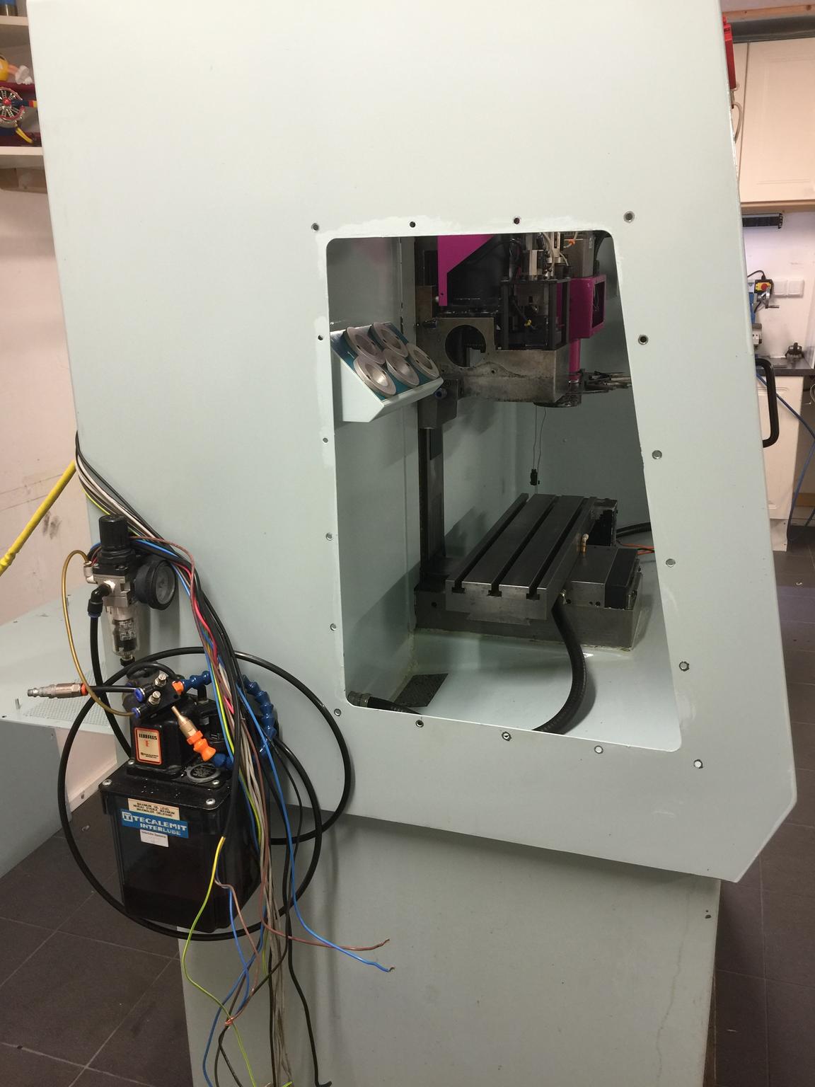

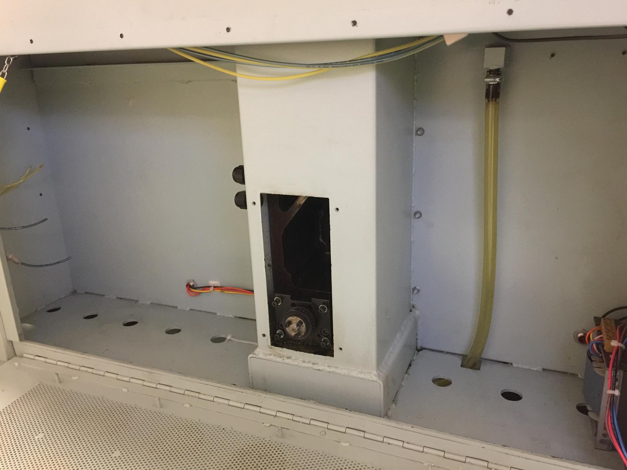

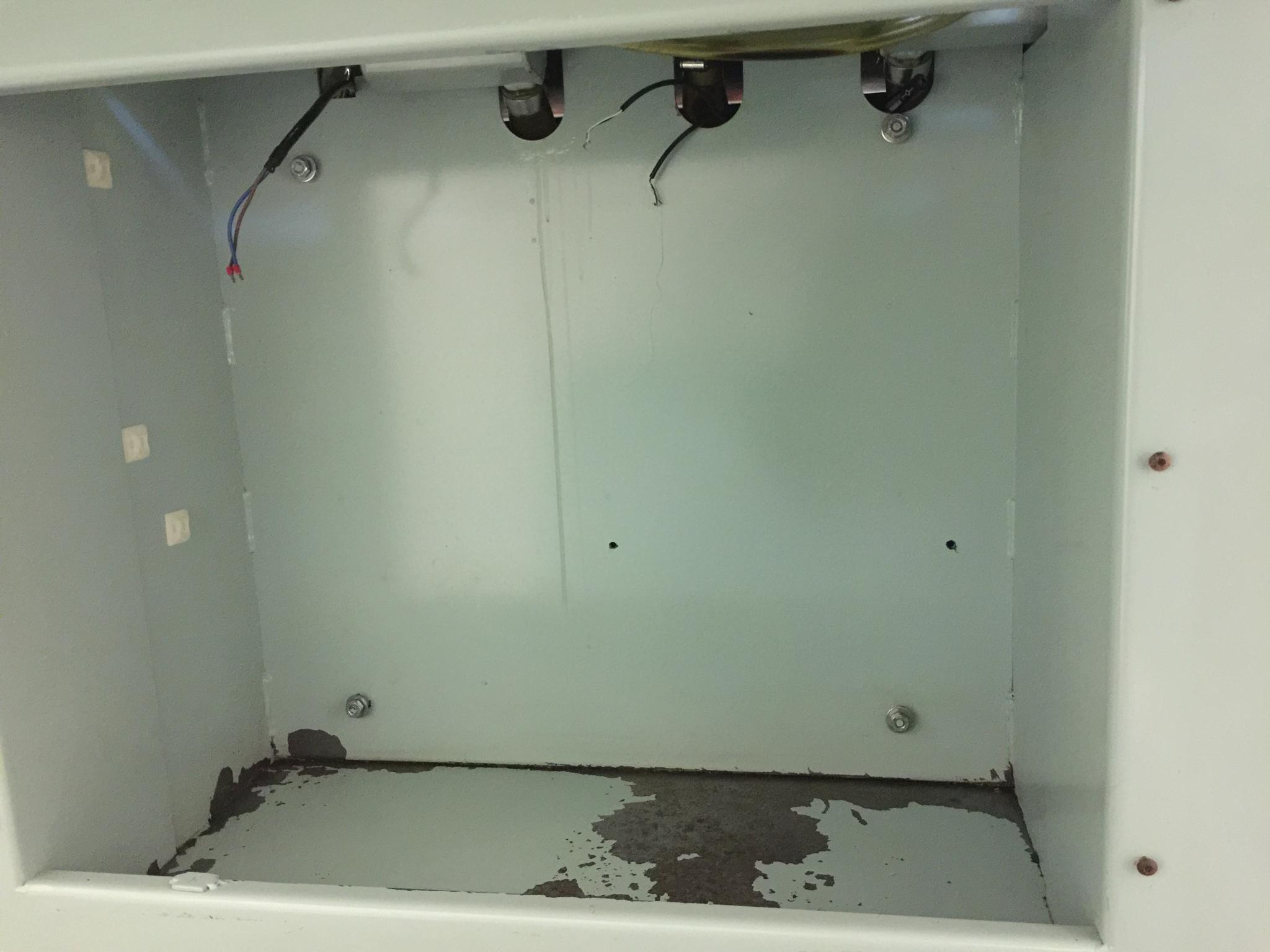

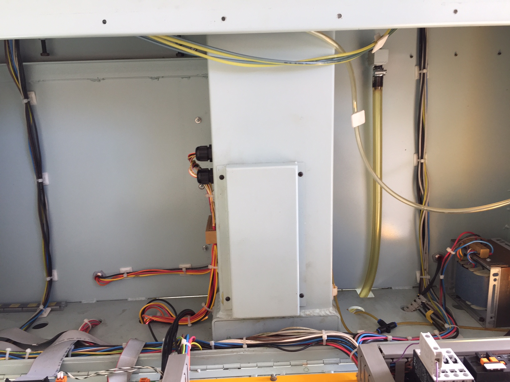

    I ripped out all electronics, motors, leadscrews, sensors, ATC, and got cabinet scrubbed and sanded, cleaned with a Xylen / methyl ethyl acetate based solvent, and repainted it in some more refreshing colors.
    X axis pulley, lock nut and housing was rescued with some solvent and polishing disc work, and everything else in the base and saddle cleaned up. Backlash on leadscrews all checked out nicely.
    Trew the old wires and installed new shielded wires capable of higher currents except for the power cables from PSU to the drivers where i used standard 2,5mm2 PN cables.
    Just about everything on the VMC as well as the ATC was ripped apart and refurbished. Even the tool holders :-).
    All steel parts on the ATC rotating head was treated with gun blue chemical solution instead of black paint(used by Boxford) except for stainless stell parts.

    Some Pictures from the "New VMC"

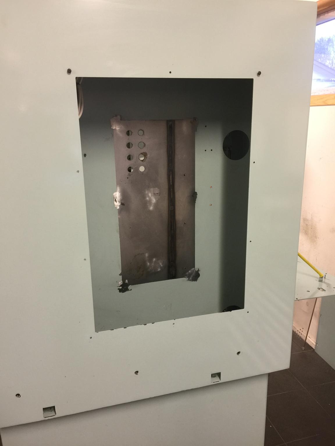

    The front control panel was removed and planned to be replaced by a new brushed stainless steel plate with a slightly different layout for manual controls.
    I`m nearly done with refurbishing this VMC, but some questions came up when i was planning the front panel vs a hinged sidepanel with monitor and keyboard.
    I wanted to be able to control the basic functions manually from the front panel, and i know i can do most of them from the keyboard. But it seems natural to have some of them on the front panel.
    So which functions would you consider necessary as a manual function from the front panel, and which functions are considered as nice to have ?
    Anybody with CSMIO experience know if there will be a problem with a manual overide button in paralell with the CSMIO output port ?
    Example: I will program the CSMIO to start and stop either flood or mist cooling with a relay when running, but i also want to manually start or stop both of them.
    I might be needing the CSMIP-IO unit with the additional 16 digital inputs and 8 digital outputs(i`m a bit short on inputs/outputs due to the ATC), unless i can make some functions manual instead.
    And i`m not shure if i should add the CSMIO-MPG expansion module.
    Anybody that get some immediate thoughts or suggestions?
