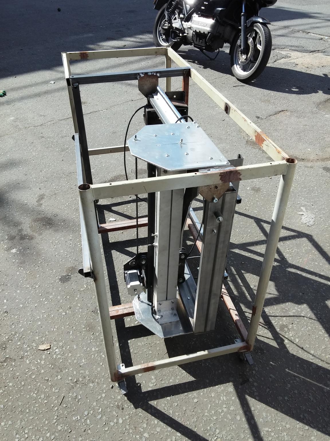

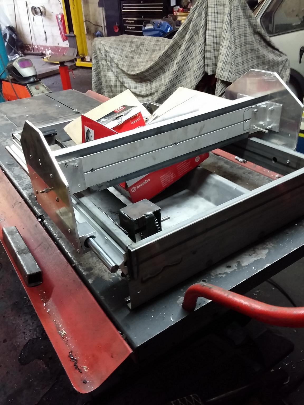

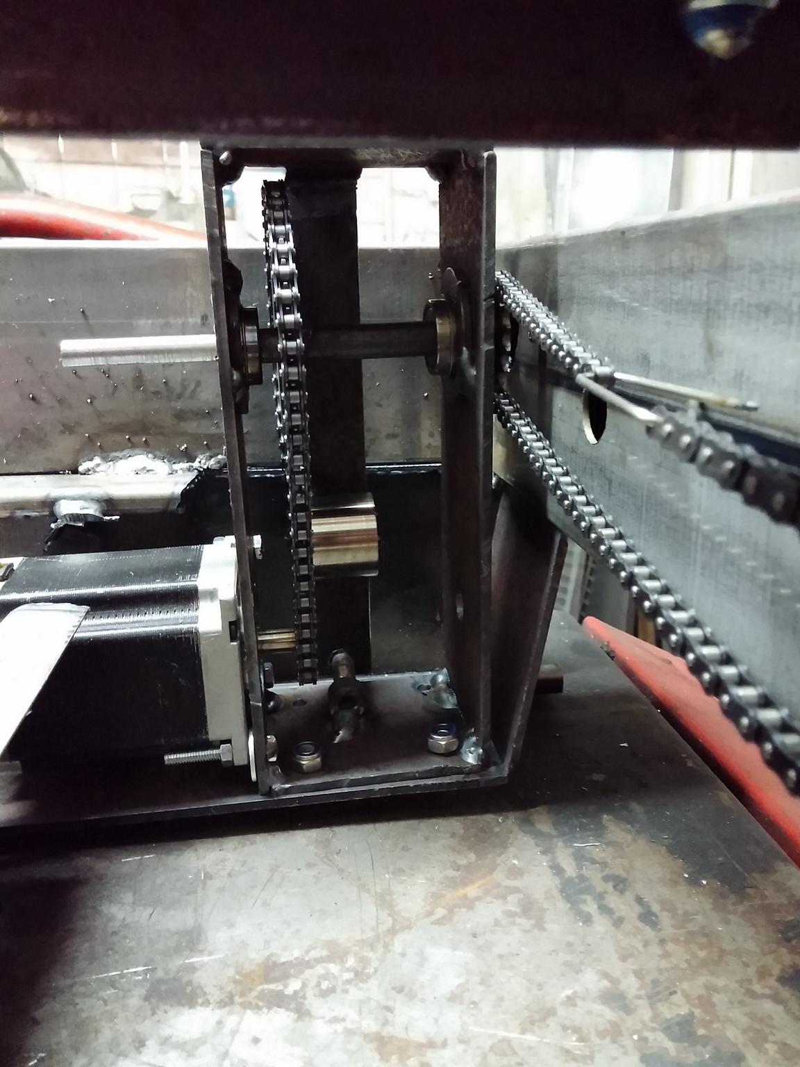

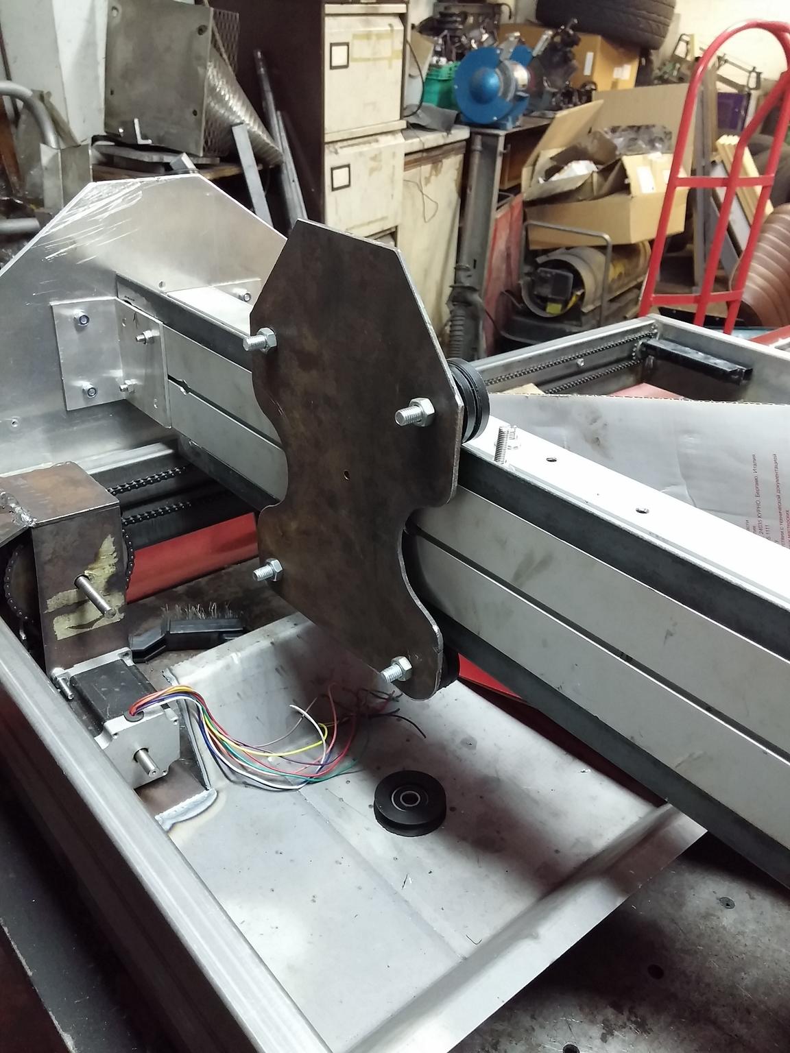

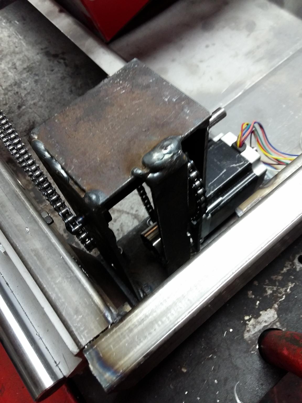

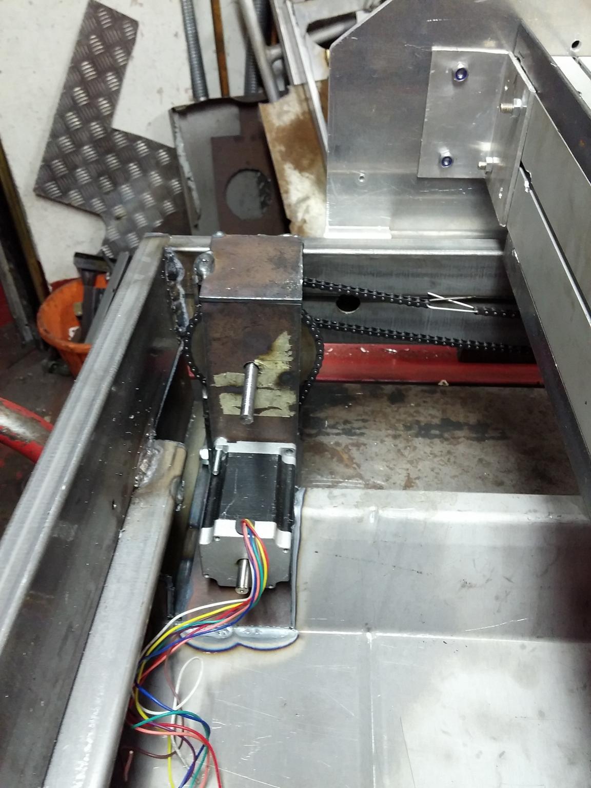

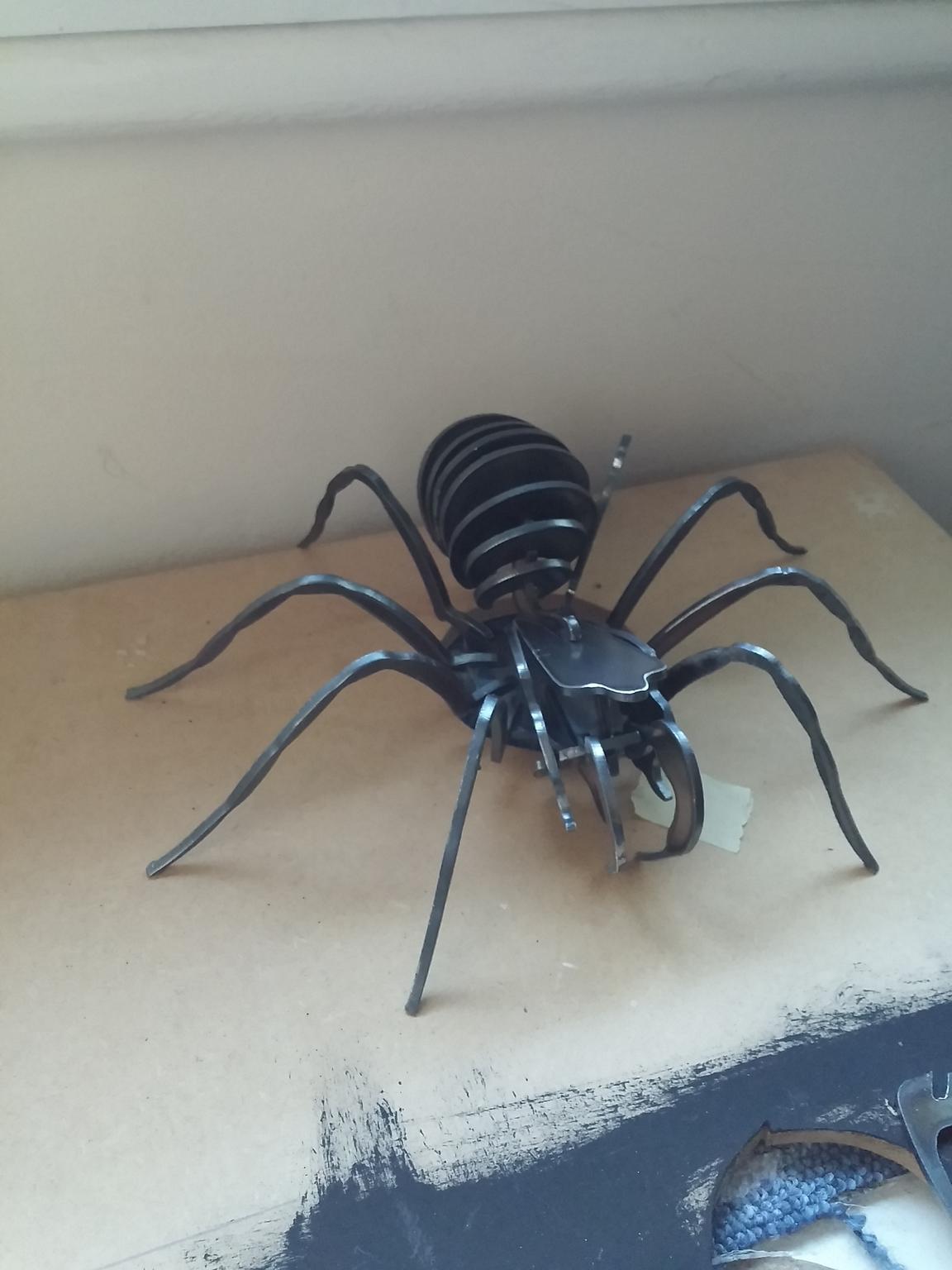

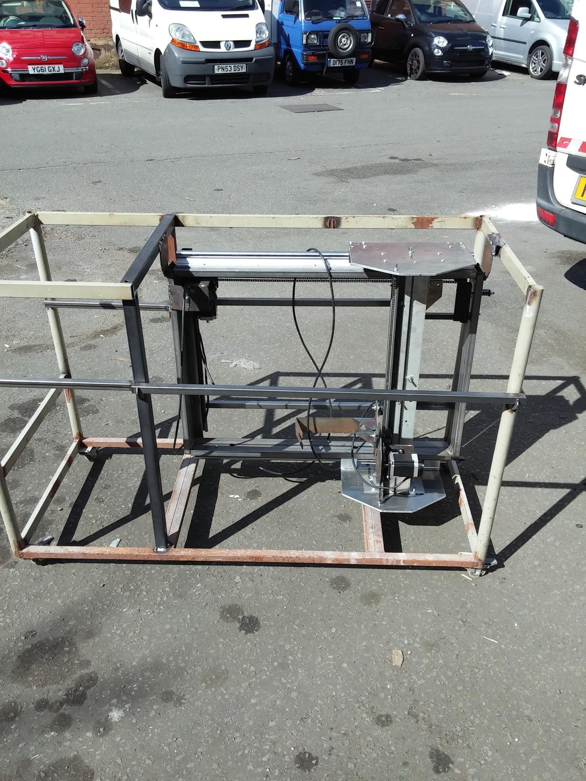

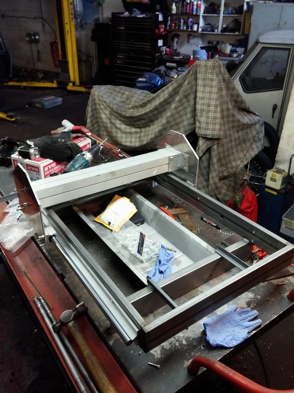

    Just a video and photos of the fold down plasma machine i made without any plans or designs it was just made up as i went along.
    No torch height control i just set it manually to 3mm

    i like your build as you go attitude! your a bit ahead of me in the build, youve already turned out some cool stuff..

    nice, love it. so small though!

    Thanks Ned it was small only 400mmx500 i think, it was my first cnc build with no plans just made it up as i went along lol worked well and sold it with plasma cutter for a grand so i was happy
