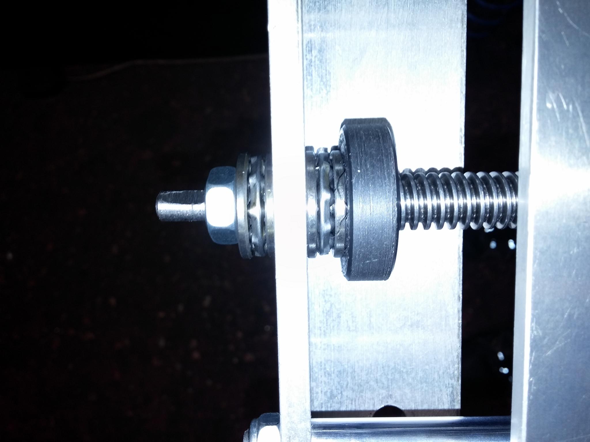

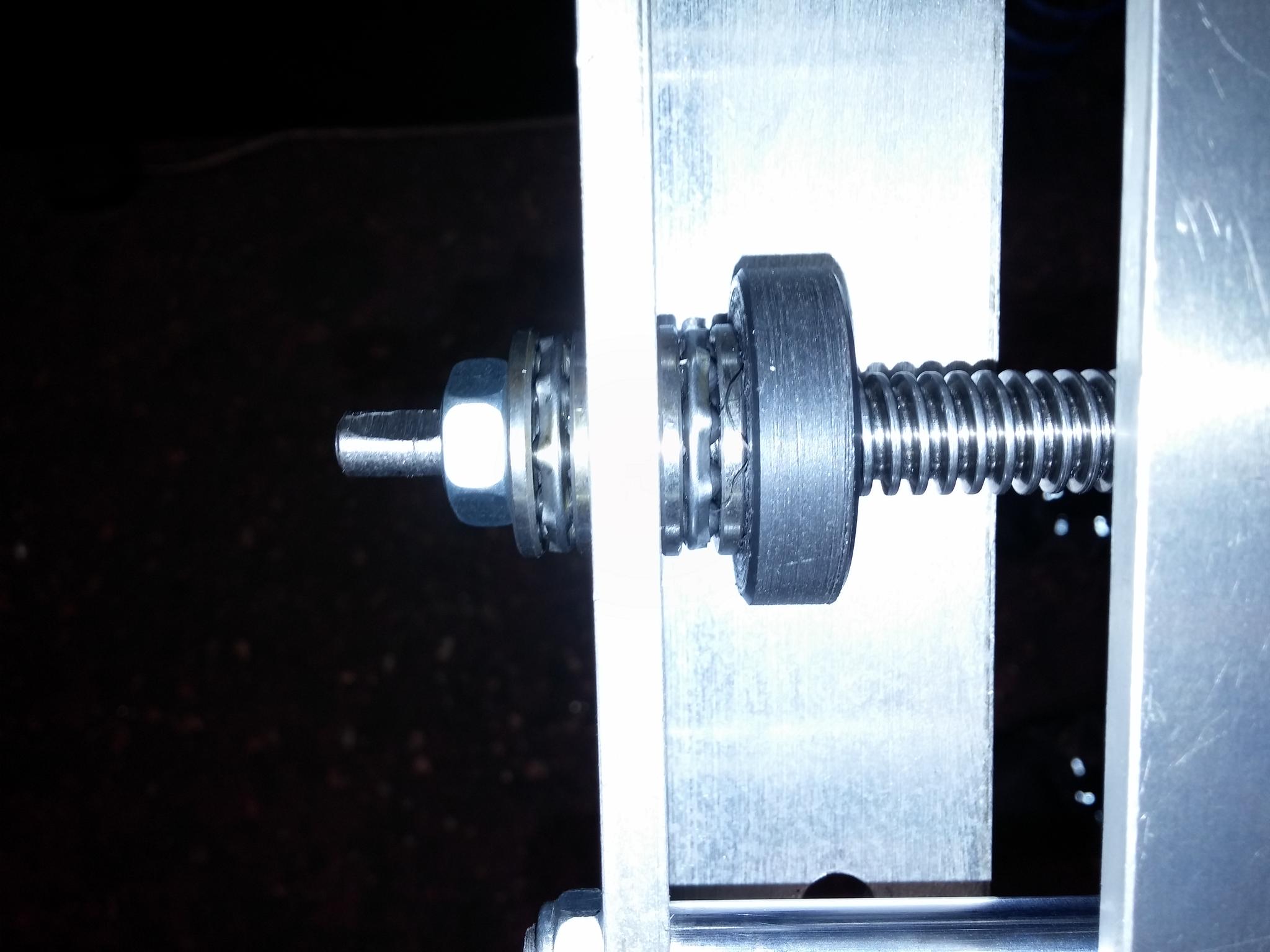

    Ok so maybe ill try this setup ? this is not the finished setup but you can get the idea.

    That's a just a set of 2 thrust bearings I assume? Which end are we talking there?

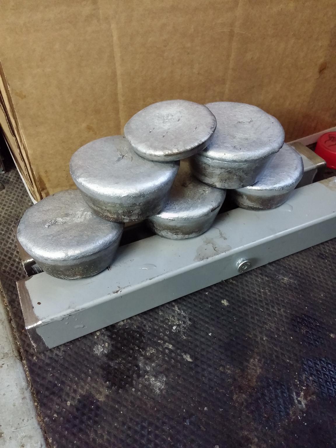

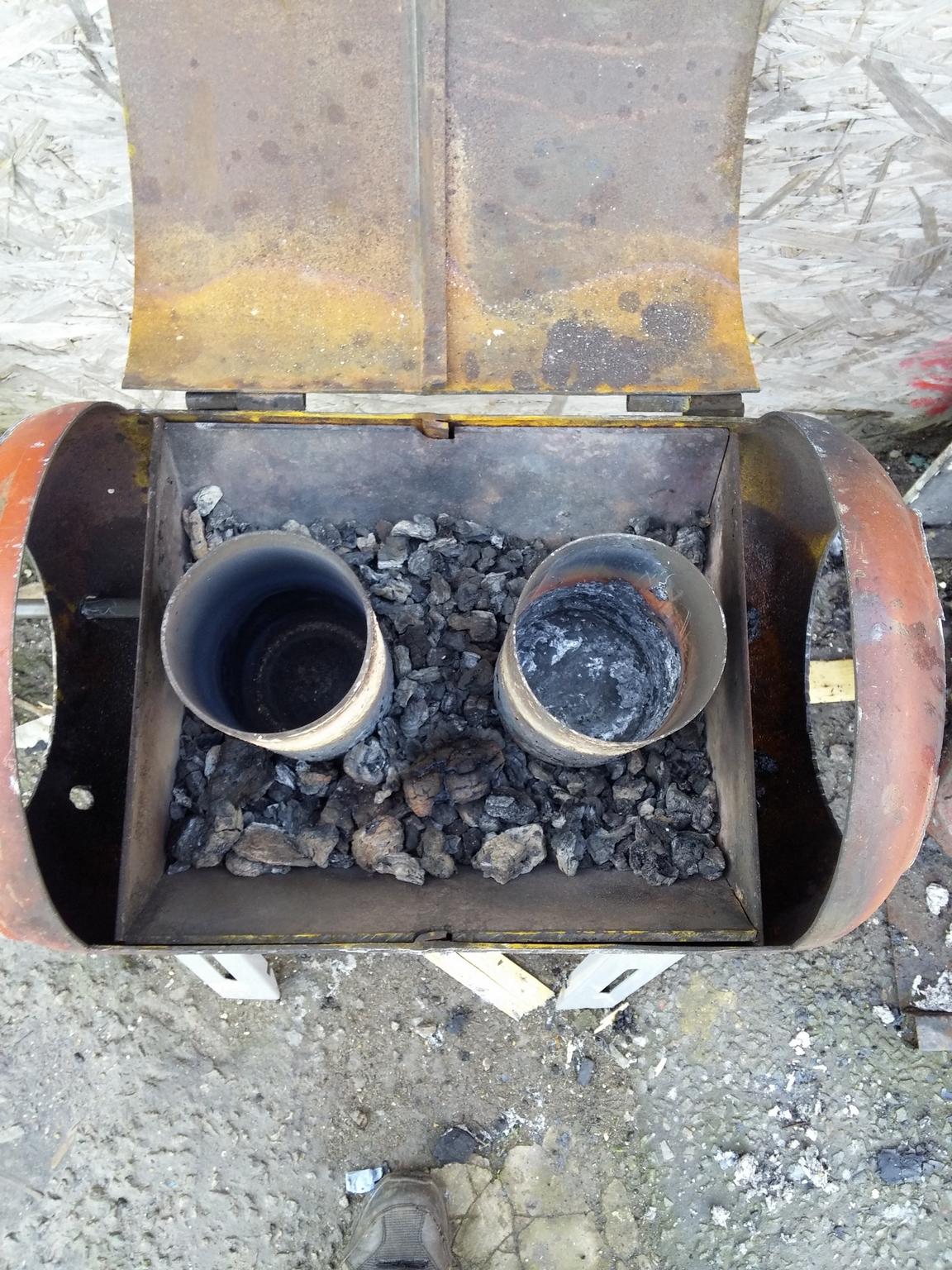

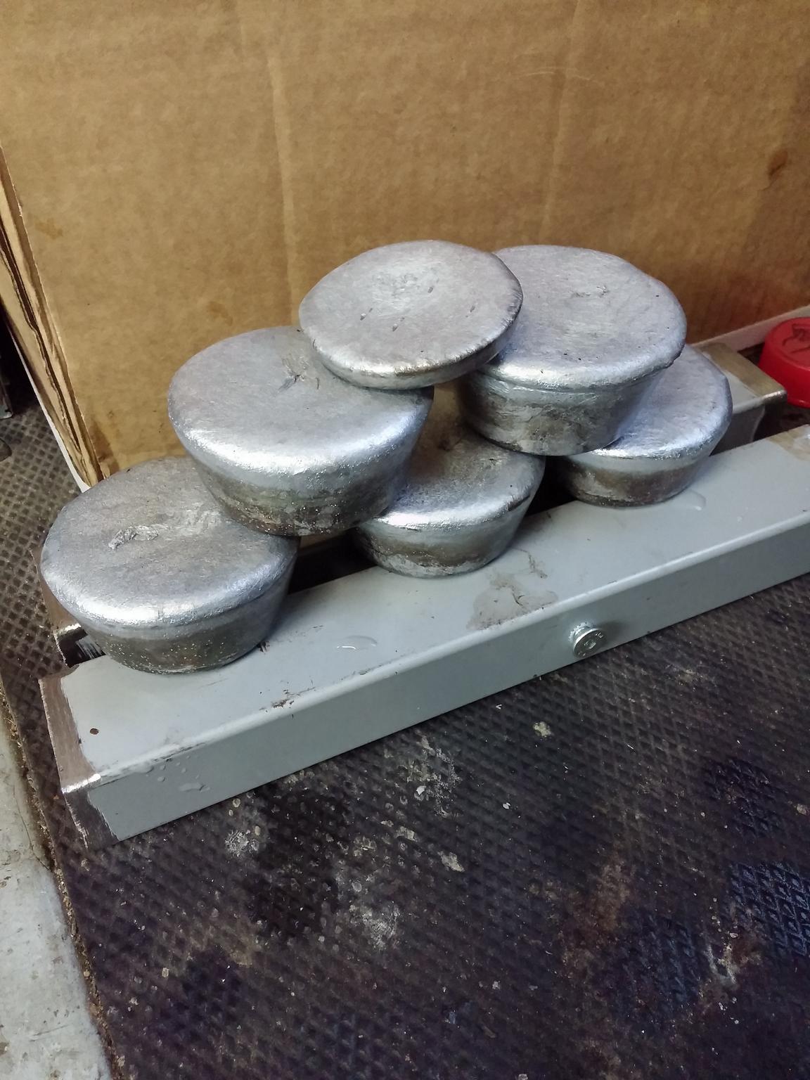

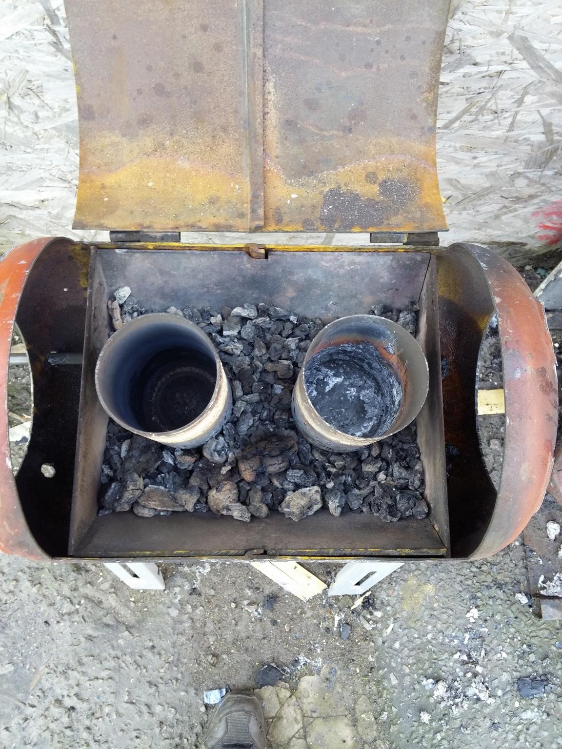

    In answer to your question I saw one on youtube and thought to myself I want to make one of those and so here i am, Since i cant seem to sell my rails and ball screw kit maybe one day i will have the space and time to turn it into a decent machine but for now this build and my aluminum melting barbecue i put together on Saturday i should have enough to keep me busy in my free time.

    My very first machine, made from bits I had laying around to see if I was serious about building a cnc machine, used something like that. A pair of thrust bearings either side of a plate to resist the axial loads. The stepper was then connected to the ballscrew using a very stiff and tight fitting piece of rubber tube to act as an alignment coupling. Something off a car engine cooling circuit ?
    The coupling worked fine for many months, but the thrust bearings became noisy and needed regular adjustment. I think this is because they were held there by a locking collar and did not apply a preload. Your picture has a preload nut so this will be better. By all means try it as it is much better than using the stepper bearings.

    Top end, i think ill put a radial bearing in the middle to keep the shaft centered plus some sort of aluminum cap on both thrust bearings so i can bolt everything to the plate.
