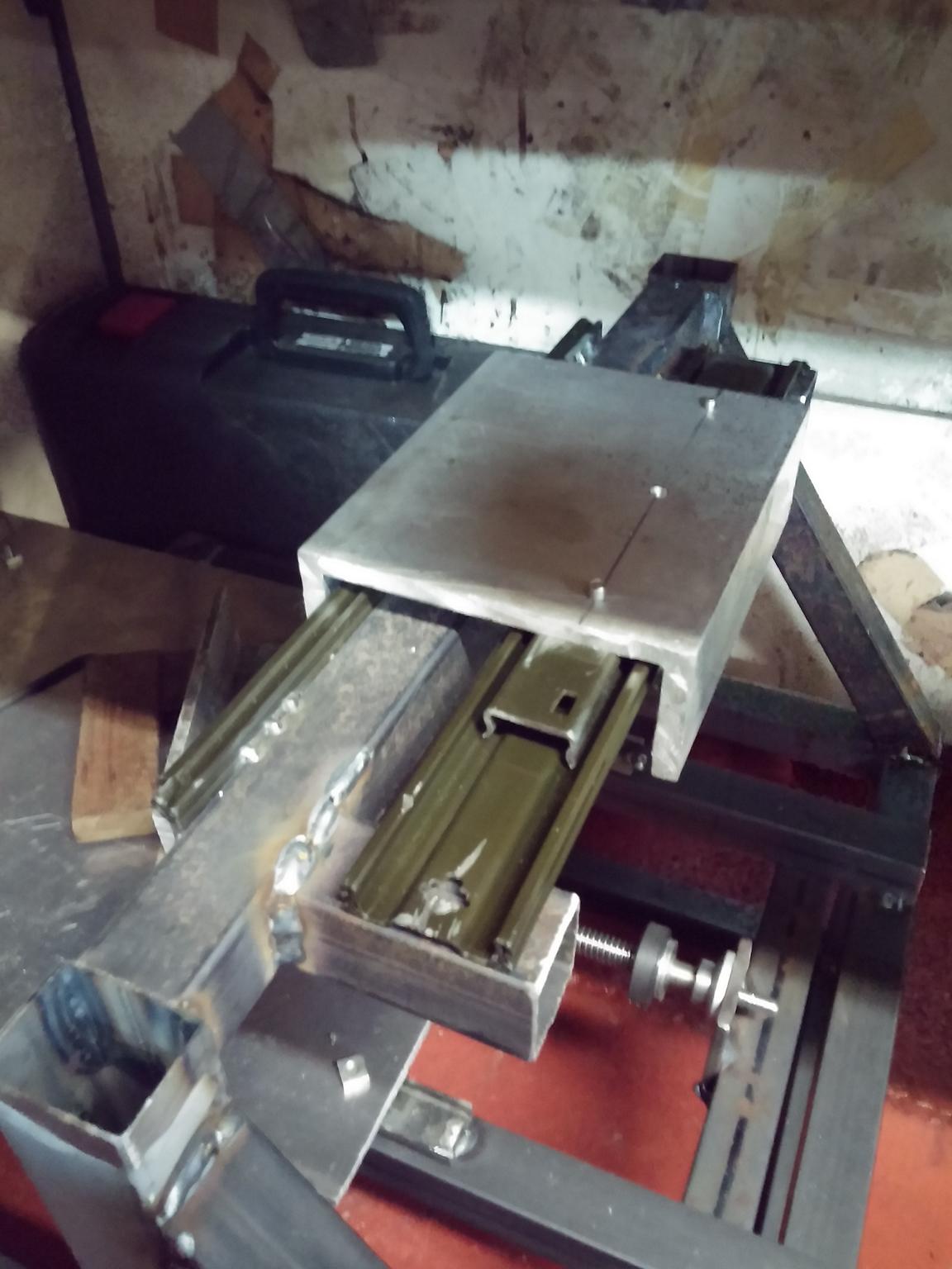

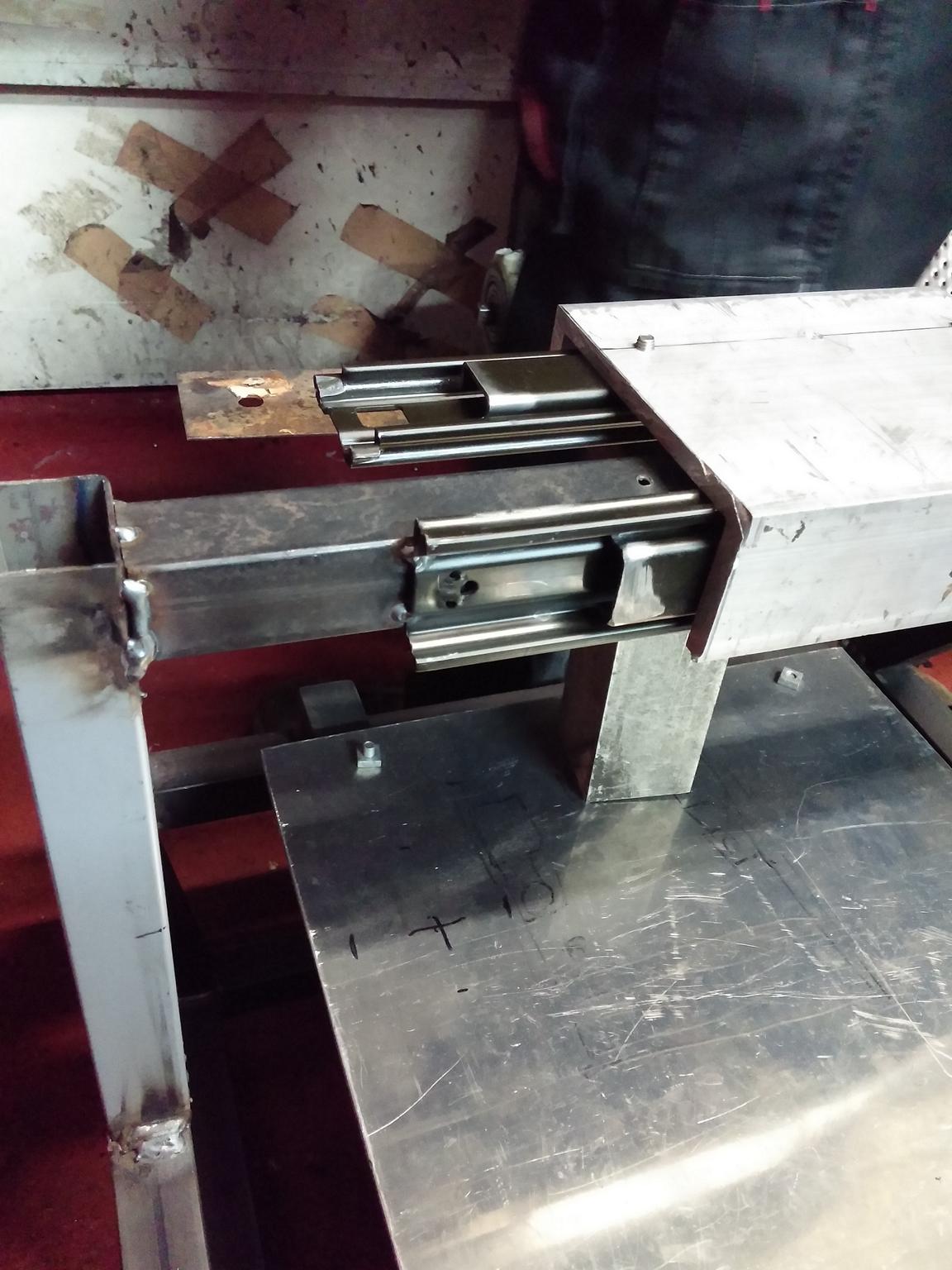

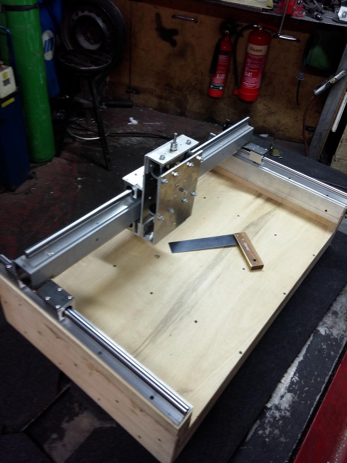

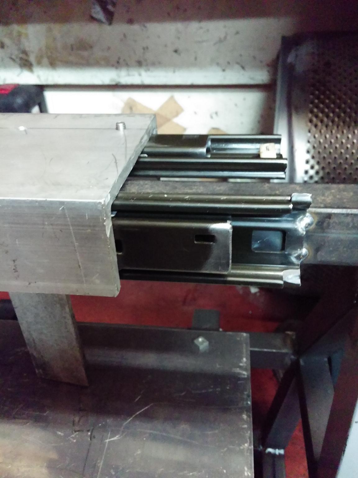

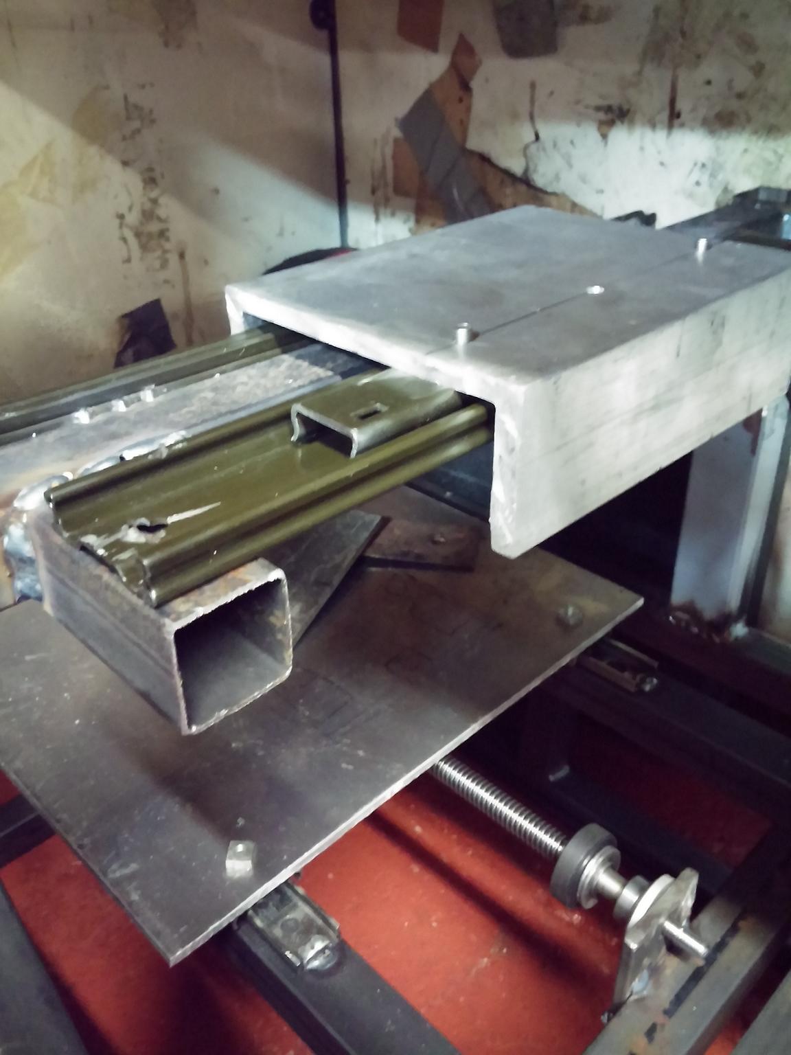

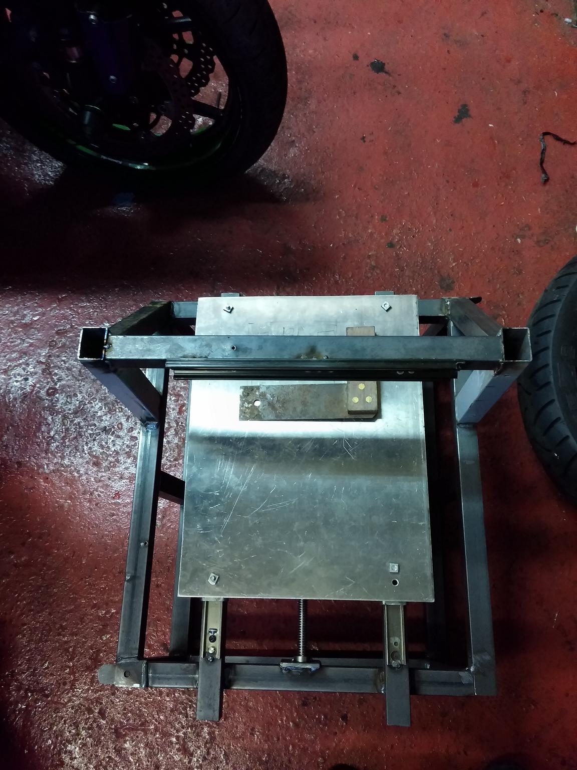

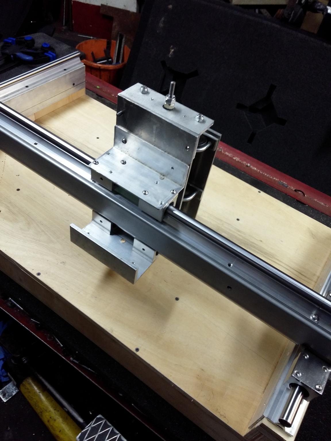

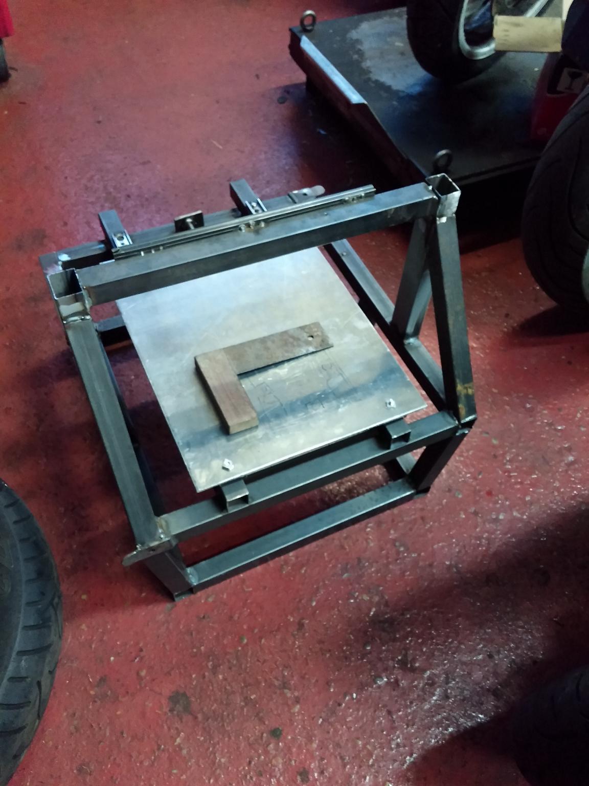

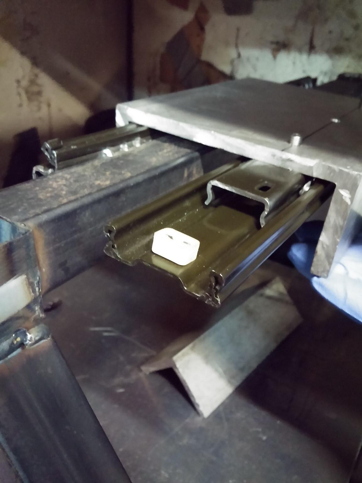

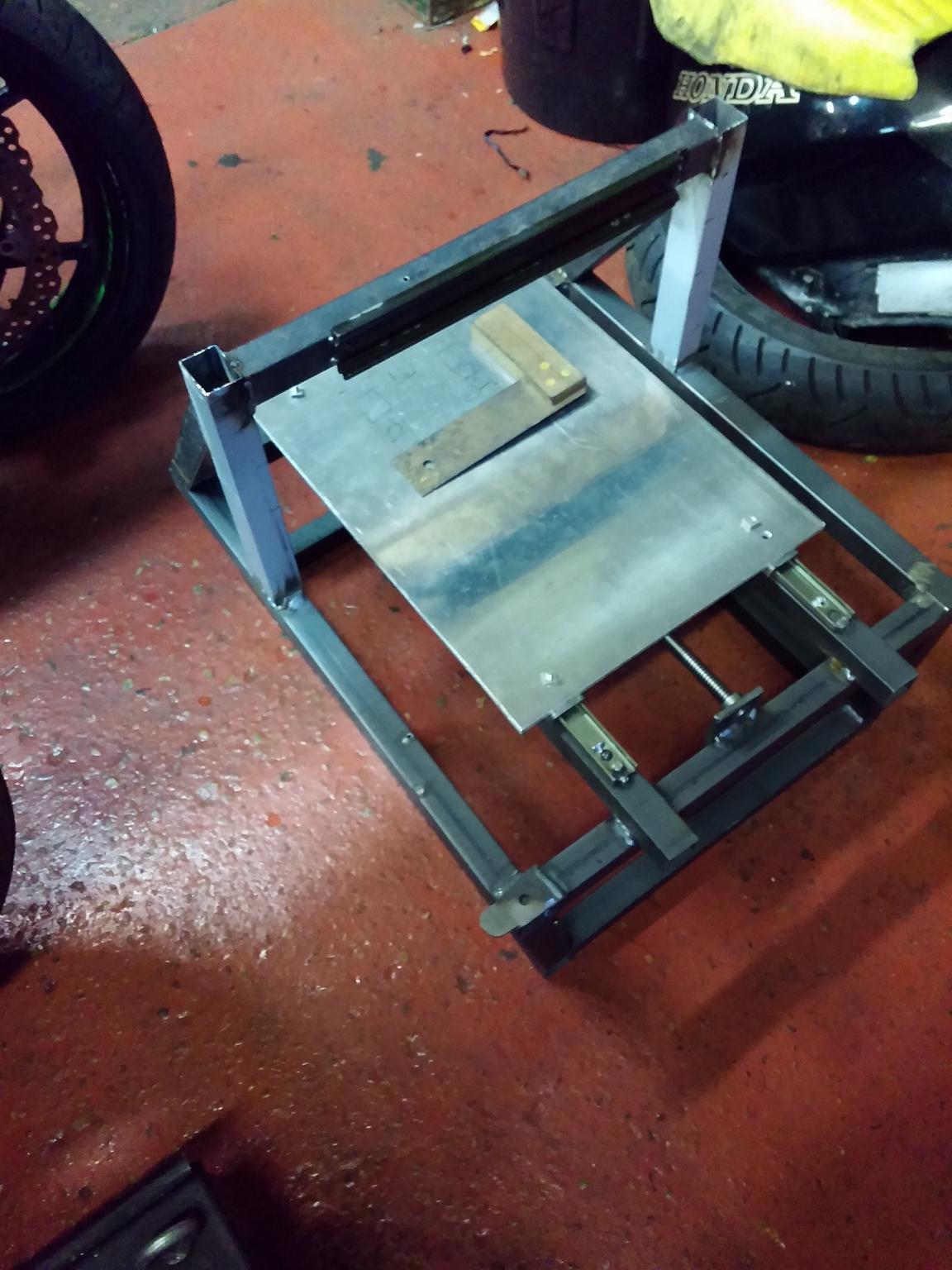

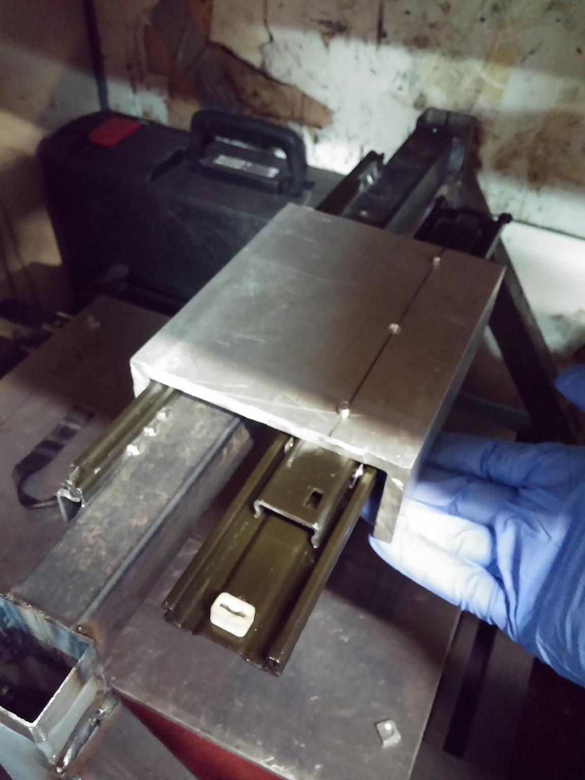

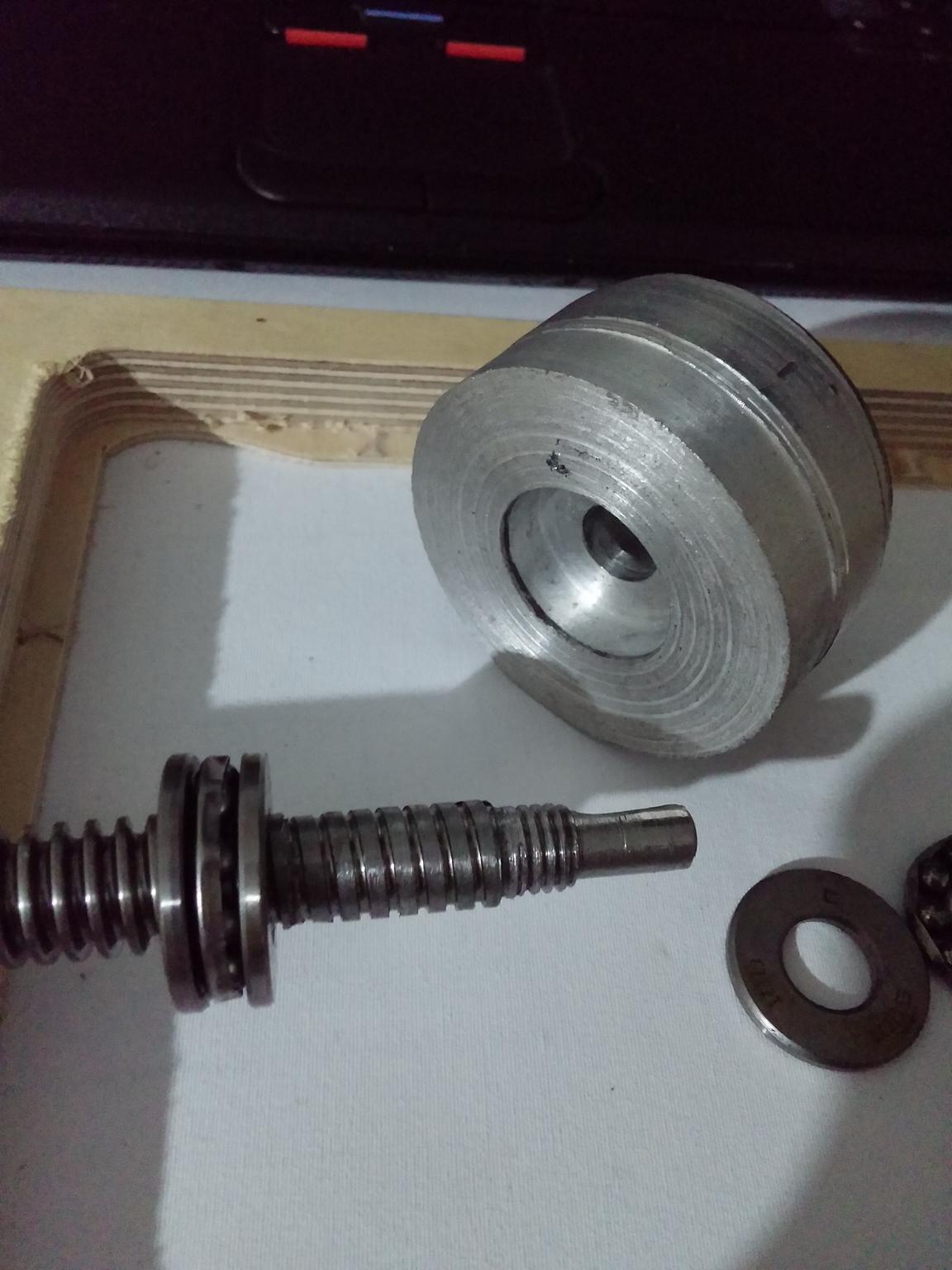

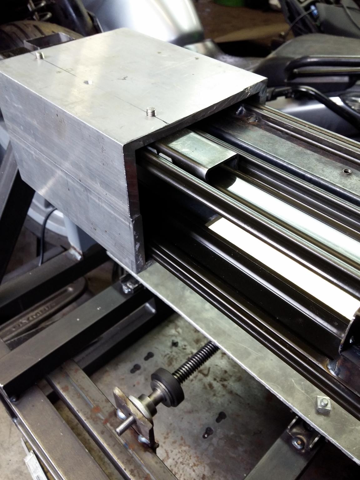

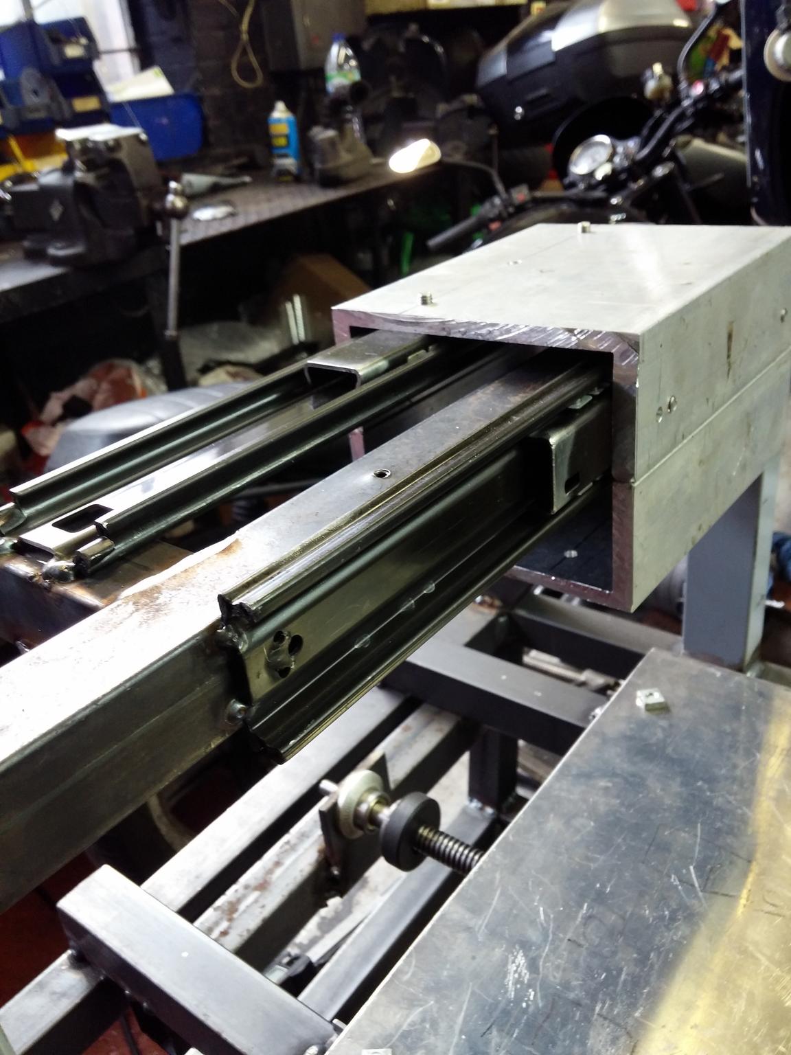

    I saw the lack of decent draw slide builds on you tube prompted me to make one better than whats currently on offer on you tube so here it is... unfinished of course !!!
    cutting area should be 260mm x 350mm once finished

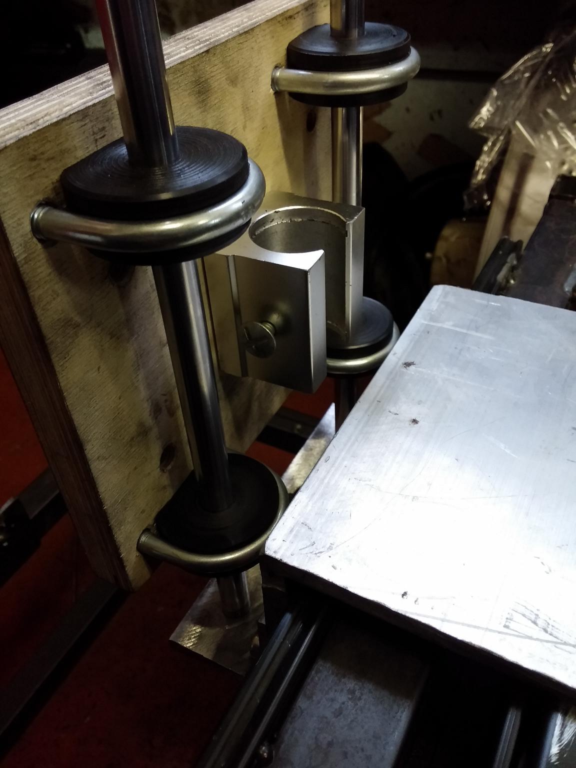

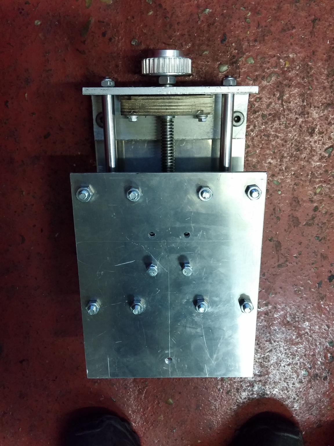

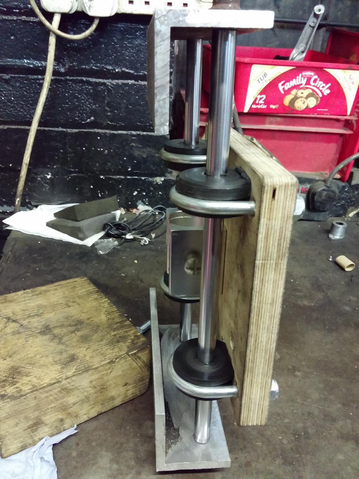

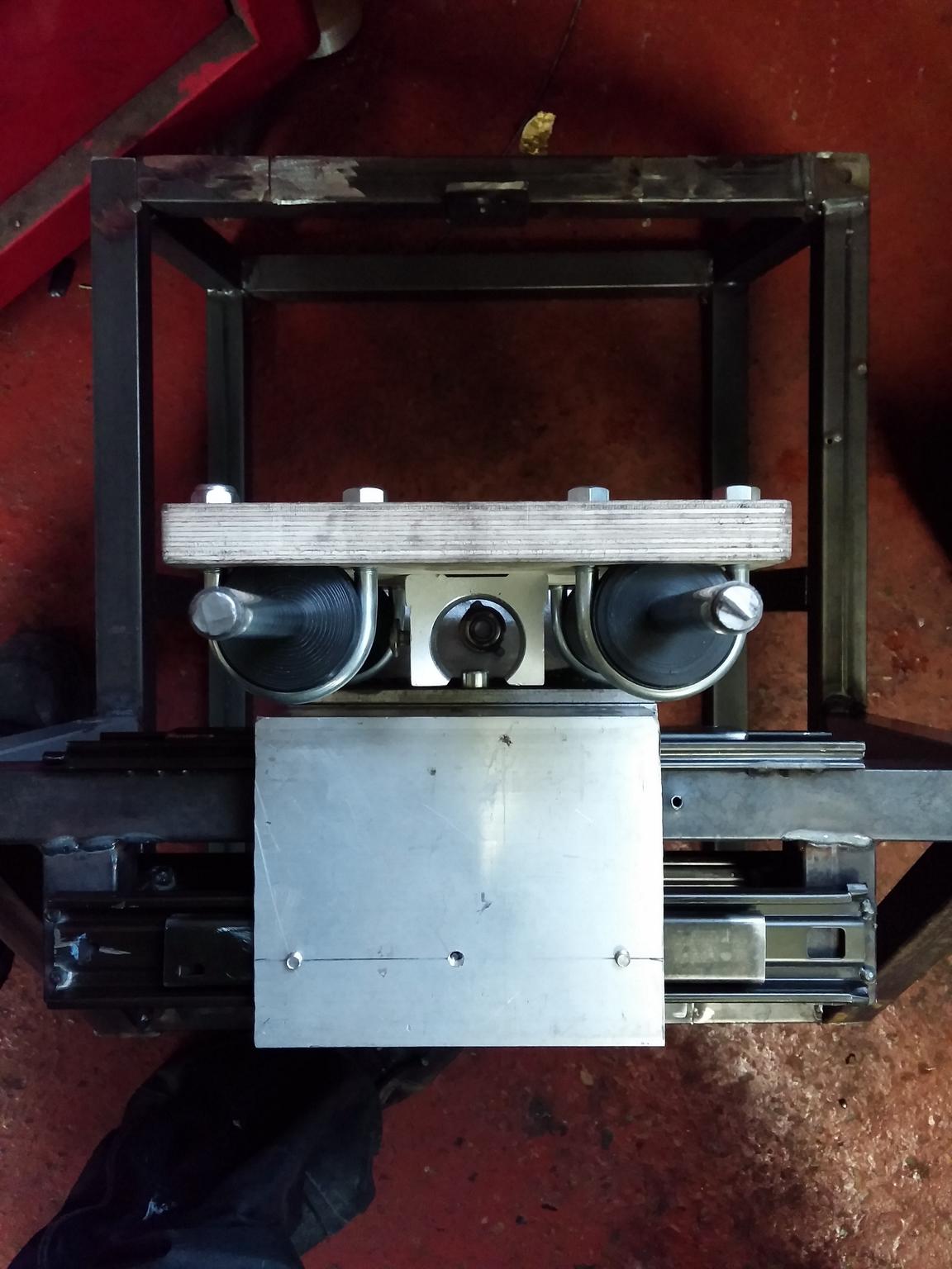

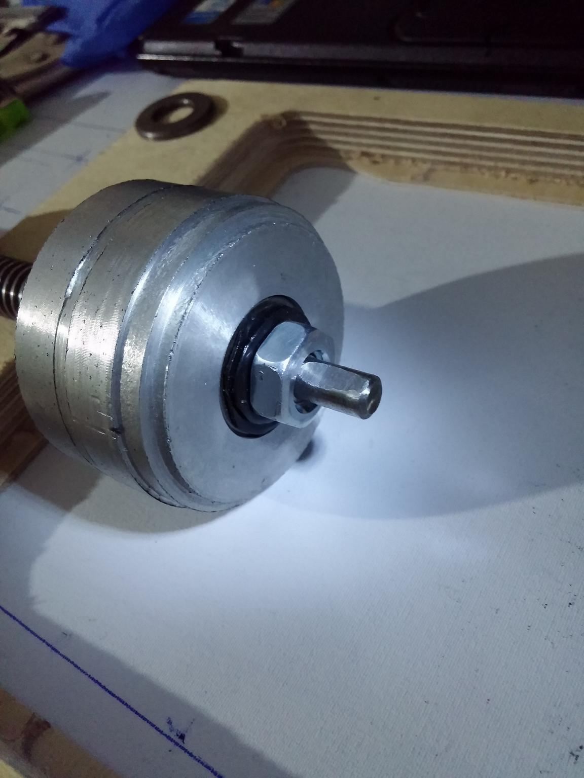

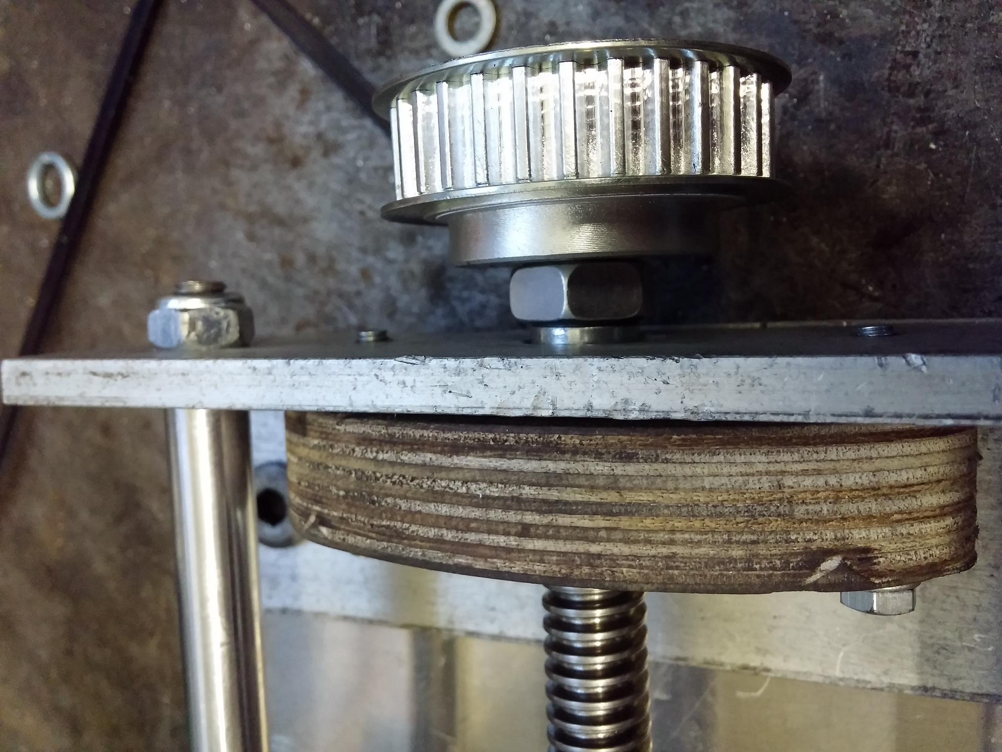

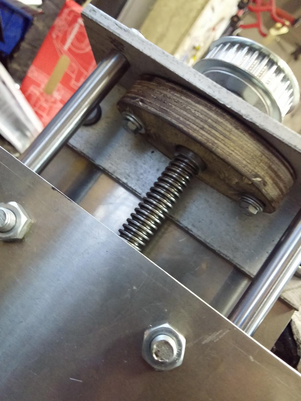

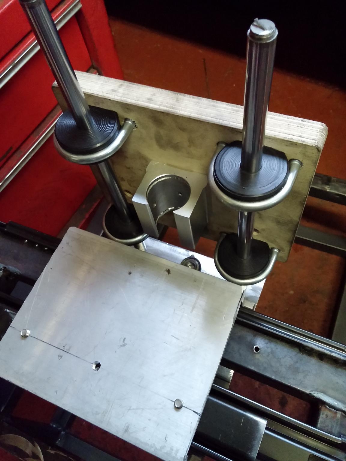

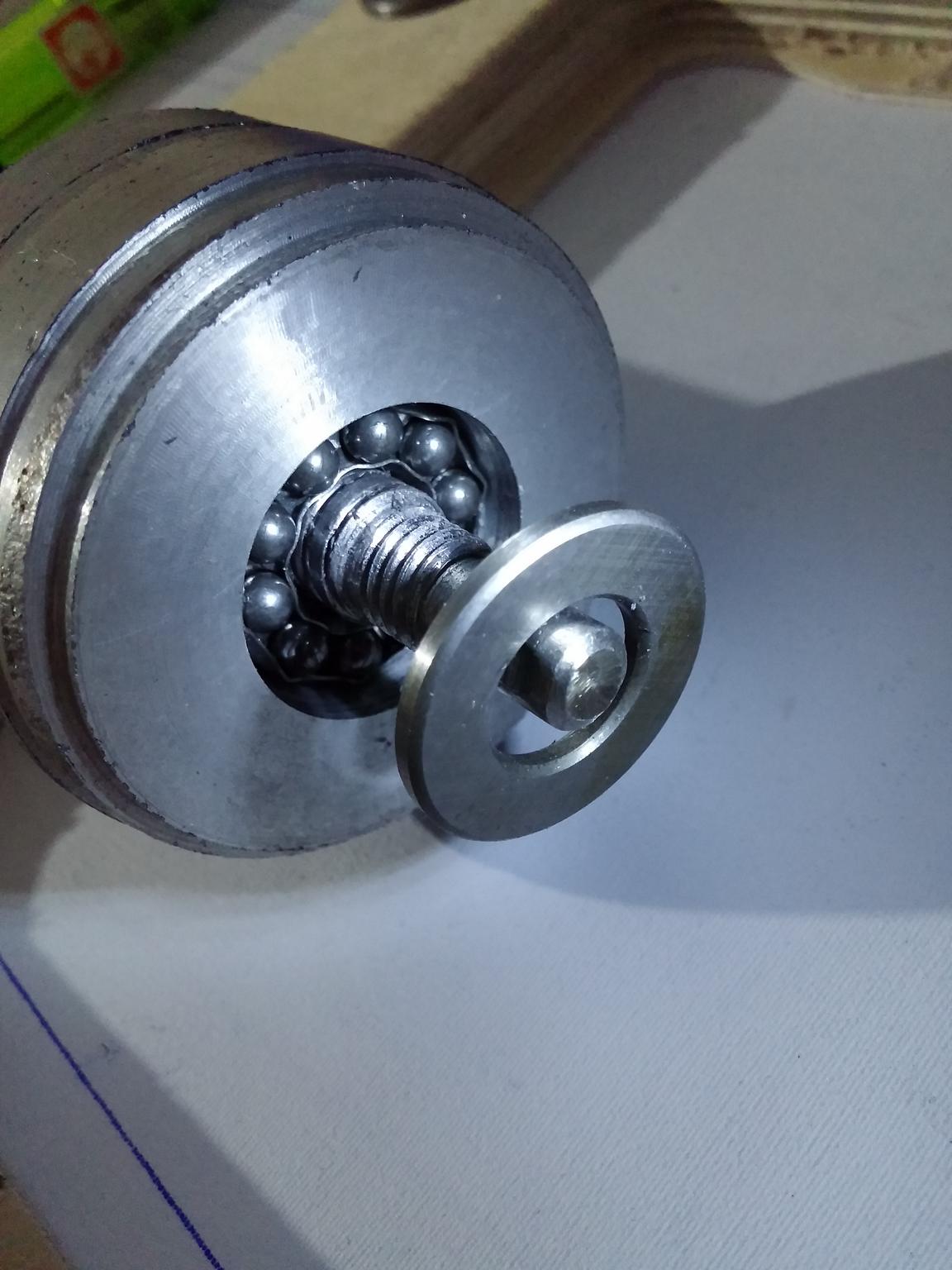

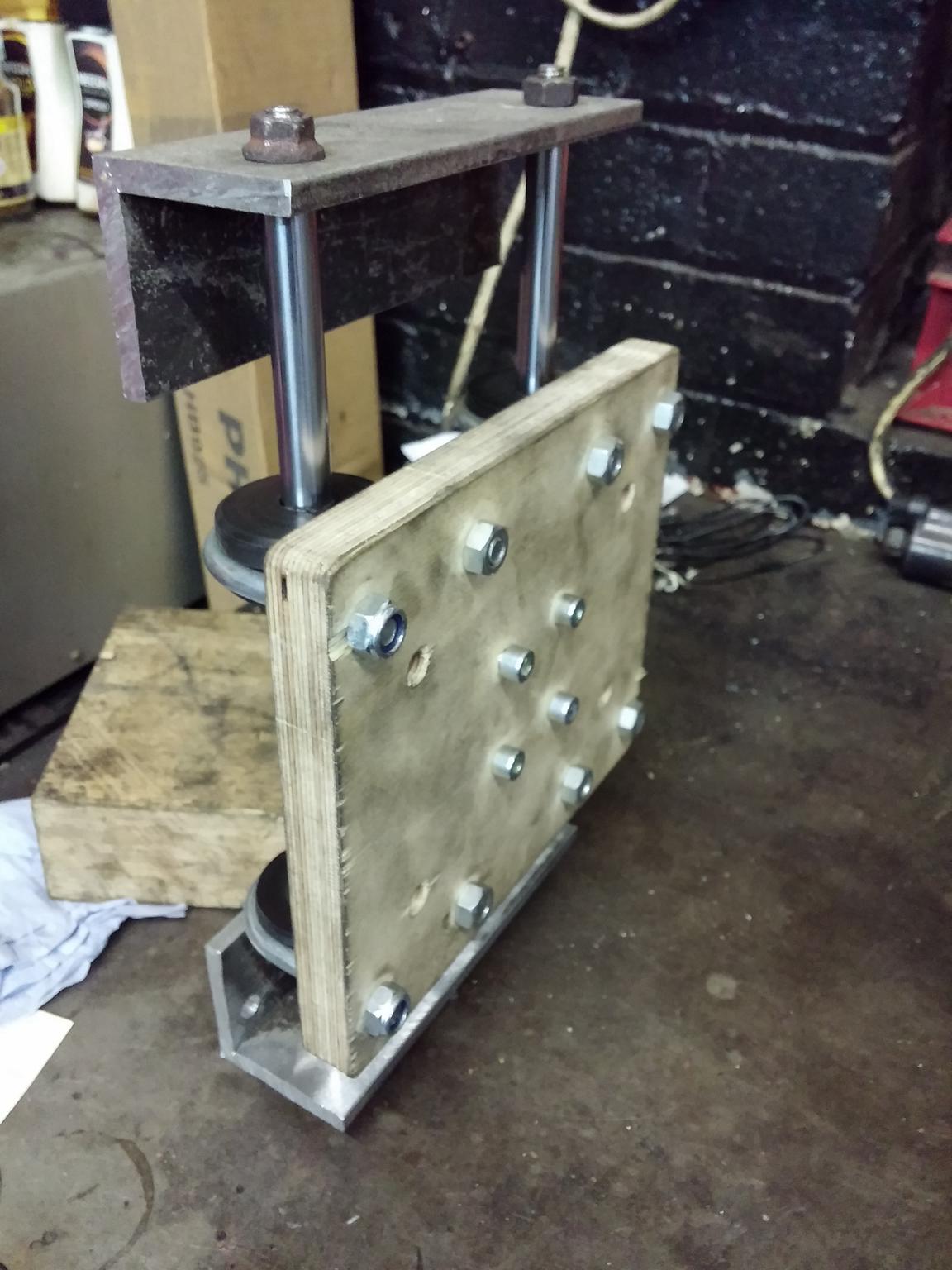

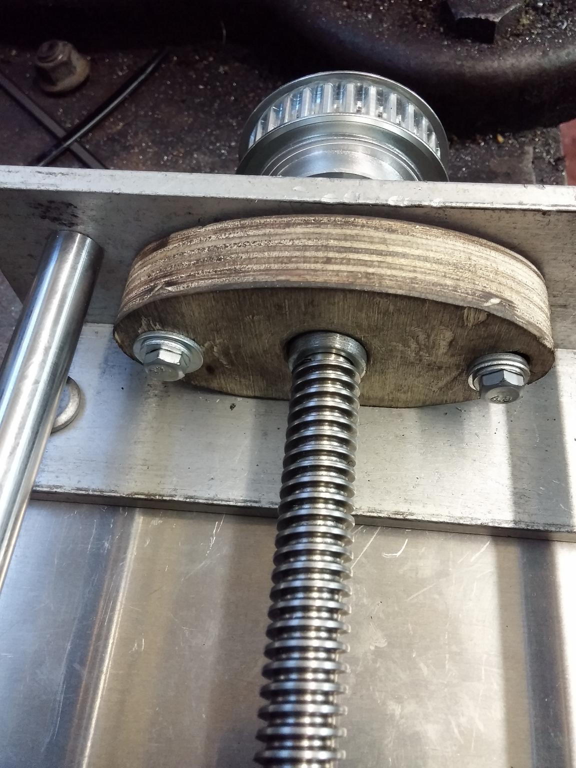

    Just a few photos of the z axis, shafts are 12 from some old rear shocks from a car, bushes are nylon diy held down with u bolts
    Just a few more photos of the z axis, i will fit the lead screw tomorrow if all goes well.
