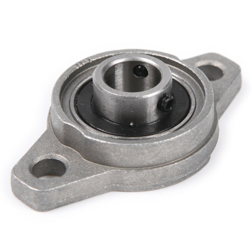

    Excellent! Even if not perfect, it will greatly reduce the strain on the steppers and your accuracy will be miles better than the originally planned solution would give you and is pretty similar to what I did in my first build.
    I used these 12mm pillow block bearings on X and Y:
    I had one on each end of the screw and they definitely worked well for me to make pretty small things very accurately until I decided to upgrade.

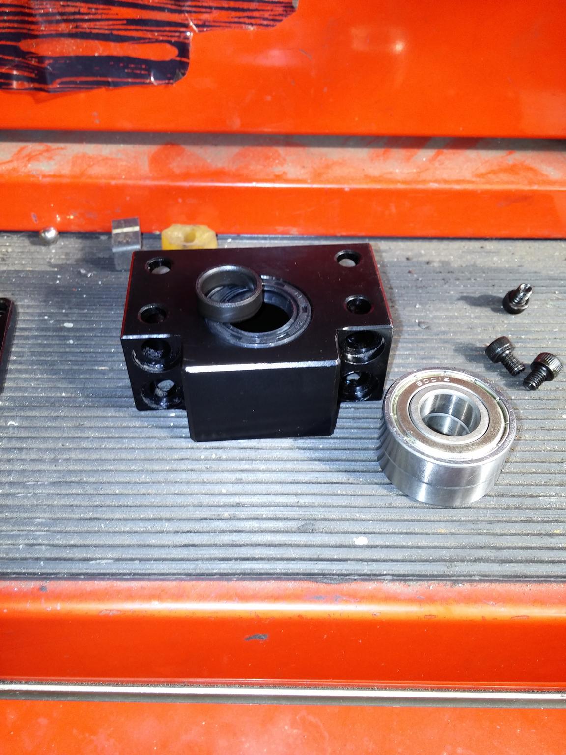

    Today had a hour free to make a quick holder to test the thrust bearings i have, made a few mistakes but im kinda on track, there was a radial bearing that fits in the holder between the two thrust bearings but the bearing i was going to use was only 8mm ID no good as the shaft has a 10mm thread on the end lol

  9. #49
    If you have fitted thrust bearings either end and a ball/deep groove bearing in the middle then that will work OK. If you only have the thrust bearings then your coupling (assuming you are using one between shaft and stepper) will not like the radial loads.
    The cost of the proper (e.g. BK12/FK12) parts is not too bad (~£22 for angular contact bearing block set at stepper end and floating bearing set at other end):
    https://www.aliexpress.com/store/pro...612.0.0.xrHjqj
    This price is if bought separately. If bought with the ballscrew and nut as a complete kit I think this would end up much cheaper.

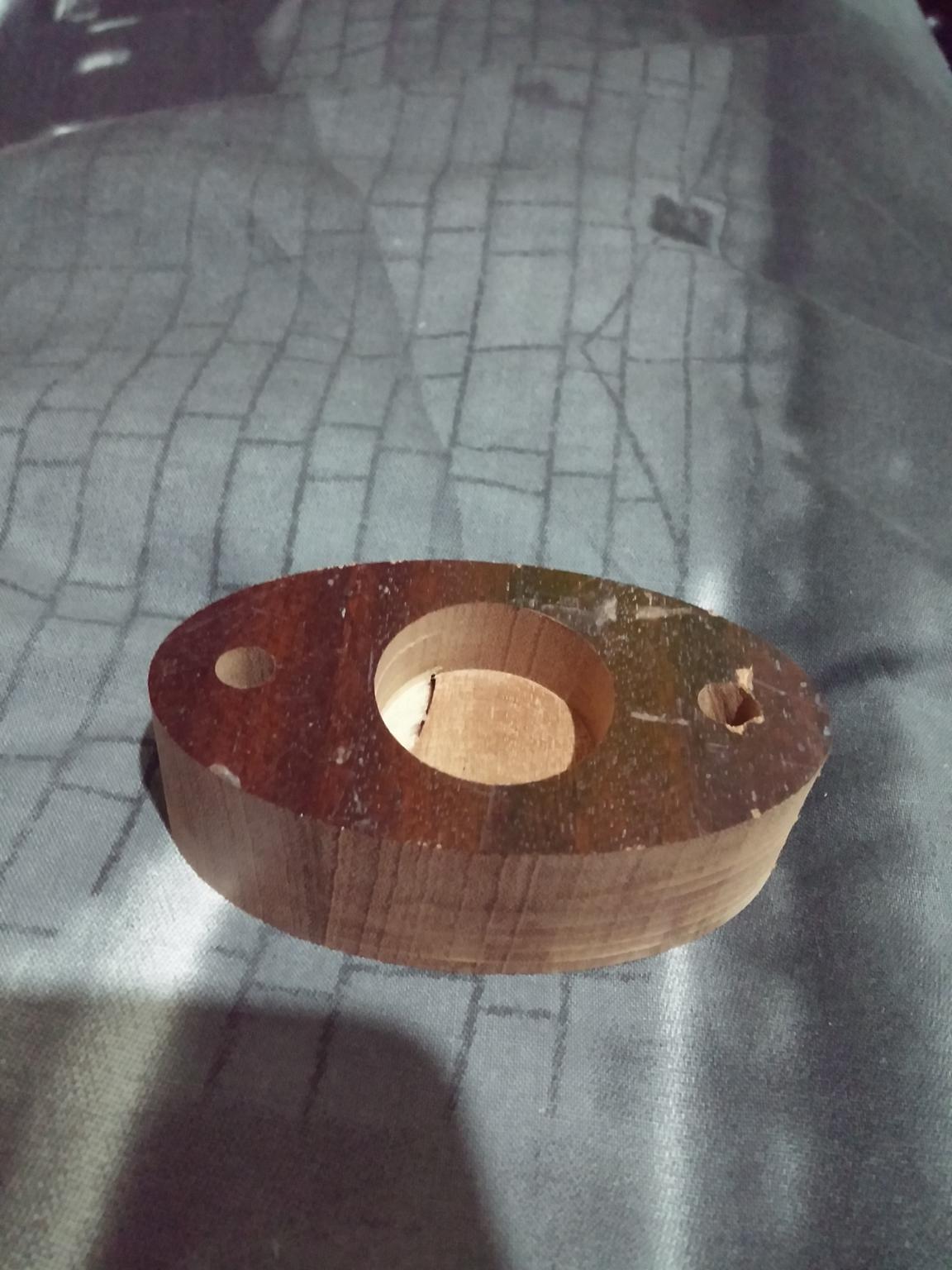

  10. #50
    I just found a 10x22x6 so yes thrust radial thrust
    No wait i brought a 10x30x14 double angular bearing so ill just use that, heres a bearing holder i made for that bearing.
