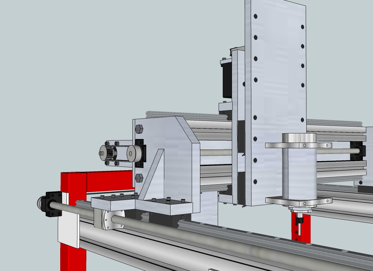

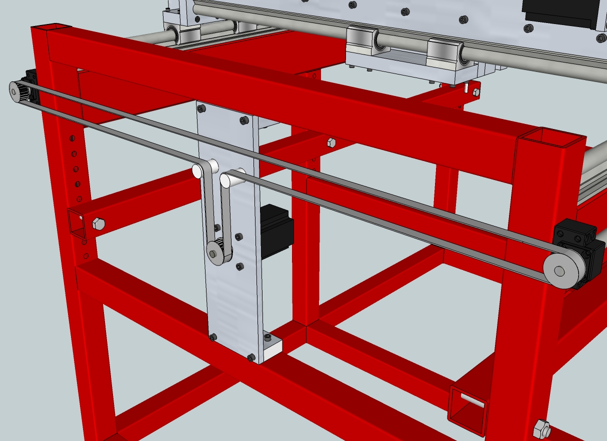

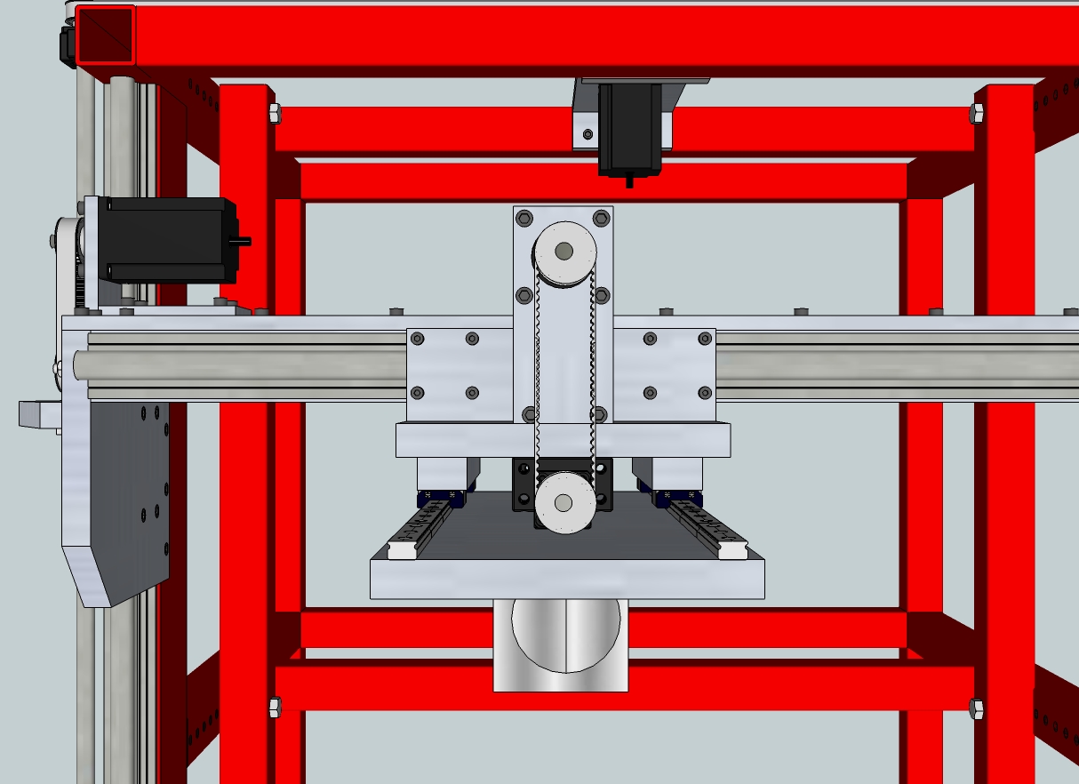

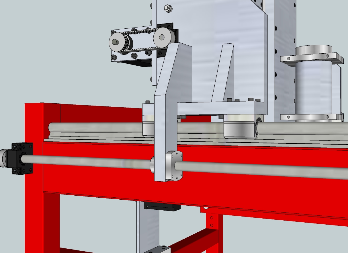

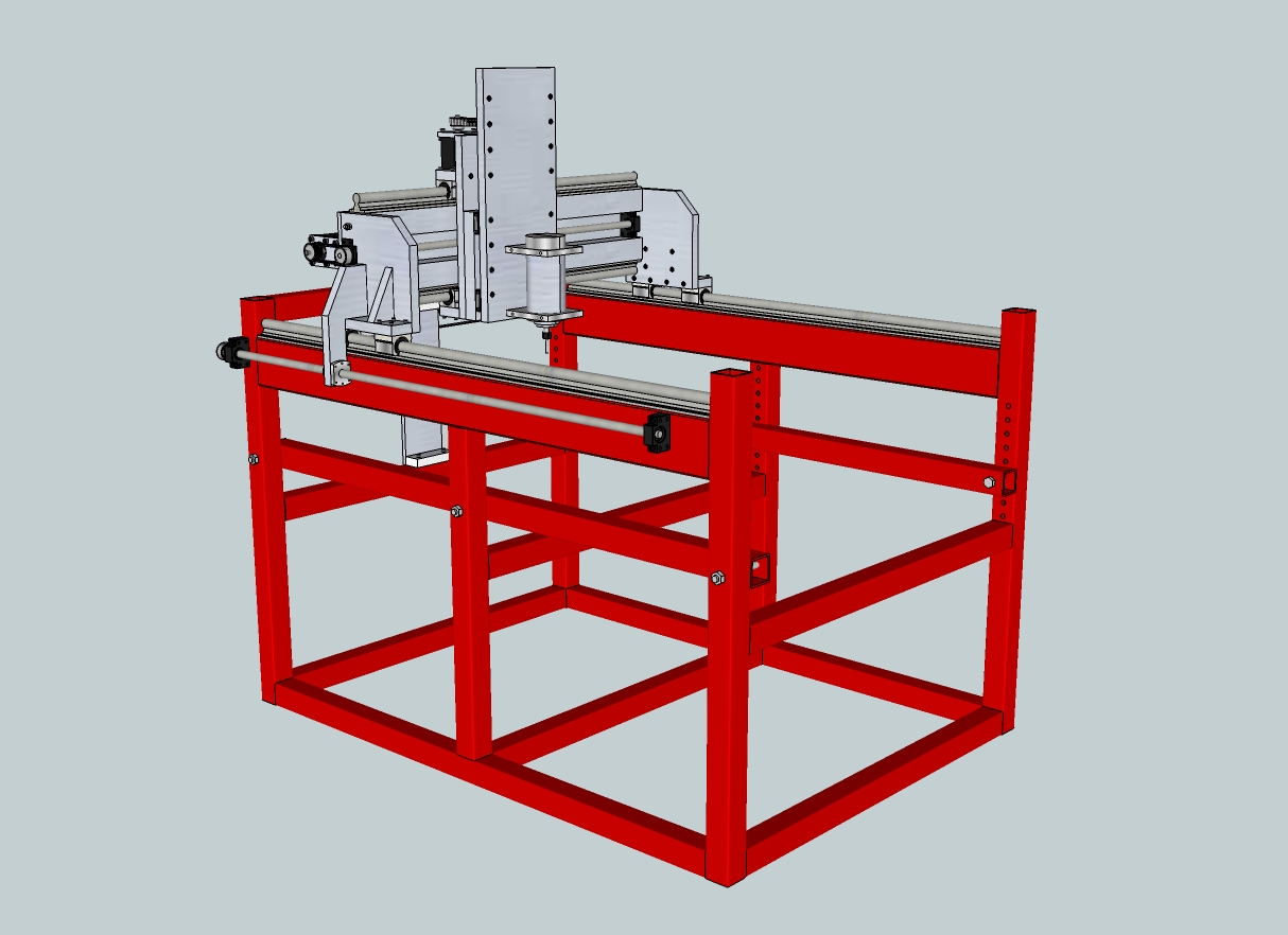

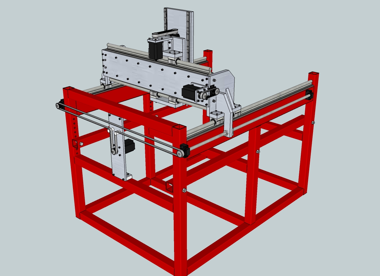

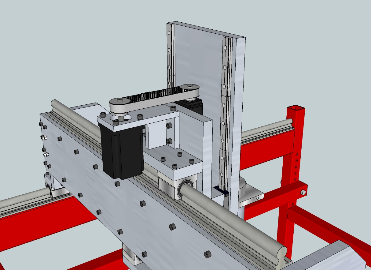

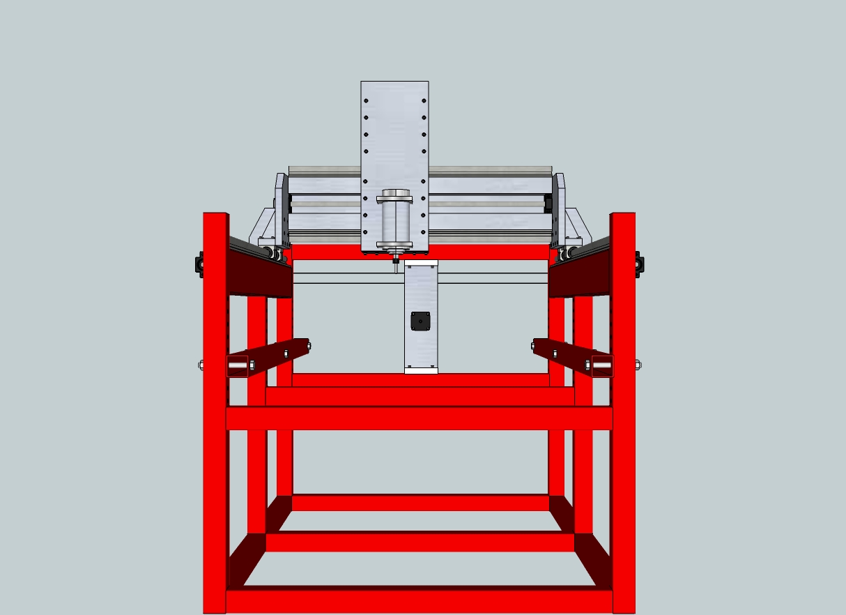

    Ok, as you can see I've been trawling all the build logs and tried to incorporate what I think would be best for my build.
    The gantry sides and whole z axis will be made from Ecocast 20mm x 200mm wide ali plate.
    The rear plate to the gantry will be 10mm thick which I hope will be sufficient.
    The Z axis will have rails on the front plate and slides in the back plate.
    All axis will be connected with screws using pulleys and currently at a 1:1 ratio just to get the machine moving.
    The frame, which is very similar to Jonathan's, will be made from 50mm steel box section and 50mm x 100mm for the top supporting rail. I'm planing for some adjustability so will be welding the whole bottom section but will use plates and bolts for the top RHS on to which the 20mm suported x axis rails will be resting on. I won't be using any welding on this top section to avoid warping. The actual cutting bed will be height adjustable too.
    A few questions I have will be described with illustrations.

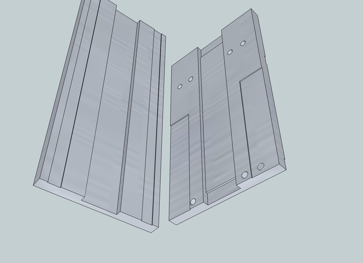

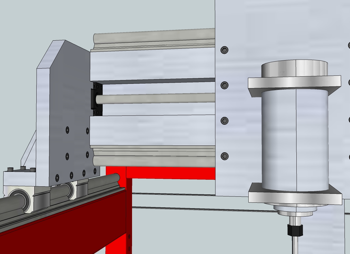

    The Z axis I have uses 15mm NSK profiled rails and slides. The problem here is that the total height from the bottom of the rail to the top of the slide is 16mm. The ballscrew mounts which is in between the 2 plates is 43mm thick, so I have to add 30mm of material in between the plates. I would like to know is it best to have this extra spacer added to the rails side, or the slides side. Both variations are shown in the top drawings.

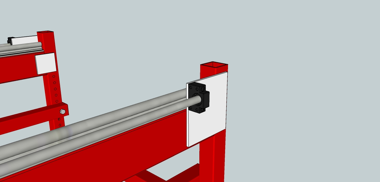

Name:	x axis ballscew mount.jpg

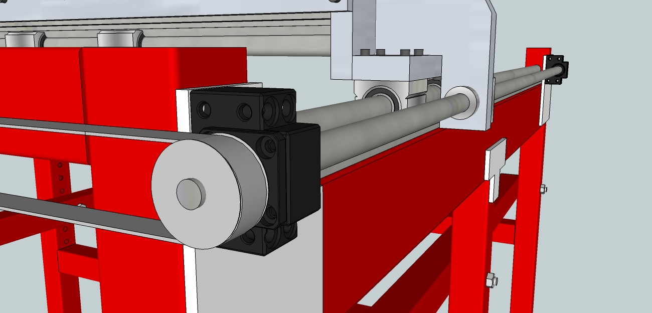

    This type of x axis ball nut mount looks the easiest and neatest from my side, but is it strong enough for pushing the whole gantry. It is made using 20mm plate and has 2 functions, as a nut mount and also to hole the gantry side square to the bearing plate.

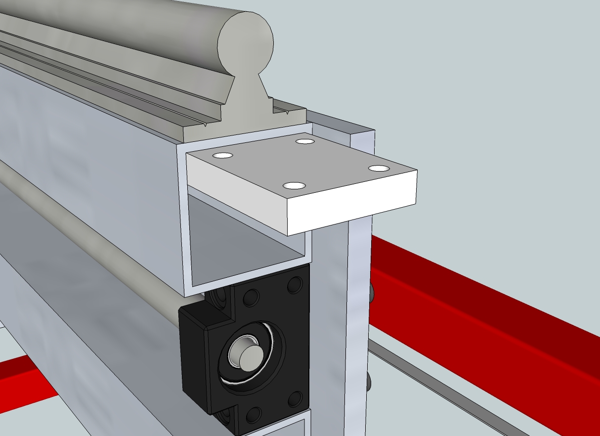

    I will be using 50mm ali boxing to support the y axis rails onto, but I'm unsure if the wall thickness is enough to drill, tap and hold screws from the top, and also from the back for the 10mm plate. This box section will be held onto the gantry side plates using registering blocks screwed onto the gantry sides and then a threaded rod right the way through the ali box section from gantry side to gantry side. As I've drawn above I could if its very necessary, make a strip of 10mm ali plate into a nut plate, if I can call it that. It will have holes drilled and tapped in the exact position to match the holes on the supported round rails. This way I could make the holes in the ali box section slightly larger and have some adjustability to get the rails aligned with each other.

    Wow, at last someone has bothered to read build logs and think about it before posting
    Quote Originally Posted by Iwant1 View Post
    What wall thickness? If you stick with 3mm, maybe 3.6mm, it's much easier to weld. Just for reference mine is mainly 60x60x3, 100x60x3.6 (x-rails) and a small amount of 50x50x3mm. If you add some pieces in the corners of the frame at 45° it will significantly increase the rigidity of the frame. I never got round to adding them on mine, although they are on the original drawing. It's the sort of thing you can add when the rest is welded to use up any left over box section.
    With regards to the Z-axis rail mounting - neither of those methods is ideal. If you had to pick one I'd put the rails on blocks as that would help stop the Z-axis plate bending, but they would have to be machined accurately - not just any old flat bar. However I'd consider that a last resort since it is important, particularly withnot having profile rails on Y, to get the cutter as close to the Y-axis bearings, when measured parallel to X (the 'overhang'), as you can. Since the Y-axis bearing blocks have a finite stiffness, when a force is applied to the cutter parallel to Y the tool will deflect and this deflection will be proportional to the aforementioned distance, therefore you should minimise it as it will directly increase rigidity.
    As you're using standard BK/BF bearing blocks this presents a problem, since clearly they will collide with the Z-axis plate if the spacing is reduced. Options:
    1) Make cutouts in both of the 20mm plates which the bearing and ballnut blocks 'sink' into, to effectively reduce their centre height.
    2) Use a longer ballscrew and mount it to the Z-axis plate (like on mine), that way the bearing blocks wont be over the other plate. Still need cutout for ballnut.
    3) Make lower profile bearing/ballnut mounts, then less deep cutouts are required.
    Problem is all of these options are easiest with a milling machine, or require outsourcing but to me it would definitely be worth it.
    The ballnut mount looks weak to me since it's so long. The easiest solution is to move the ballscrews up, but no doubt you didn't do that because the ballscrews aren't long enough to mount at the most convenient point. You could make the ballnut mount stronger, but even then there's quite a distance (measured vertically) between the X-ballnut and rail, which for the same reason as for Y/Z it's best to minimise. I would be inclined to raise the ballscrew so it is in line with the X-axis rails and add an aluminium plate to support the non driven end, preferably linking on to the far vertical support. The strength of the non-driven end bearing mount isn't critical as it's (roughly) only there to stop the screw whipping, so there's not much force on it.
    I bolted my Y-axis rails to 80x80x3mm aluminium box section. The bolts are strong enough, but in my case the box section is a weak point as there is only one. You can get the necessary adjustment on the rails for them to run smoothly by drilling the holes in the rails slightly bigger to give the bolts a bit of clearance. It would be nice to use a greater wall thickness just from a strength point of view.
    Thanks for the suggestions Jonathan. I've redrawn the x axis screw so it is as close to the supported rail as possible. This has bought the ball nut mount up by 60cm.

    Regards the z axis. I had no idea I had to consider the height of profiled slides when I bought them of eBay. Lesson learnt, and if as you say I machine about 10mm grove out of both z axis plates, I still need 10mm. Say I grove out 10mm from the front plate, then sink the ball nut even more, up to a point where the screw shaft just clears the front plate, then I might just get away with that last ten. I'll draw this later to see if it is feasible.
    I would definitely consider outsourcing to one of you guys to machine these plates as it will make a much sleeker z axis and also bring the spindle cutting point to within the x axis bearing blocks.
    You should consider incorporating adjustment of one of the X-axis ballnut mounts to gain better alignment of the ballscrew. Currently you're relying on the accuracy of the frame, rail position and all sorts for the distance between the rail and the ballscrew to remain constant. In reality the tolerances on all these build up, so it's easiest to make sure at least one of the bearing mounts (clearly the non-driven end is easiest) position is adjustable in the Y-Z plane to ensure you can align it accurately. If not you risk the mechanism binding towards each end which will put a large force on the ballscrew/nut...
    On my Z-axis I currently have 520mm long 20mm NSK rails, so the additional height of those helped. If you go up to 25mm plate for one of the plates on the Z-axis that might help to get the required pocket depth without sacrificing strength. Using that strategy I recently made a Z-axis using 25mm profile rails with only 2mm clearance between the plates. Also if you get the Z-axis parts machined there's not really any need to use the more expensive tooling plate - I would mill the surfaces for the rails and blocks to get them flat and in the same plane.
    I was just thinking about that adjustment last night. I was going to slide the gantry to the driven end of the x axis, locate the ball screw bearing block there, then slide the gantry to the non driven end and get the position for that screw bearing block. Suppose great minds think alike lol.

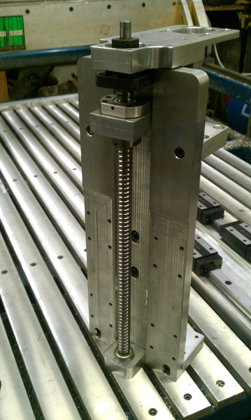

    Great advice about getting 25mm plate. Does that mean it would be safe to remove 15mm of material? If I don't need EcoCast then what would be suitable 6082 plate, 5083 plate or 6082 flat bar. Also how accurate does the 10mm plate that goes behind the gantry have to be? sorry for so many questions.
    I basically was reading in lots of forums that 15mm profile rails would be plenty strong for all axis, but never thought 20/25mm would be better for filling spaces between z plates.
    Originally I was going to make the z axis the way I'v drawn, then use a working machine to mill out what we are discussing for a version 2 machine. Thanks for offering, I will pm you about your pricing once I've re drawn it.

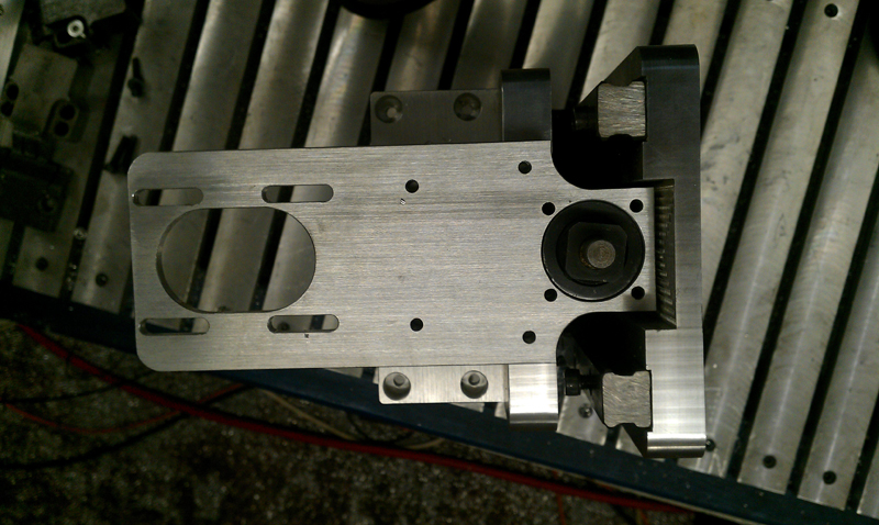

    Like jonathan it's nice to see someone who's actually done the leg work and payed attention. . 10/10. . Big respect. .

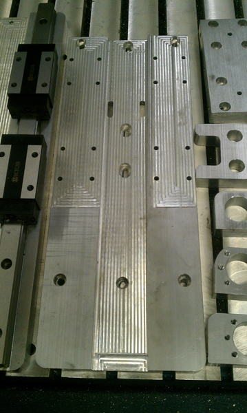

    Agree with Jonathan on every thing he's said except not using the Ecocast.! Even thou you will machine the bearing mounts etc unless you surface and make parallel both surfaces your still going to have troubles and in-accurecy. The problem comes from the cheaper plate not being uniform thickness so you can't be sure it's the same thickness (Or flat) all along it's length. This means buying much thicker than needed so it can be surfaced and still have the required thickness to be strong.
    I used to do just this but since the Ecocast has been easily available in small qty then I don't bother any more and it cuts out some of the work involved and makes things that bit easier.
    To be honest the 20mm plate is still fine regards strength even with the neccesary slots cut, I've made several with 19mm 6082 and slots etc and they are more than strong enough for even the most demanding jobs.! (Within reason) See pics of what you may have seen before just not striped down like these.?
    (obviously more thickness will be stronger but not 20mm gets the job done.!!)

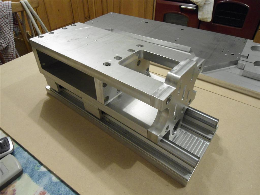

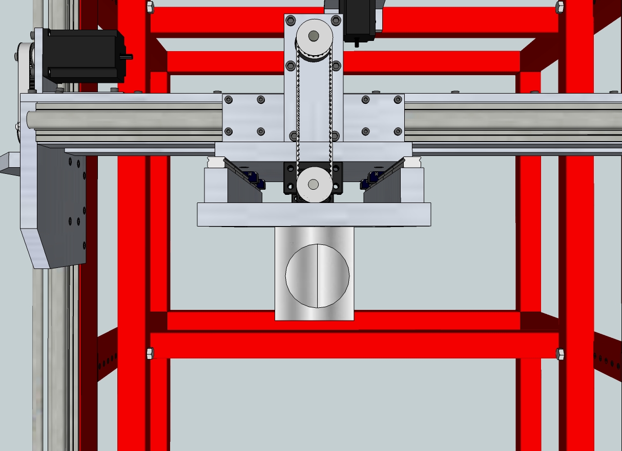

    The only other point I will mention is the belt setup and the lack of protection from chips etc.!!
    You probably know my machine use's this setup and I'm guilty of not covering the belts and while it's never been a problem, other than grabbing my teashirt a few times and trying to eat me, I would still advise you to cover them up before using the machine.! . . .I'm pretty sure the constant pounding from chips etc has or will shorten the belts life so worth doing before using the machine otherwise like me you'll never do it after machines put to work.!!
    Anyway great work and can't wait to see it turn into reality. . .

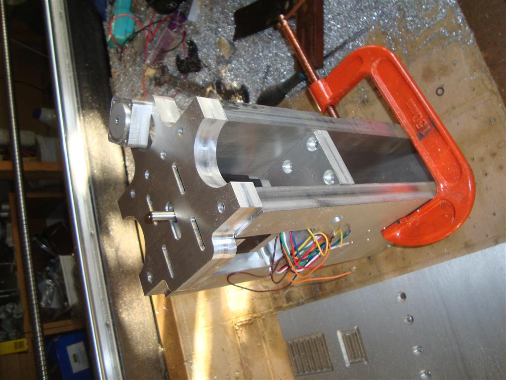

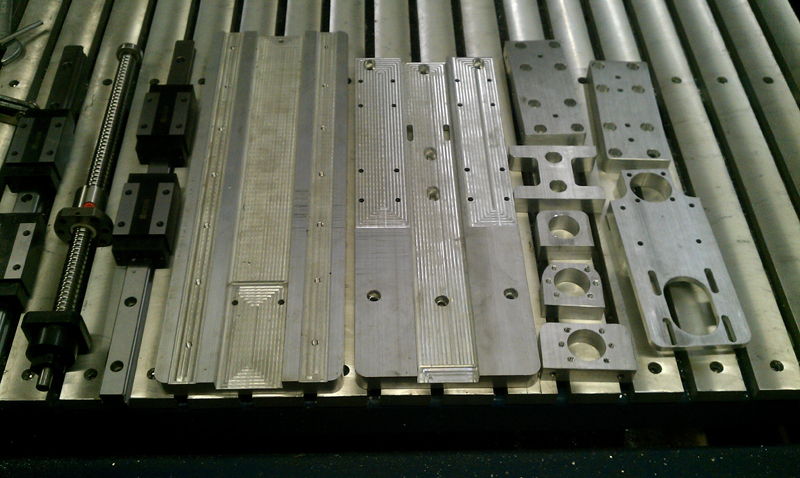

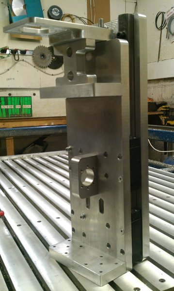

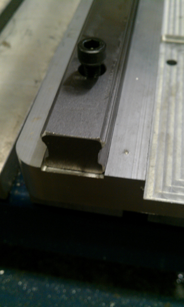

ID:	6310   Click image for larger version.
ID:	6311   Click image for larger version.
ID:	6312   Click image for larger version.
ID:	6313   Click image for larger version.
ID:	6307   Click image for larger version.
ID:	6308   Click image for larger version.

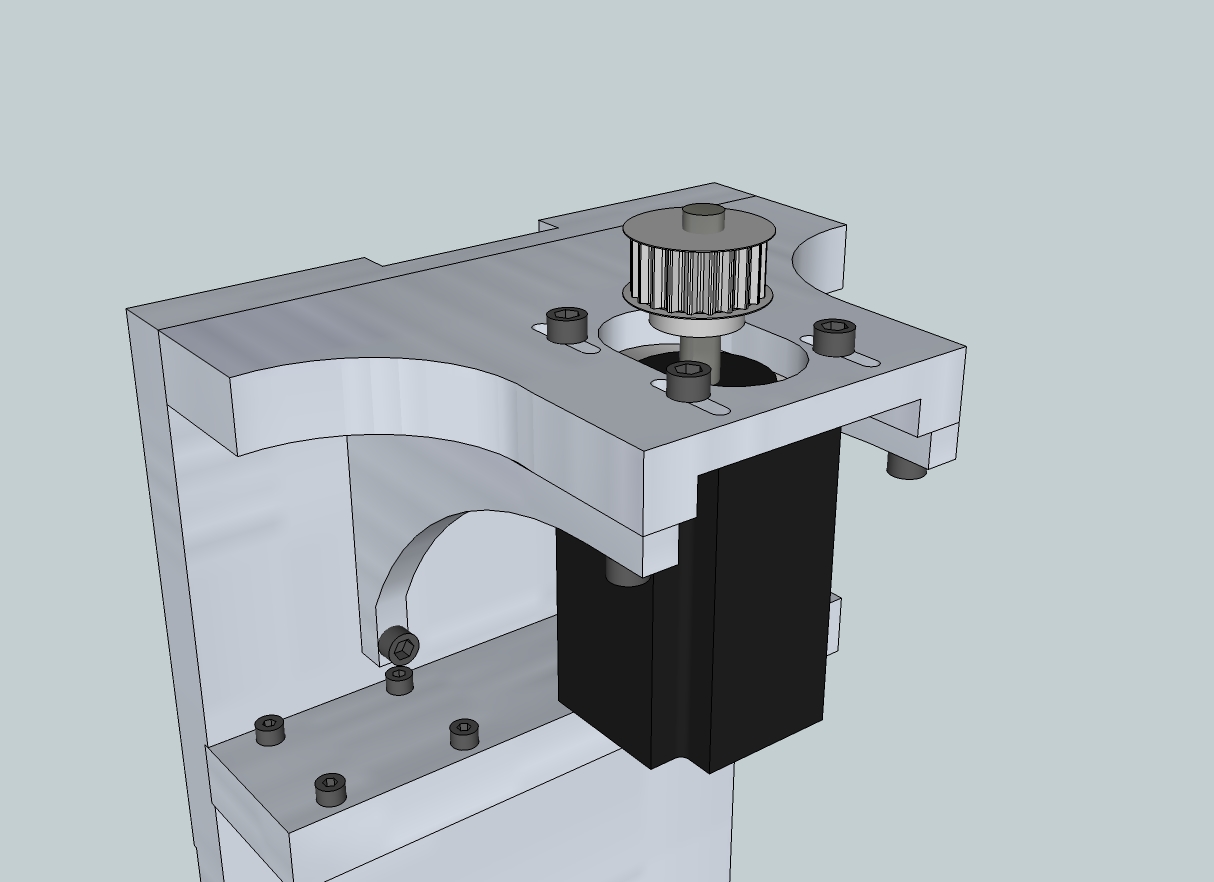

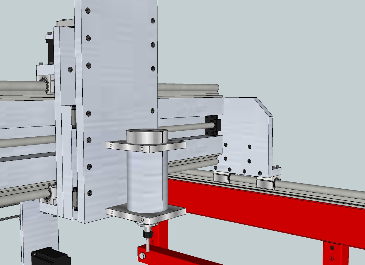

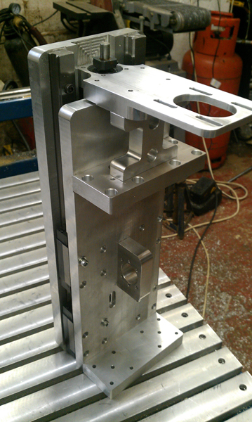

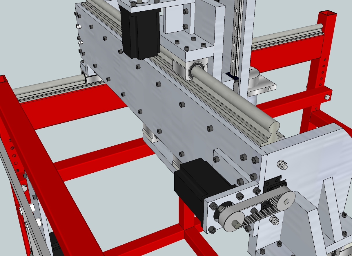

    Hello all,
    I decided to do the version2 upgrade whilst v1 was still in the drawing stage. The main change was to go profile rails on all axis. I also changed the x axis steel rectangle box for 45x90mm ali extrusion as it looks simpler and more accurate to fix the profile rails onto. Same goes for the y axis ali box section except its 45x45mm extrusion. There are two qualities to buy extrusion at, light and heavy. What do most people go with.
    Anyways, here are some modified drawings. The first one shows the profile update and the x axis ball nut mount which now allows for adjustment. The middle pic shows how I intend on screwing the bk support block and z motor mount opposite each other. A screw will go from the bk side, through the z rear plate and screw into the motor mount. Hope that is strong enough. Last picture shows how the z plates will be machined to make registers for profile rails and carriages and also allow space for moving parts.

    Definatly use the 'heavy' extrusion if you can afford it. What profile rails are those and what size...hiwin?

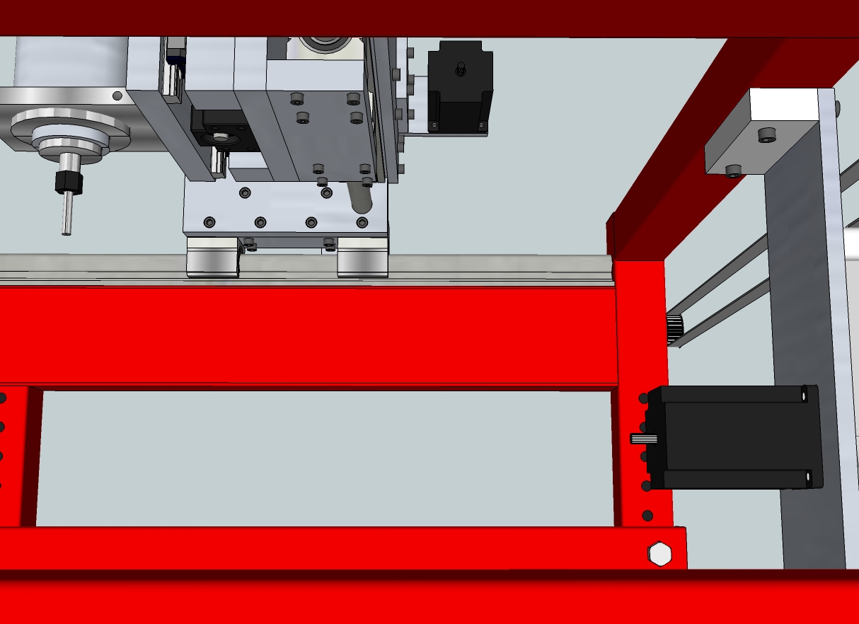

    It probably would be strong enough, but it would be good to have a second support for the motor mount, like this one I made earlier:

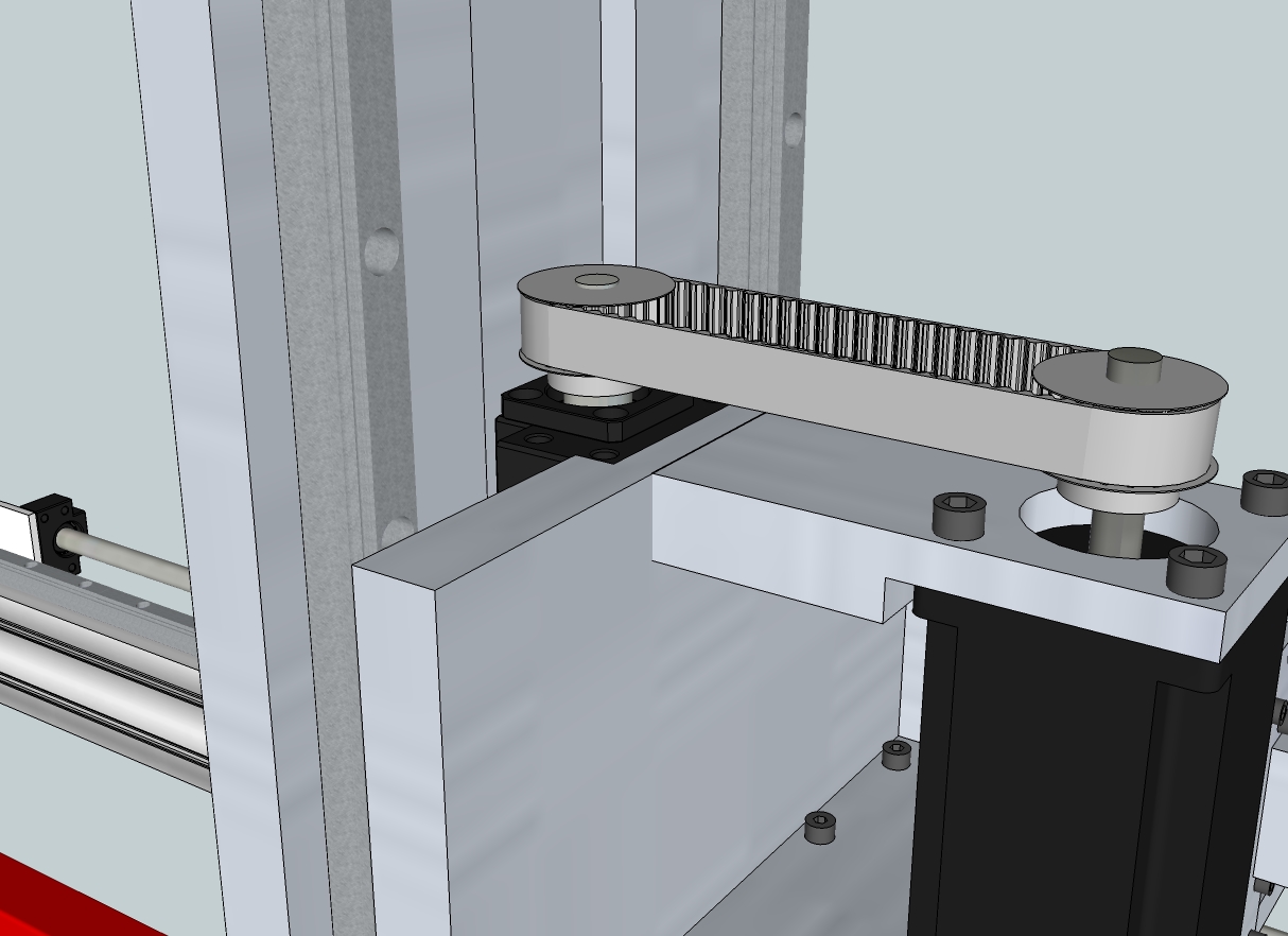

    Much more important though is you need some method to tension the belt. The easiest way is to instead of having simple holes in the motor mount, make them slots so you can pull the motor/belt tight then tighten the bolts - again like in the one above. This also allows different pulley sizes to be used without changing the belt, which could come in useful.
    Thanks Jonathan, good advice as I will be putting larger pulleys on the motor side. Now I can do it with the same belt.
    Yep going for Hiwin, as I can't find any suppliers of new THK or NSK. I'm using 20mm profile rails and the carriages have 4 rows of balls.
    I've redrawn the motor mount, but decided not to go with a full plate on the back of the z axis. Just extra weight for the gantry to carry. Can be easily added later if needed.

    15mm rails will be plenty strong enough. The load ratings of 15mm are several times what the machine will require... considering you were happy with round rails just a few days ago, I don't think there's much point using bigger than 15mm since the difference in stiffness between 15mm and 20mm profile rails is tiny compared to the difference between profile rails and round rails. Many much larger industrial machines use 15mm rails.
    If you do add one it needn't be thick - 10mm would be fine as it's only to stop the joint between the plates that the Y and Z bearing blocks mount on bending.
