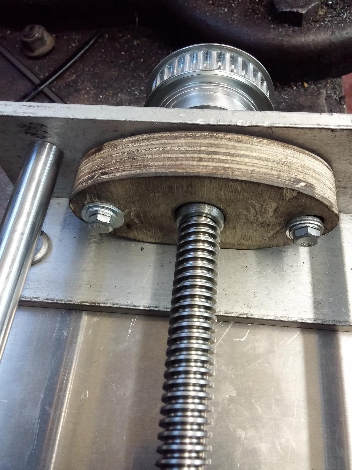

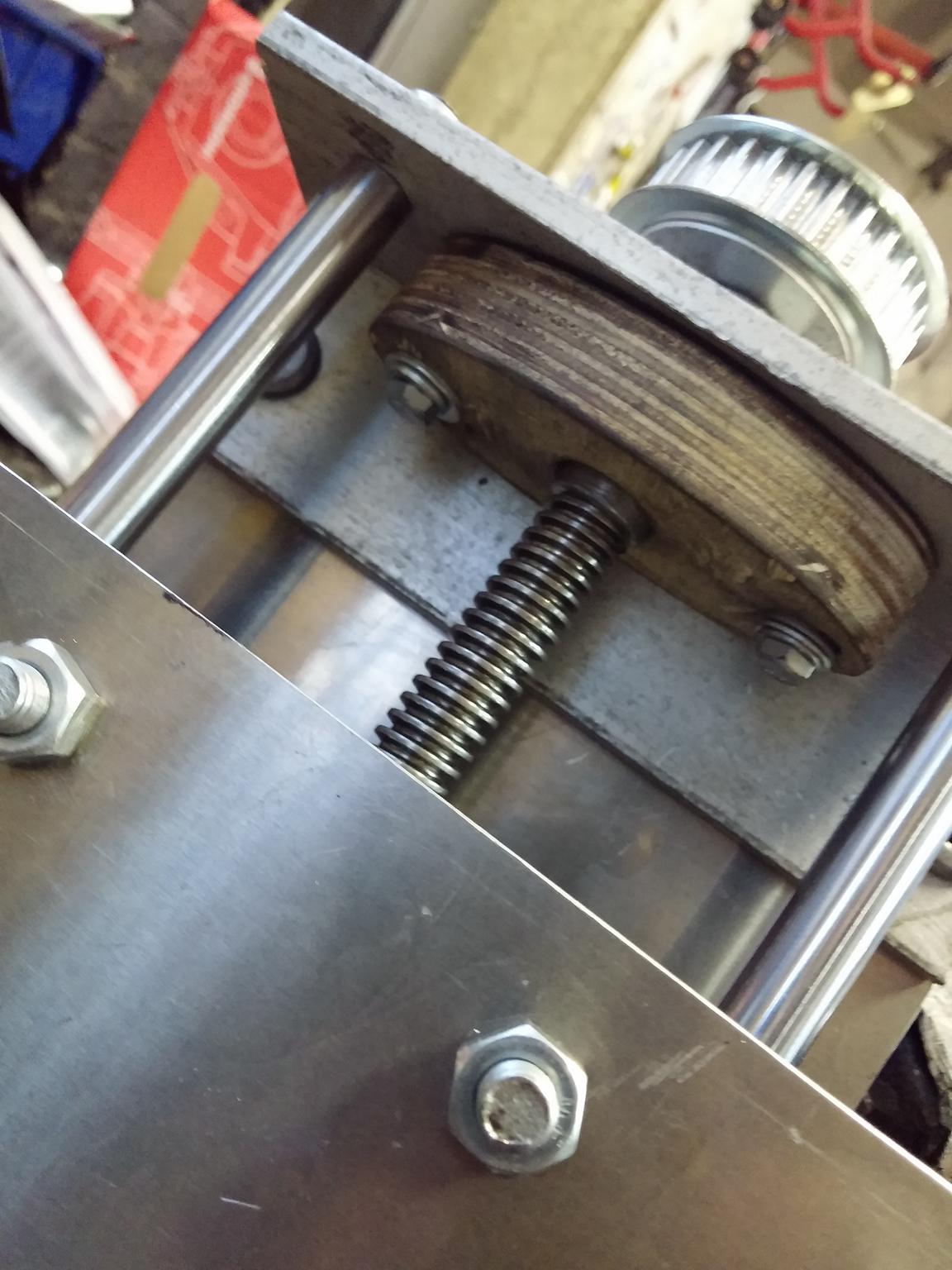

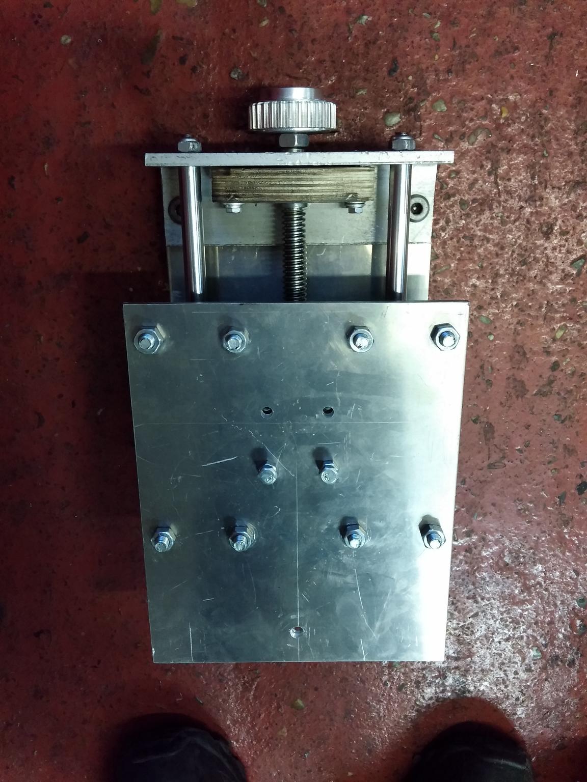

    Today i got around to fitting the lead screw for the z axis, i made the bearing holder and fitted it with a
    3200-2rs that should take care of any axial load..I have also fitted a nut with grub screw to add preload
    I decided to go belt drive so i can mount the stepper and not have it sticking up in the air.
ID:	21111Click image for larger version.
ID:	21112Click image for larger version.
ID:	21113Click image for larger version.
