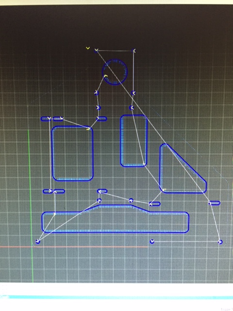

    I'm trying to cut a frame out of a 2mm carbone fibre

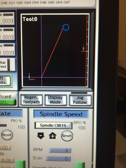

    I'm using cambam to generate toolpath and produce gcode, but once I load the file on mach3, the display only shows on cutout.
    PLease see attached photo
    Thank you

    Attach your CamBam file and g code and I'll take a look. Maybe check that you don't have a zero depth of cut or something like that.

    What is the actual problem you have as the gcode file appears to be ok
    I Clice
    As I tryed to explain in the first post, when I Load G code to Mach3 the display shows only the circle on top of the profile and the rest of the cutout sre not visible,actualy they are not there at all. I tryed to run it on a piece of plywood and it only cut the circle !!

    Ok I am not quite sure what you are saying But have you got the size (dia.) of the tool too big ie will it actually fit into the places where it is suppose to fit.
    The tool is 2mm cutter ,some slots which are 3mm wide but the rest are more than 10mm

    edit: I have loaded it in CamBam and you appear to have a cut width peram set to 3 but you are using a profile tool path. I am not familiar with CB so not sure if that is correct.
    Can you set this to auto and test again.

    I've just loaded the .nc file into Mach3 and the toolpaths all show up.
