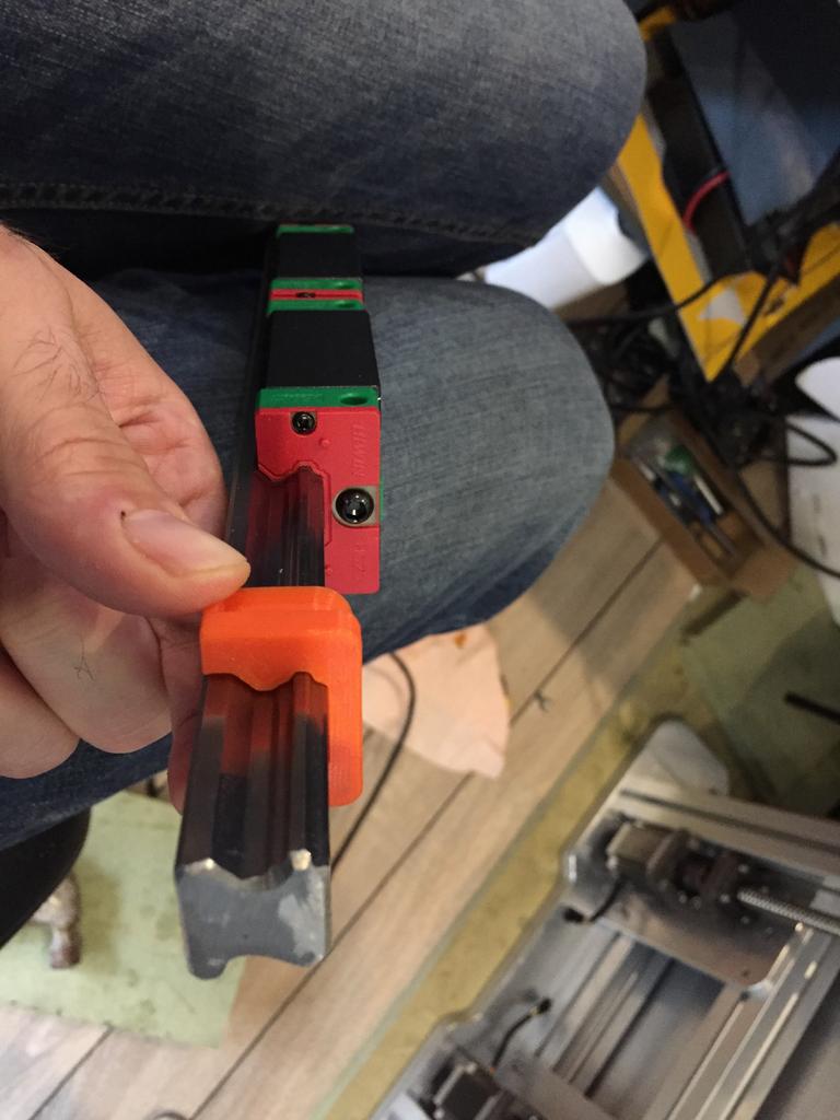

    How about this - the last photo showing the 3D printed part on the rail:
    Zeeflyboy:
    Great timing - I've been thinking about how to seal the rails on my Z axis. I've planned ahead and have tapped holes in the base of the Y axis to accept a plate with some sort of brush/seal, and I was playing with ideas for the actual seal. I was thinking about cutting them out of a small piece of plastic with the router, and inserting them into the plate, as you have done.
    But 3D printing is a much better idea as you can get tight into the corners, cheers for that. Also by chance bumped into a colleague today with a 3D printer and he is now lined up ready to make me some parts. I just need a slot this week to get back onto the CAD and draft something up as a trial.
    I think as you say it is a matter of fine tuning something to keep the worst out but not rub too much.

    RouterCNC - I just printed one out which I enlarged the cut out by 0.15mm on and I think it's perfect. Given you are using 20mm rail too you are welcome to have my model to modify as needed to make the exterior fit your machine? You use fusion right?
    If you need them printed out I can print them out and pop em in the post for you too if that helps. Flexibles can be a tricky thing to get right, some printers cope better than others (bowden types really don't tend to do great for example) and stuff like cheetah is pretty expensive to buy if he doesn't already have something comparable.

    The fusion file would be great. Maybe zip it up and attach it to a post in this thread ?
    Thanks for the offer to make some parts - he's been printing all sorts for ages plus has a CNC machine so I'll give him a go at making something. Thanks again
  7. #196
    Hopefully attached for you.

    HiWin do a scraper/seal add-on kit for their blocks, I used it on my mini-mill.
    Its a steel scraper plus another wiper/seal for each end along with longer screws etc, fits easy and works well. ;)
