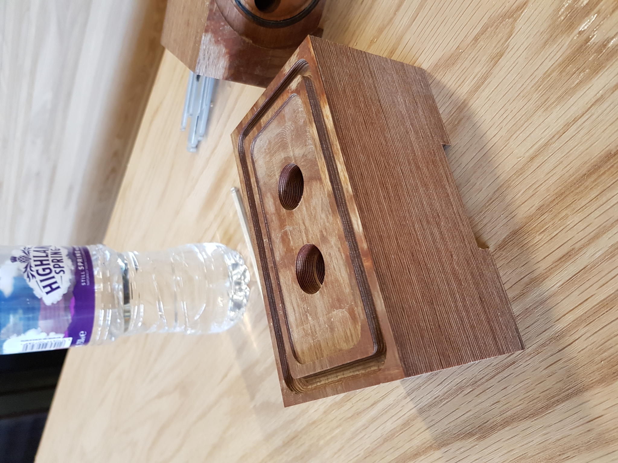

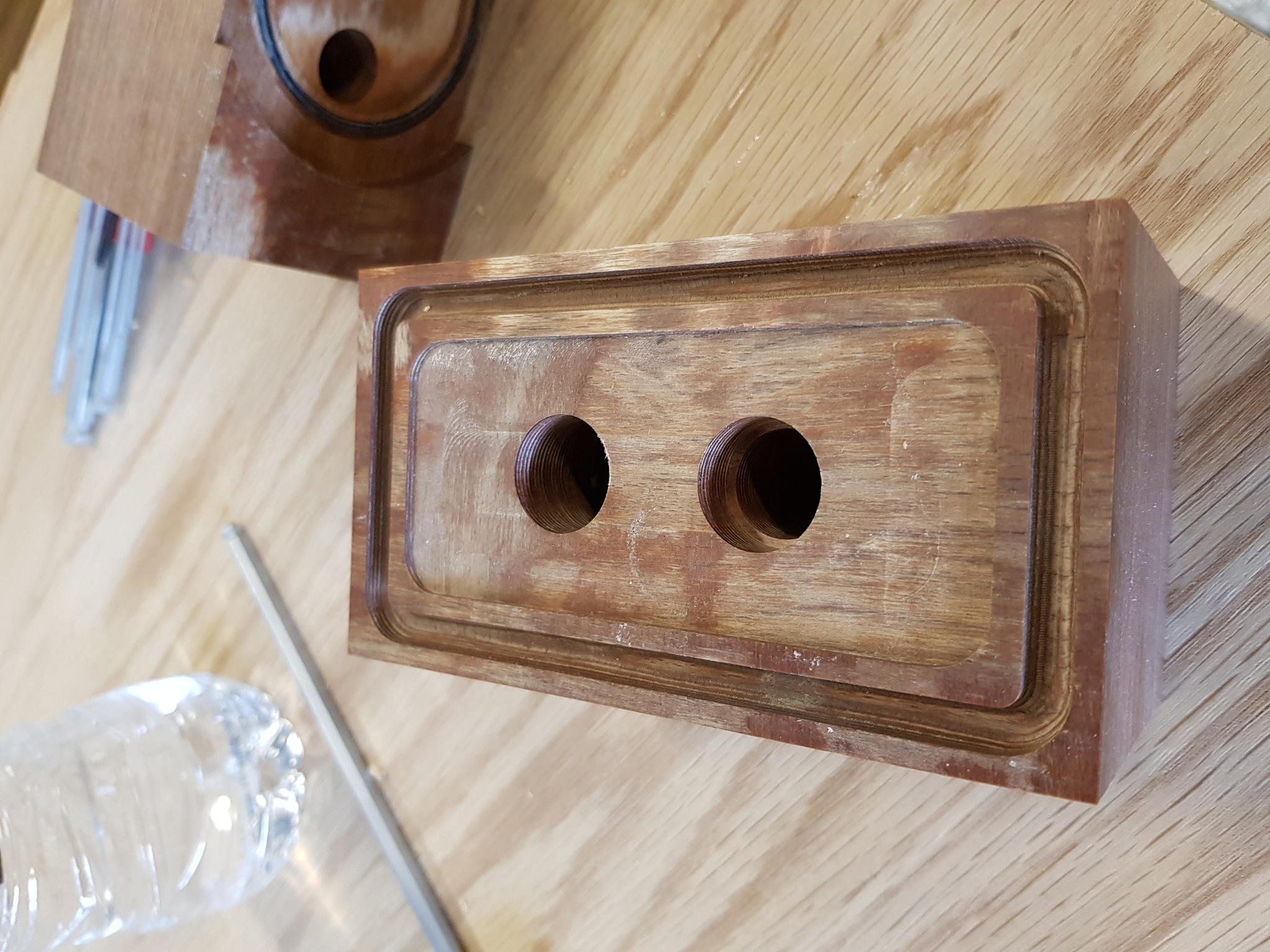

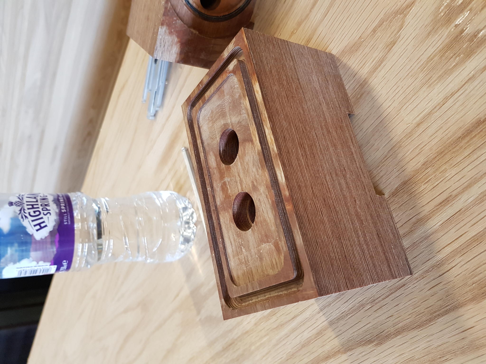

    The vacuum pods on our smaller machine are made from Tufnol / SRBP (Use the stuff from DirectPlastics), i think its absolutely horrible stuff to work with, stinks and iirc some types can be carcinogenic. On the larger machine the vacuum pods are machined from a dense type of Phenolic Plywood, much nicer to work with and doesn't appear to be affected by moisture, the stuff we get is 80mm thick.

    Tufnol is a great stuff to work with. The same settings you use for hardwood just slow feed rate to 1/3 and machines perfectly.

    Just to follow up with the Phenolic Plywood, tested it by leaving some water on it for a few hours but it didnt seem to absorb much - if any. I suppose a layer of lacquer would totally seal it.

    Alex
    EDIT: Not sure why the site keeps rotating my pictures 90Deg -_-
