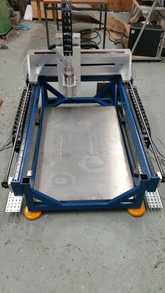

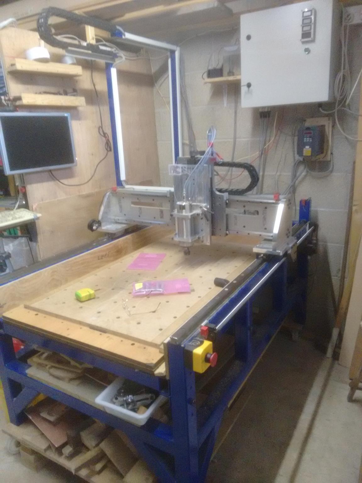

    For raised X axis I mean something like these where the gantry is mounted directly on top of the X rails, which are themselves raised well above the level of the bed. The raised X axis can then be reinforced and made as stiff as you want. Often they are steel box section, which is x3 stiff as aluminium (like-for-like sizes). This avoids having the long drop down gantry side plates which will not be as stiff.
    It is very difficult to overcome offsets by beefing up/reinforcing the connecting structure. Much better not to have the offset in the first place.

    The example you choose still had gantry sides and the X axis rails were level with the bed so no real advantage and not what I would call raised X axis design.
    Z axis swapped around looks good. I'm adding a pair of tram plates to my new machine so good to see it used on yours.
  10. #19
    Hi!
    I can recommend the high (X or Y axis depending on what you call it!!) rail approach (my machine is the bottom photo) to give stiffness. My machine munches aluminium and I've even cut (I'll say tickled really) 6mm steel plate. I presume you're the same person who frequents (or possibly did as I've not been on there for a few years now) RcHeliAddict forum, I think the last time I was on there you were just testing your small FPV Quad you designed?
    Neil...
    Build log...here
  11. #20
    And mine is the top one. I to was recommended to go down that route
