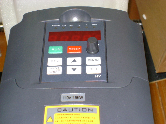

    Correct. BTW Gerry I was told on Mach3 there is the "Calibrate Spindle" on the Functions Config menu. Is this any good for me to calibrate my spindle?
    You need an encoder on the spindle to calibrate it.
    What kind of VFD do you have? You may be able to adjust the frequency to the voltage so that you get the correct RPM.

    My VFD is a Chinese model HY01DS11B as per attached pictures (3PH 110Vac, 50Hz, 1.5KW, 13A, 0.50-400.00Hz). So you are saying the Calibrate Spindle on Mach3 will do nothing for me?

    Calibrate spindle will do nothing, and if you try it, it make it worse

    No, the Gecko output is already filtered so you do not need capacitors of any value. Looks like the output voltage of the Gecko is about right anyway for the speeds demanded so looks more like a VFD issue. My HY VFD works fine with reasonable linearity so maybe there are some other parameters that can affect this?

    As I understand it, the g540 is basically just a breakout board and four stepper drivers in a single box. Mach3 does all the real work. I am using a CS Labs CSMIO-IP/M where a lot of the processing is off-loaded from Mach3 to the motion controller. Things like spindle control are also handled partly by Mach3 and part by the IP/M which has its own configuration parameters so I'm not sure that any of my system's settings would be relevant and might be misleading. All I can say is that the IP/M and the HY inverter do seem to play well together but I did have to follow the various manuals very carefully to get it all set up. The only thing I forgot to do was change the motor pole parameter in the VFD as the front panel display currently reads half the demanded speed but that's a trivial problem. In your case, there is a non-linearity between input voltage to VFD and VFD speed/frequency which is more puzzling.
