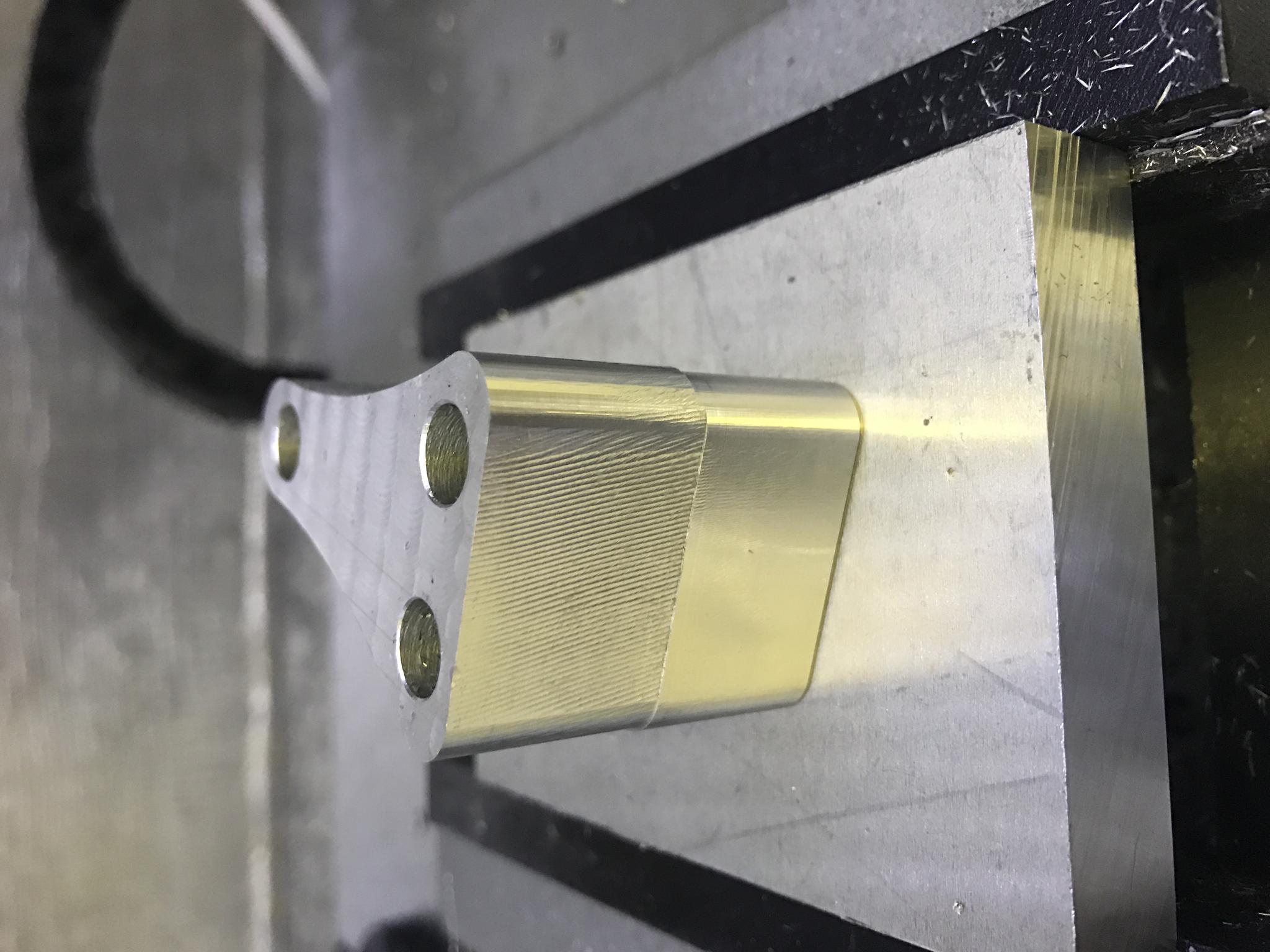

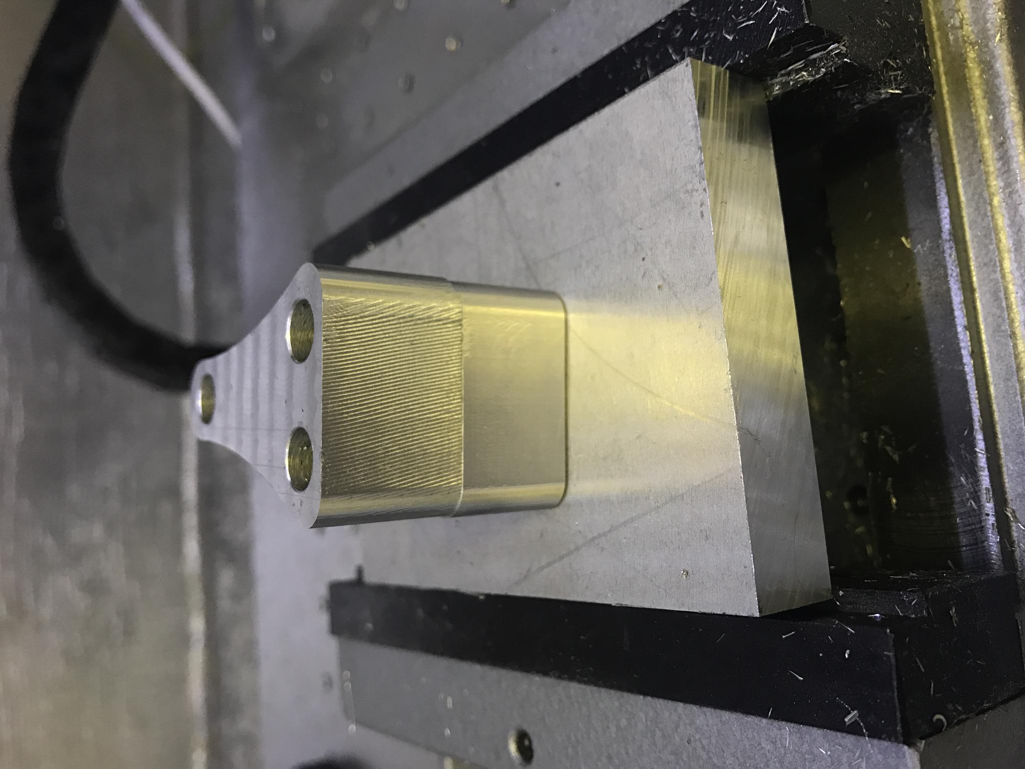

    Quote Originally Posted by Zeeflyboy View Post
    I do something very similar these days - I have a reel of 0.01mm shim steel and I jog the tool up to just short of the z-zero surface, then jog in 0.01mm increments while sliding the shim material back and forth. Once it grabs you know you are 0.01mm above the surface and it works rather well for me.
    Interesting point about cleaning between changes... Until relatively recently I never paid much heed to this and the amount of gunk that I managed to clean out of my spindle bore was eye opening. more than halved my runout by cleaning it out.... now every tool change I use compressed air to clean out the collets and bore, and usually a piece of oiled kitchen towel to wipe out the bore before then re-inserting the new collet if changing collet size.
    I use a thicker 0.55mm gauge purely because it's more solid so easier to keep straight and flat. I eyeball down then step jog back up until it fits under.
    Yeah cleaning everything is absolutely paramount to getting a nice cut. Specially with alu, chips get in the slots in the collet and cause absolute carnage. I use isopropyl alocohol on paper towel. It's quite amazing just how much black comes off everything, even after a relatively short op. I have a piece which got scrapped anyway because I didn't realign the flip properly, but each side done using the same tool in the same collet in the same nut and the difference in surface finish between the two sides is incredible. The difference being when I first inserted the tool for the first side I forgot to clean everything up first. I will dig it out the scrap box tomorrow and upload a pic as it's a great example.
  5. #175
    Here's two pics from different angles. Again this was the same tool in the same collet in the same nut running the same g-code file. Only difference being on the top half (first op) I forgot to clean everything when changing the tool. For the lower half I took the tool out and cleaned everything up.
    Quite a difference!!
