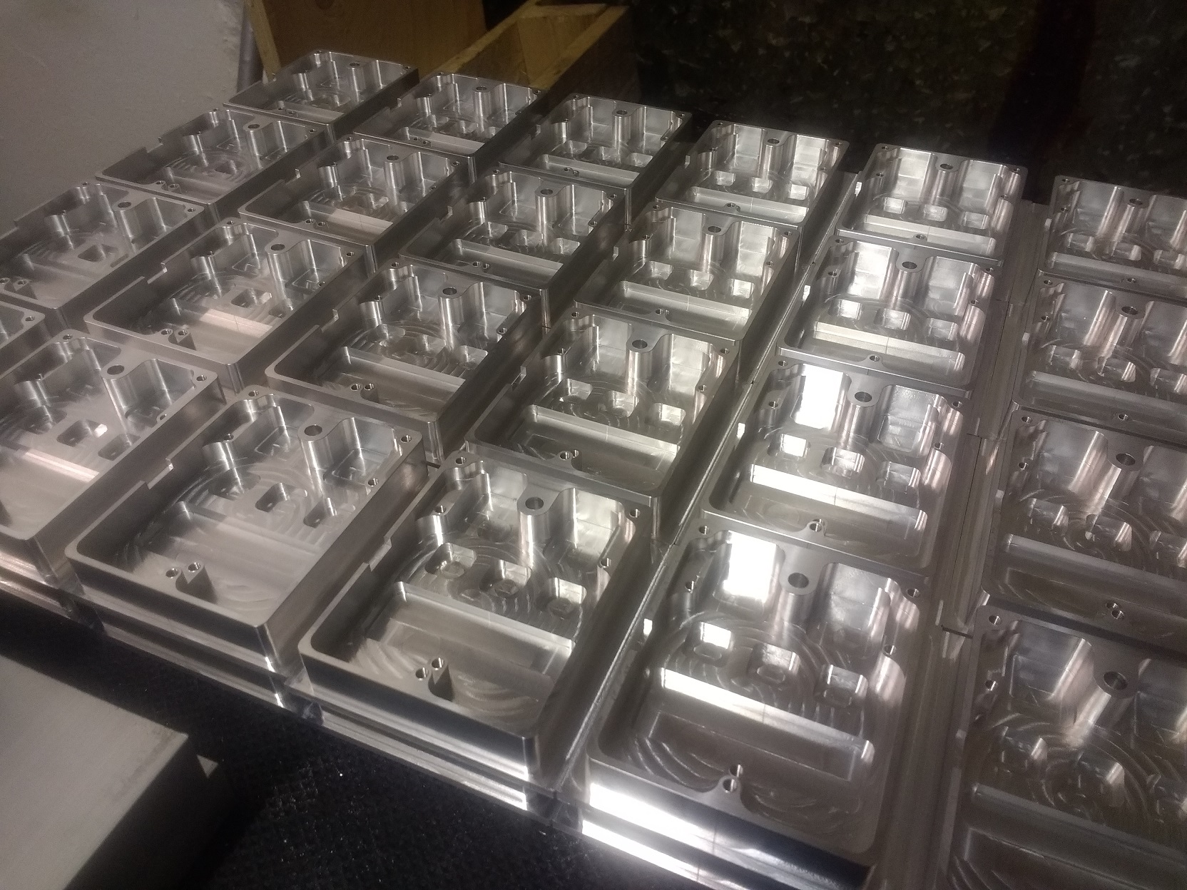

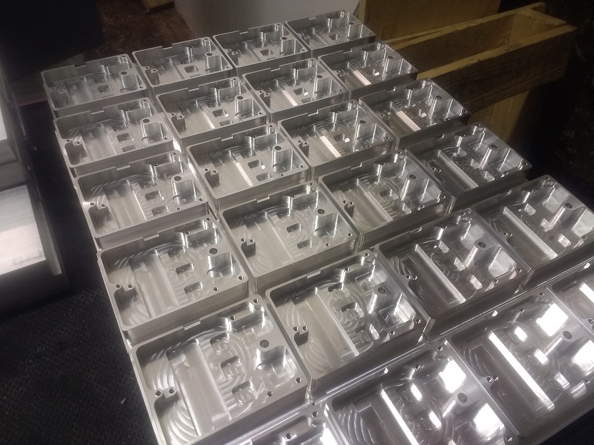

    Thanks Chaz. Sometimes the right job needs the right equipment to get the consistency and overall quality. These units are also now made in the correct material for the job, so anodising is now a realistic option should that path be looked at again.
    Jogara should be given a lot of credit to be frank. He has done pretty darn well considering nearly everything has been stacked against him. 10 out of 10 for bravery and perseverance.
    This the next lot being machined.

    Usually these things are die cast but I guess volumes are low?
    Anyway beautiful work spluppit ! Can’t beat shiny fresh cut aluminium.
