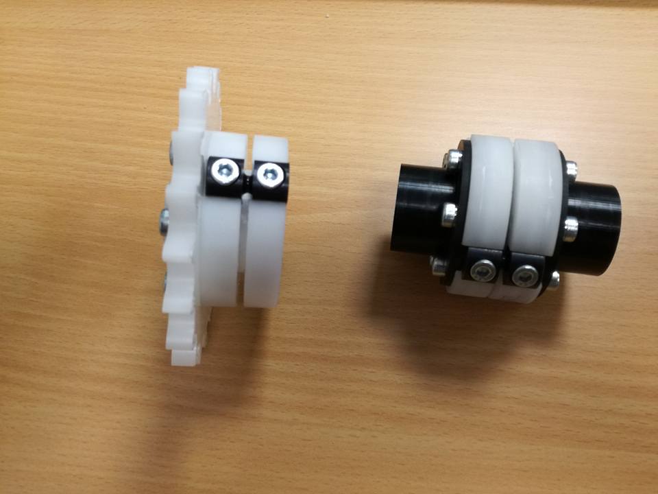

    It also depends on your machine, in fact it's mostly about your machine and how stiff it is and what type of cut you're doing. If you're slotting then you have to go slower or shallower than if you're doing a 60% width stepover pocketing pass.
    I'm about to cut some more samples (see photos below) at work in Acetal and I'll be doing 20mm deep cuts with a 6mm 2 flute uncoated carbide mill, I'm using Trochoidal milling mind so don't try to take that deep a cut normally!!

    Again within reasonable bounds, the depth of the material really isn't hugely relevant to the machine's ability to cut it... as long as a tool in an appropriate diameter and length can be found then it really just becomes a question of number of passes.
    That last piece must have taken ages to machine at that speed and depth, but as you can see most of these things will have a stab at alu.
    If going the chinese router path, I do recommend you avoid any round or unsupported rails if alu is on your to-do list, having owned both I can say you will have much less frustration if you get one that at least has proper HG20 rails... take a look at omioCNC - they make some of the better chinese routers imo (I own an X6-2200L at the moment, building myself a new bigger badder one mostly for fun). If you wanted to go sans-electronics they would probably sell a bare frame if asked.
