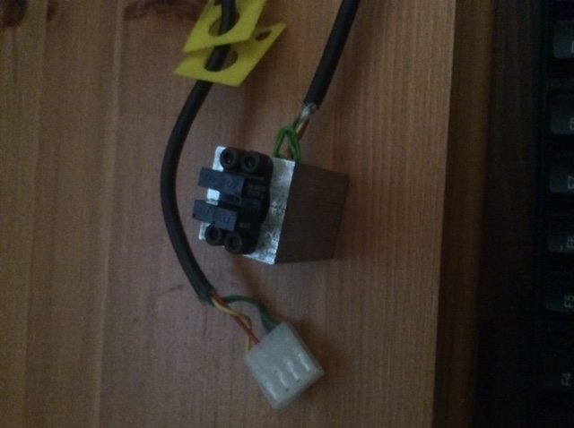

    The disc on the end of the spindle shaft has 100 holes and on the outer rim there is one hole.
    There is a dual slotted opto used to sense the speed. is has 4 wires, yellow,red,blue,green,

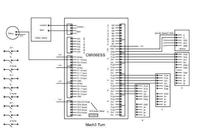

    I need to hook these into my breakout board which is a CM106

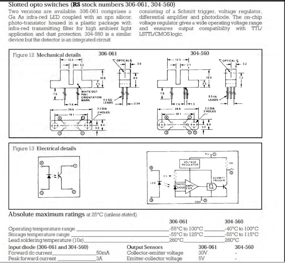

    What's the model/part number on the sensor?
    OPB866T55
    RS306-061
    Two of them mounted and offset.
    Attached Thumbnails Attached Thumbnails OPTO.pdf

    Do you have the input specs for the BOB?
    It may be easier to connect directly to the ESS, as by the looks of your schematic, the inputs are all 24V, so you'd need a buffer board/circuit to boost the sensor output.

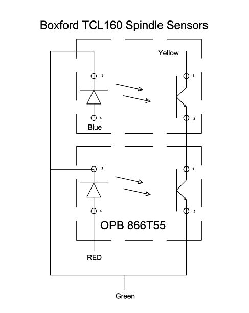

    Many thanks, heres the diagram of the opto's as they are configured on the lathe. Modified sketch included along with Spec
    Can you help with the connections to
    Green, Blue, Red and Yellow.

    That looks to me as though you have the LEDs and transistors transposed, so the LEDs should be on the right and the transistors on the left.
    If that were the case, green would be ground, yellow would be power and the red and blue would be your inputs.
    Adrian.
    Thanks Adrian,
    I have amended my sketch and I think it is now correct,
    Blu = In1
    Red = In2
    Green = Gnd
    Yellow = Vcc What would you recommend the supply voltage ?? Specification attached.

    That diagram is still wrong. The LEDs should be powered continuously. It is the transistors which are generating the signals on the blue and red leads.
    When the solid part of the disc is between the LED and the transistor, there is no light reaching the transistor, so it does not conduct. This allows the red/blue wires will be pulled high by the BOB.
    When the gap in the disc comes round, the light from the LED passes through it, hits the transistor and it switches on. This pulls the red/blue wire to ground, generating the pulse needed.
    The Boxford circuit diagram appears to show the sensors powered by 10V, so the sensors should have resistors for that supply already.
