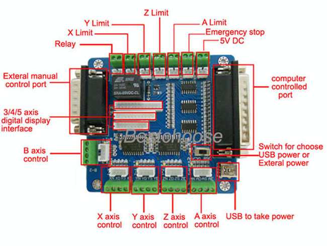

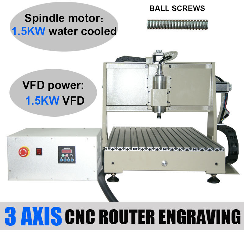

    Hi there, i have a new bob but can't seem to figure out what the markings on the board are, my drivers have 3 wires
    P 5v D the motor has 3 wires AVI Red Com Black FWD Blue and the fan has 2
    The problem is the identification letters on the bob don't make any sense to me can anyone please help

    Kev You need to give more info None of us has crystal balls apart from Dean.
    re the driver P = pulse or step 5V is the supply and D = direction.
    But what motor are you asking about? put a link up to the manual what is the fan is it 12v etc

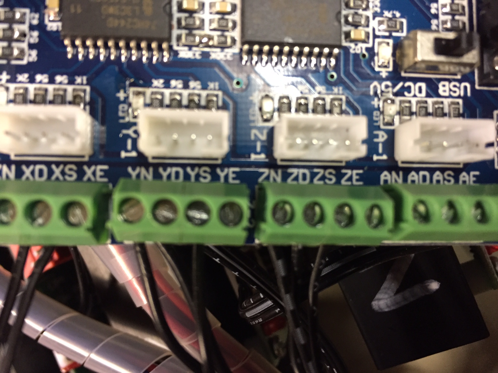

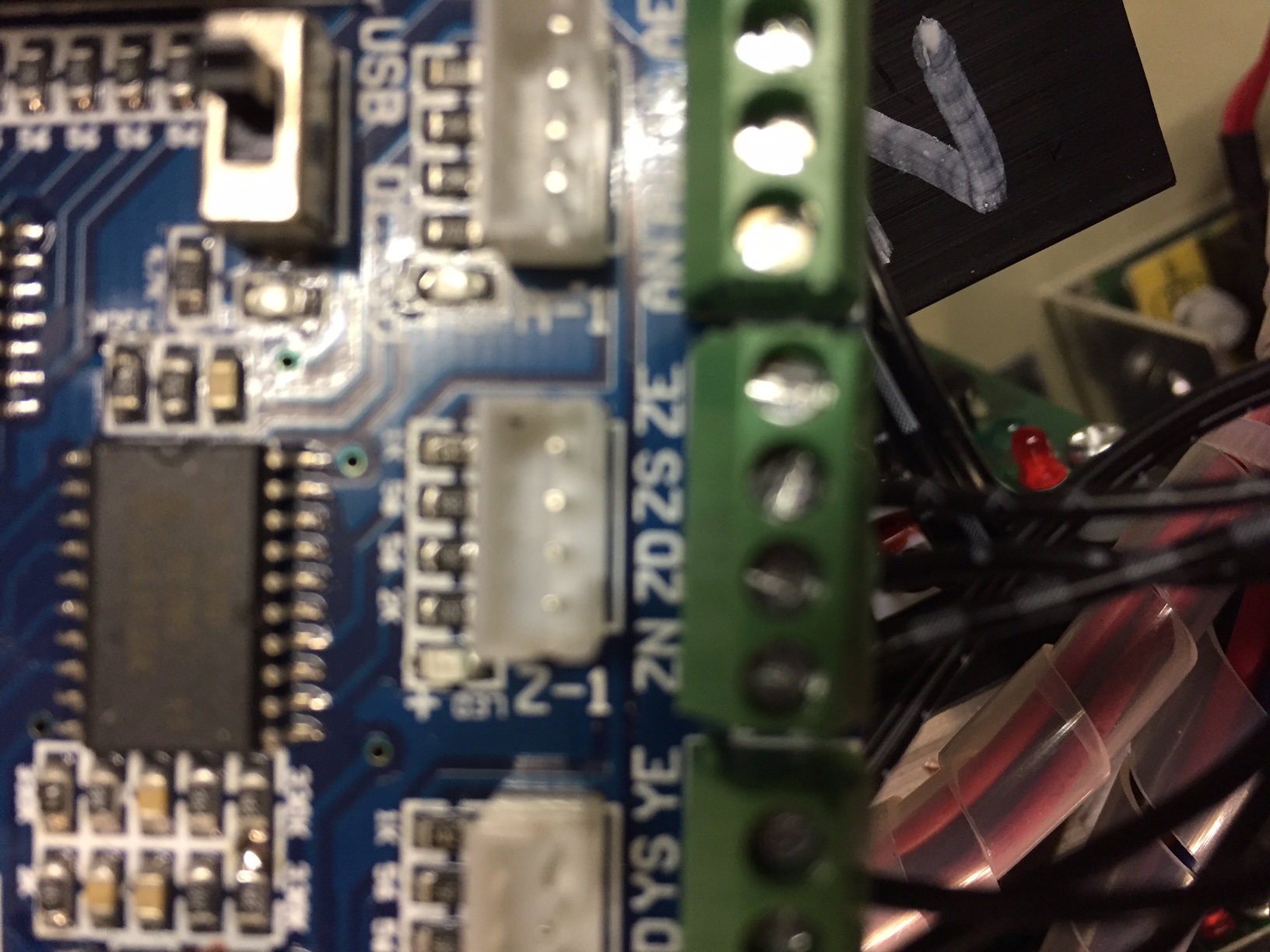

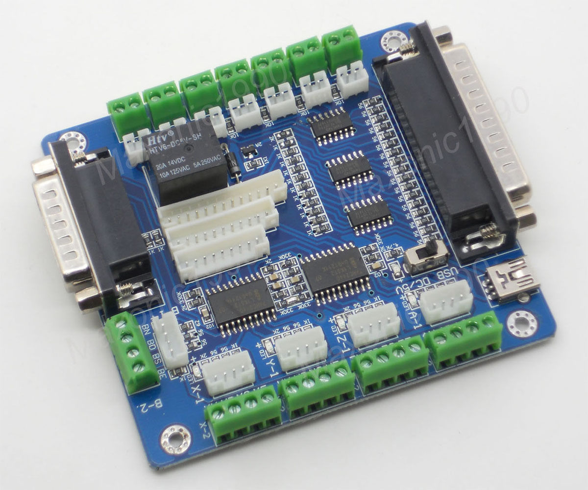

    Hi Clive thanks for the reply, when i read it back it's not that clear.
    ill just start with the drivers, i have 3 wires as you've said pulse/step 5v, dir. the terminal blocks on the bob are labeled XN XD XS XE ( i've just put the X axis) am i right thinking XD=direction XS=step, but what does XN & XE mean

    Ok Do you have a link to the bob manual?

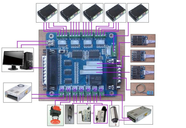

    Quote Originally Posted by Saracen View Post
    Excellent find see #2 Kev
    see if this is any use, i have a disc but it only shows what can be connected, like drivers limit sw etc

    Kev did you see the link from Saracen the answer is in post two by Dean with the connections
