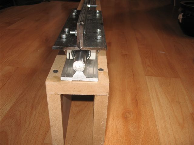

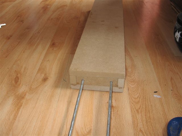

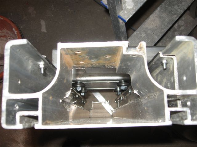

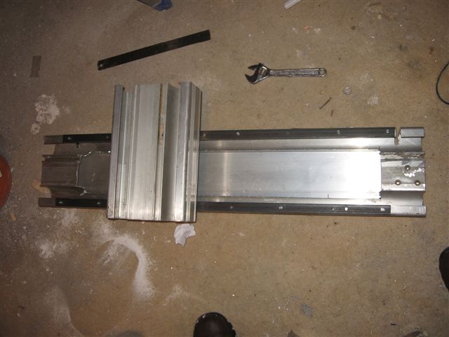

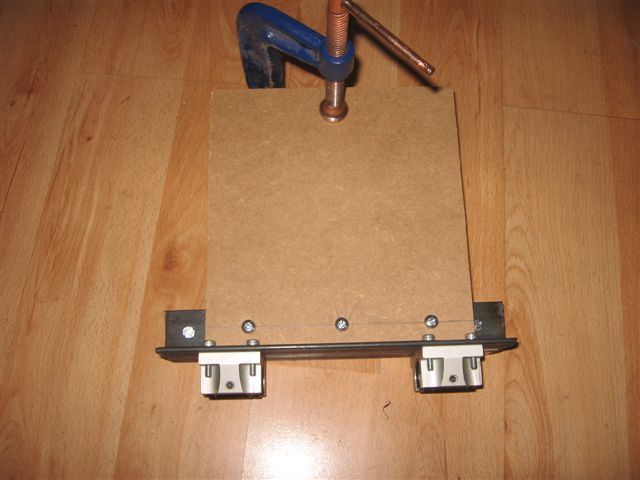

    supported rail and bearings , stepper motors arrived from zapp ( thanks gary) so i made up two carridges and mdf box (still to screw and glue ribs inside box) supported rail will be bolted to mdf box , box will be bolted to base . that gives me 200mm from base to carridge , should keep x and y axis close together

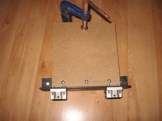

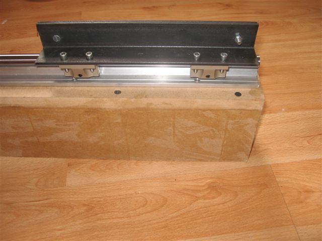

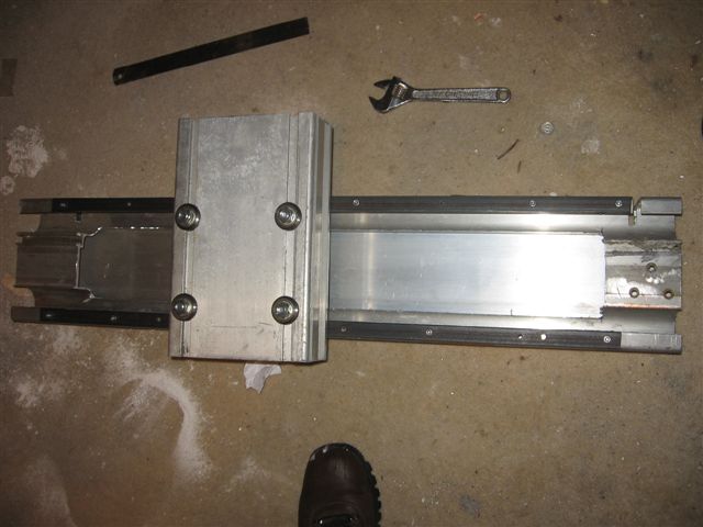

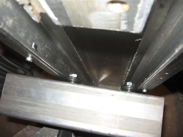

    built the gantry sides today

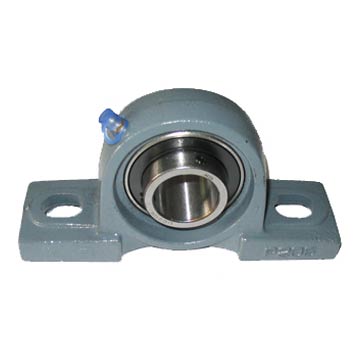

    any ideas for securing 12mm lead screw without machining the ends
    would this do Click image for larger version.

    Are you using 12mm studding or 12x3trapezoidal? A 12mm ID bearing will sort of do, but the fit will be poor. Better to machine the ends down to 8 or 10mm for a good fit on a suitable bearing and thread them for a locking bolt. have you considered how you are going to manage end-float?

    using 12 mm trapeziod .. would the 2 grub screws in the pillow block not hold the screw against any lateral movement .... can the bearing take axial load ,.. was looking for a way round this as i dont have a lathe

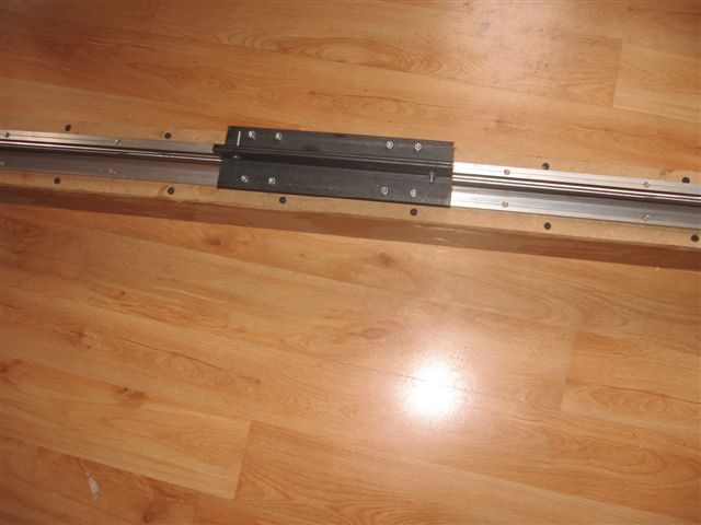

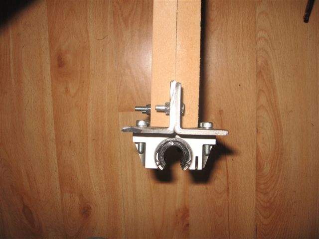

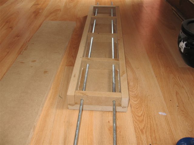

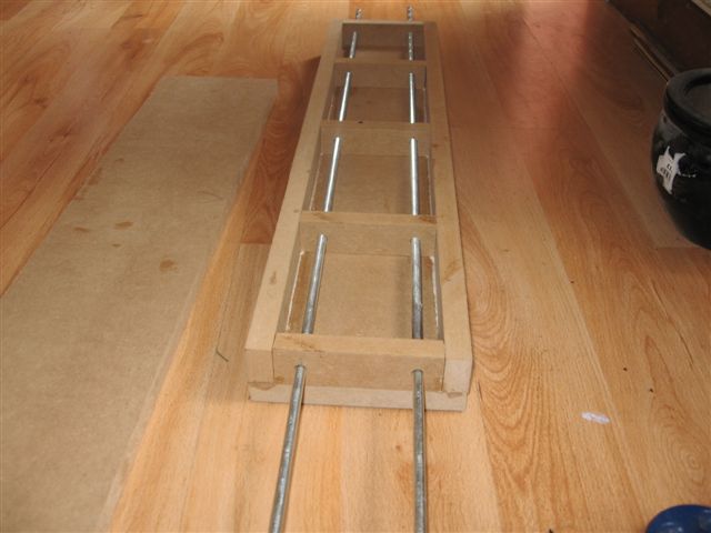

    built basic gantry this morning , threaded rod will pass through gantry sides bolting it all together , will also be bolted down through carridge angle iron(bed frame)
    Those type of bearings are poor at axial load, they can handle some but are not good for locating the shaft axially, which is what is needed to minimise backlash. Somewhere you need thrust bearings to take the axial load or angular contact bearings (hard to get in small diameter ID).

    Its not so much the bearings Kip, its the pillow block approach.. the way the bearing locates in the block doesnt give a positive position to the shaft. I'm sure it could be made to work for light cuts, but thats a fairly big router Jon's constructing so I'd assume he's got big plans for it ...
