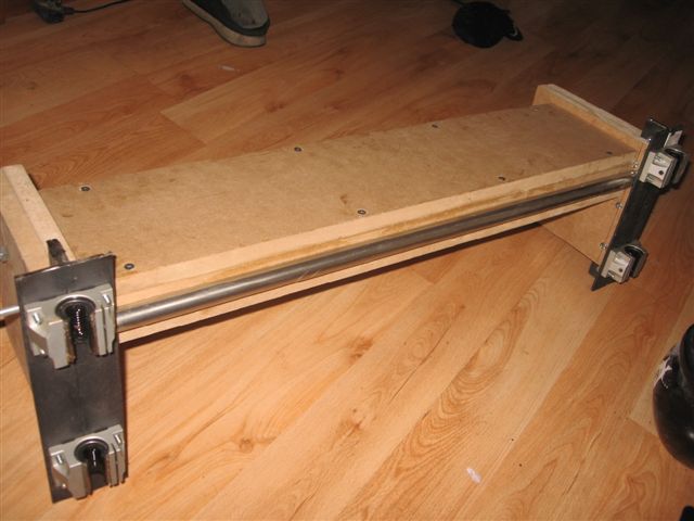

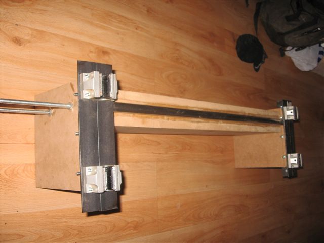

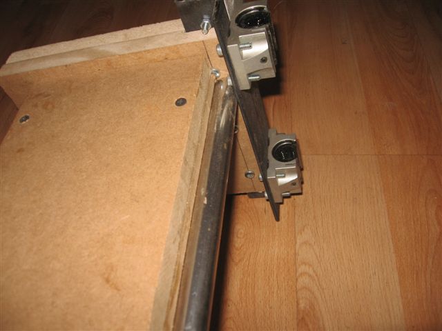

    hi guys
    thanks for input ... fixed gantry to sides today, bottom runner in , all feels pretty rigid

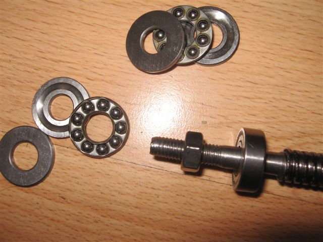

    going to attempt to grind down screws to 8mm then use skate bearing .. with thrust bearing either side , on evilbay thrust bearings for £1.90 each
    cant find angular contact bearings at 8mm, and magneto bearings are £6 each ....... i am after all scotsman

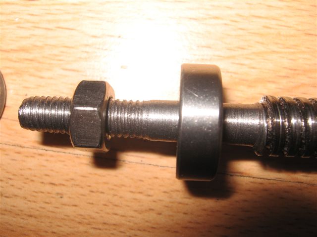

    bag of bearings arrived from " gap bearings " today...
    will feed three 12mm bearings on to trapeziod screw fix bearings down with theseClick image for larger version.
ID:	712 drill on one end , then attack with grinder... sounds so simple....... we will see
    worked a treat took the threads of with grinder ....last few mil with a file .......
    threaded end for m8 nut

    I am impressed Jon. How did you jig the grinder to control the attack?
  10. #20
    jonm's Avatar
    Location unknown. Last Activity: 19-06-2011 Has been a member for 9-10 years. Has a total post count of 89.
    irving
    done it free hand , went down with the grinder till just the very bottom of the threads were left, then set calipers to 8mm ( screw still turning with drill) and used file to take it down the rest .. checking with calipers took about a hour to do .... happy with the result
    should eliminate endfloat with thrust bearings
