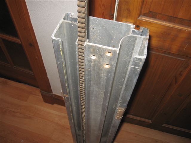

    hi tribbles
    will go and get the calipers to measure the rack
    Just had a thought about the meaning of the "P" value - this is actually the height at which the pitch diameter would ride at.
    So, if you had a 60mm diameter gear, and "P" was 10mm, then the centre of the gear would be 40mm from the base of the rack.
    jonm's Avatar
    Location unknown. Last Activity: 19-06-2011 Has been a member for 9-10 years. Has a total post count of 89.
    hi tribbles
    get 11mm pitch 3.1mm at the crown of the tooth
    and rack is 12mm wide , i am still confused cant seem to find anything similar, unless im measuring at the wrong place
    Going from crown to crown, then 11mm is near as damn it mod 3.5. However, I've not seen that many mod 3.5s.
    This seems to indicate this company makes them: http://www.rushgears.com/Tech_Tools/geargages.php
    I take it you didn't find any gears with it, did you...
    jonm's Avatar
    hi
    tribbles yes you'r right it looks like mod 3.5
    no, no gears with it im afraid
    mod 3.5 looks hard to find

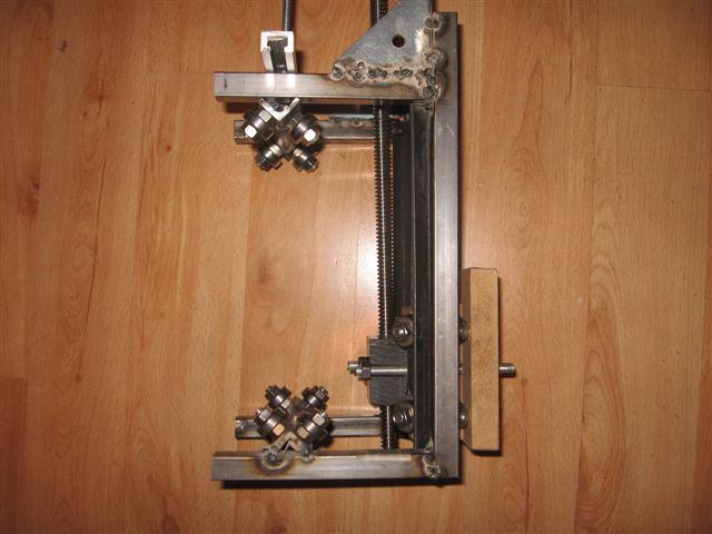

    v groove bearings arrived from ebay this morning, the t slots on the back of the beam just happen to be size for a 10mm bolt head...
    the x and y are rock solid much better than my first mdf creation
    apparently this ali beam came from a stenna stair lift 190mm x 90 no flex at all even after cutting out the middle section . screw will go through the middle of the beam , gives me 600mm on the y
    new trend t4 coming from santa for spindle...
    jonm's Avatar
    this ali beam is becoming a source of many parts .... with the centre section cut out it makes a very sturdy motor mount

    the skate bearing is in the mdf with another thrust bearing on the other side ... have some delrin may make a bearing block from that
