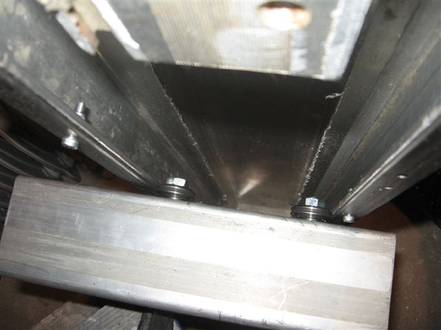

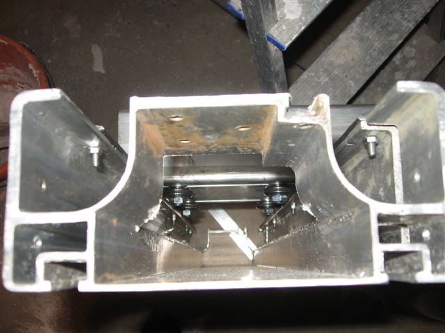

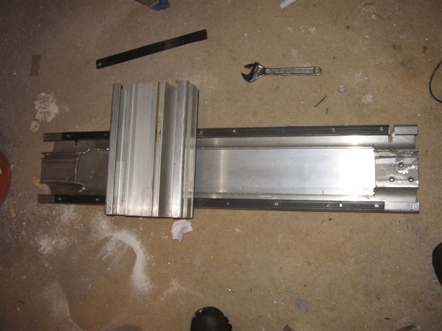

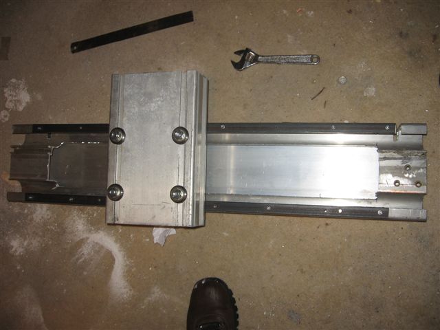

  10. #40
    jonm's Avatar
    Location unknown. Last Activity: 19-06-2011 Has been a member for 9-10 years. Has a total post count of 89.
    v groove bearings arrived from ebay this morning, the t slots on the back of the beam just happen to be size for a 10mm bolt head...
    the x and y are rock solid much better than my first mdf creation
    apparently this ali beam came from a stenna stair lift 190mm x 90 no flex at all even after cutting out the middle section . screw will go through the middle of the beam , gives me 600mm on the y
    new trend t4 coming from santa for spindle...
