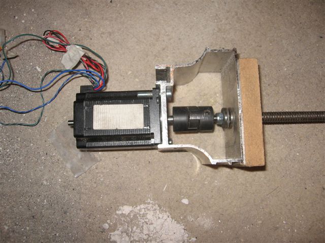

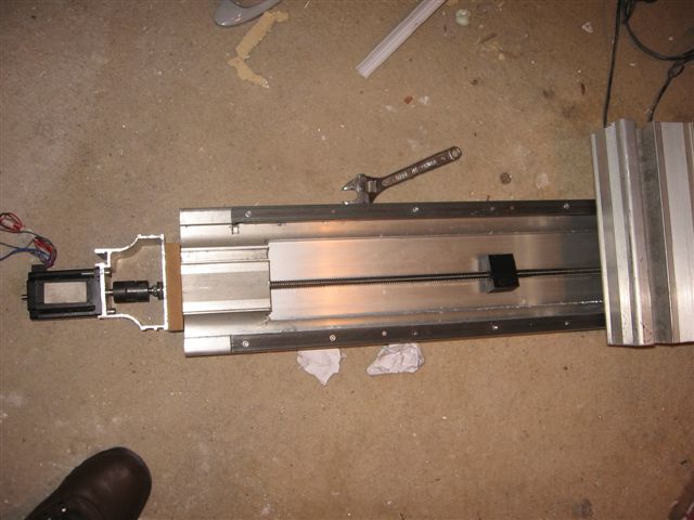

    this ali beam is becoming a source of many parts .... with the centre section cut out it makes a very sturdy motor mount
    the skate bearing is in the mdf with another thrust bearing on the other side ... have some delrin may make a bearing block from that
  2. #42
    Looking good, those beams look promising. I,ve got some similar ones that are also from a stair lift. Not sure I would of cut so much out of it tho.
    I plan to mount the rails on the other side with the T-slots, why did you choose to mount them as you did?
    It will be interesting to see how it performs, save me some R&D
  3. #43
    jonm's Avatar
    Location unknown. Last Activity: 19-06-2011 Has been a member for 9-10 years. Has a total post count of 89.
    hi ross
    even with the centre section cut out there is still no flex in the beam, also reduced the weight , it was very heavy... wall section is 6.5mm.
    was intending to put a few 8mm threaded rods through from top to bottom , along the lenght, with 2 nuts inside and and 2 outside which would have held it rigid, also could have adjusted the preload on the bearings (as a adjustable spacer) but think its going to be ok. can always be added later
    with the screw inside keeps the y axis and z axis very close , going to cut the centre section out of the z as well , to keep router as close to the y axis , to reduce cantilever
    holidays start tomorrow so plenty time to rebuild

  4. #44
    Hi Jon
    Fair play on the weight issue It seems that when you modify stuff you have to compromise, the removed section will reduce its strengh and torsional stiffness but as you say the reduced weight and the fact you can bring the leadscrew closer will probably be more benificial.
    I'm just cautious now after setting up my lathe, it a fair old chunk of steel but it dosnt take much for it to flex and cause poor surface finish. I suppose it depends on what you are using it for.
