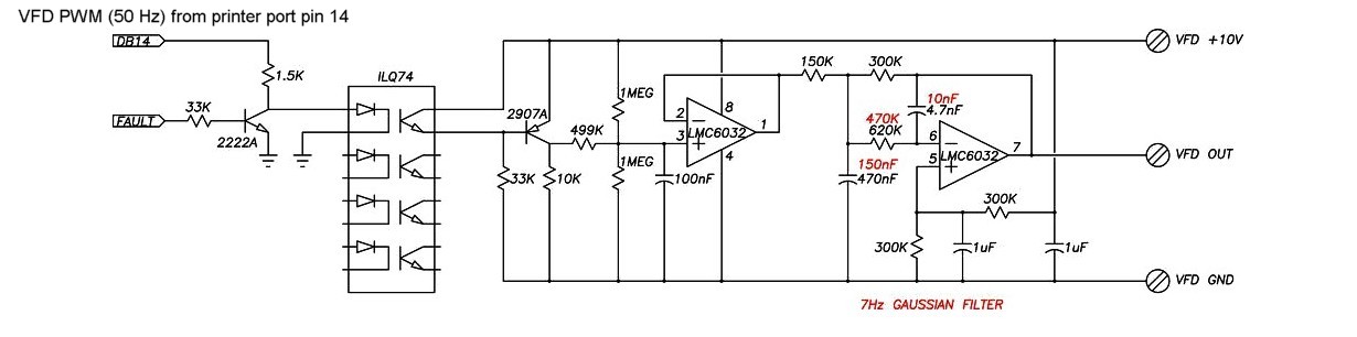

    I saved this G540 VFD circuit from CNCZONE

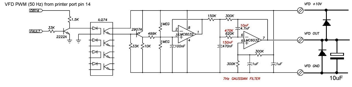

    if you add a 10uF capacitor I 'd connect the output terminal to 2 diodes to prevent the output being taken below the ground or above +10V supply terminals

    If that's what's inside the G540, then clearly there is an appropriate low-pass filter that should take out the worst of the ripple and leave a reasonably clean analogue output. In that case, the 10uF capacitor is not needed. And the OP's problem lies elsewhere...

    if you add a 10uF capacitor I 'd connect the output terminal to 2 diodes to prevent the output being taken below the ground or above +10V supply terminals Click image for larger version.
Name:	G540 VFD Schematic plus 10uF.jpg
    John there are 3 diodes on your schematic. Should I use 3?
