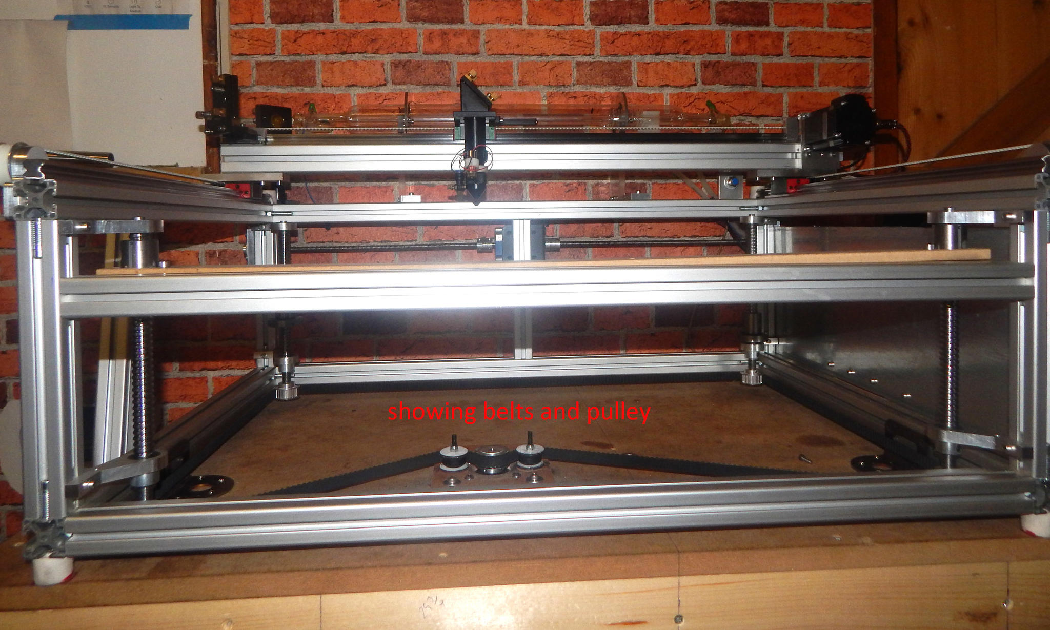

    Hi guys not sure if anyone as seen this done, I build a z table for a laser cutter, and tried 4 1605 screws with closed loop belt driven by nema24, put all ball nuts to bottom or top rises smooth go back down, but when it comes back up all screws are out 1 will be top but all others out with bigger gaps than others,
    There plenty of these table working, so not sure what screws are used, I now these were overkill but I had 2 so just perchased 2 to match lenth,
    Thanks guys for any help. Kev

    Kev, why dont you show us what exactly you are dong?
    project 1 , 2, Dust Shoe ...

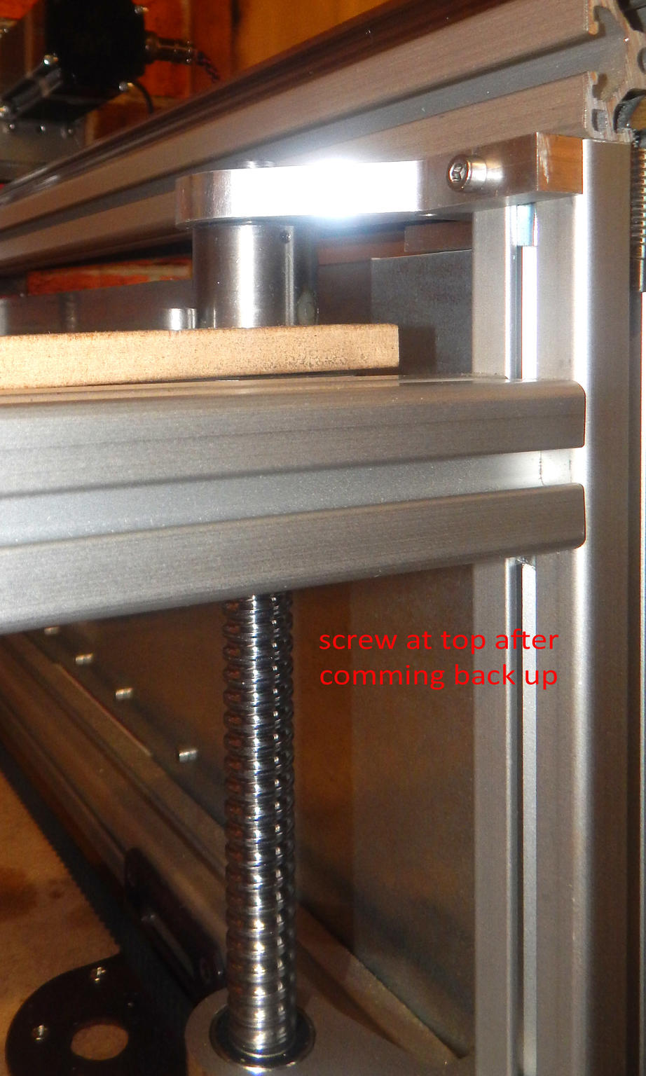

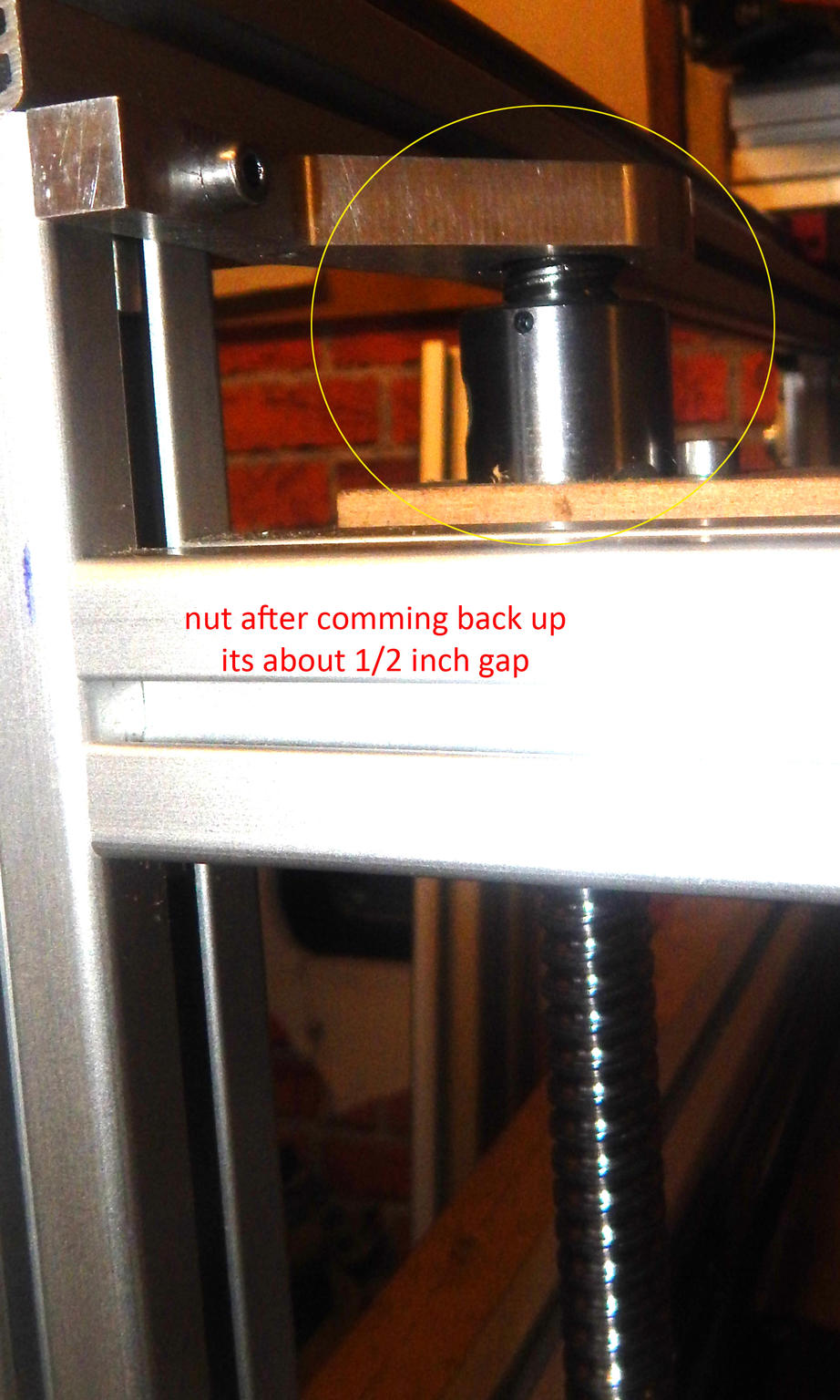

    hi sorry for late reply photos to show,
    there is 4 rods and nuts, table taken off to try too get it to work, photo shows rods and belt, and the 2 that im trying is out of sink,
    thank you guys for trying to help kev

    When you set this up did you start with all the nuts at the top before you put the belt on? or loosen the grub screw on the pulley and then turn the screw to the correct position and then retighen
    Repeat the up/down cycle several times to see if the error increases with each cycle, if it does you have a mechanical problem.
    If you mark the screws at the front top with a marker pen and run up and down several times do the marks all come to the front again at the same time?
    hi thanks for reply, done the up down several times but gets worse, it doubles the gap on the left rod, put red mark at front of rod and one was just off and the other by a bit so marks never came back, thanks again kev
    hi clive yes done it where I could turn the belts and pulleys before tighten grub screws, put nuts top bottom and middle with a gauge block,
