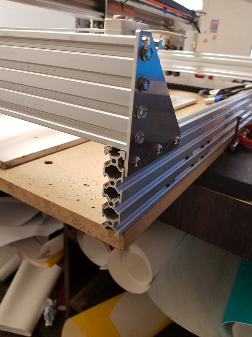

    I noticed my machine had extrusions which where double mounted to make them far taller than needs be.
    So today i have taken the extensions off, leaving me with a frame i cant attach to the MDF board.
    I presume Sliding nuts / t slots would be fine if i made approximately 5 holes on either side of the 1 meter x 1 meter board?
    So having looked at the various types of nuts, i cant seem to work out the extrusion type/series.
    The rails i have are 20mm x 80mm.
    How can you tell the major differences1?

    Any ideas? Also, right now the bottom frame is mounted on MDF. I want to swap this to at least aluminium or steel struts, how would I go about doing that?
    Sent from my SM-N930F using Tapatalk
    Think its v-slot linear rail
    See http://ooznest.co.uk/Linear-Rails
    They have all sorts of brackets & fixings, hopefully there should be some of use
