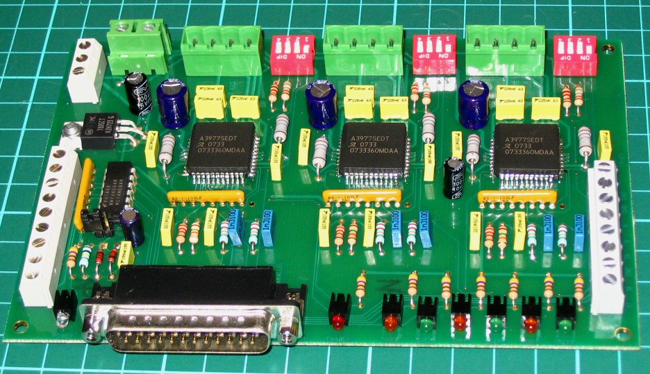

    Got a machine in for repair and it's fitted with one of Roy's System 3 board so looking for the PDF booklet on it if anyone has one.
    Can't ask Roy as he's retired to Spain and sold out to R-Tech, the welding people but they have discontinued all the CNC parts.

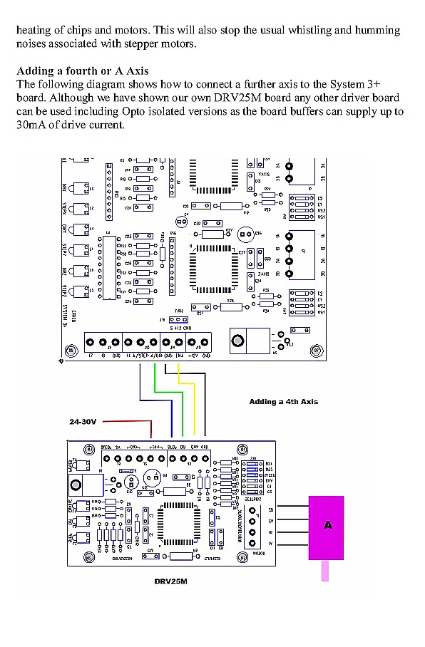

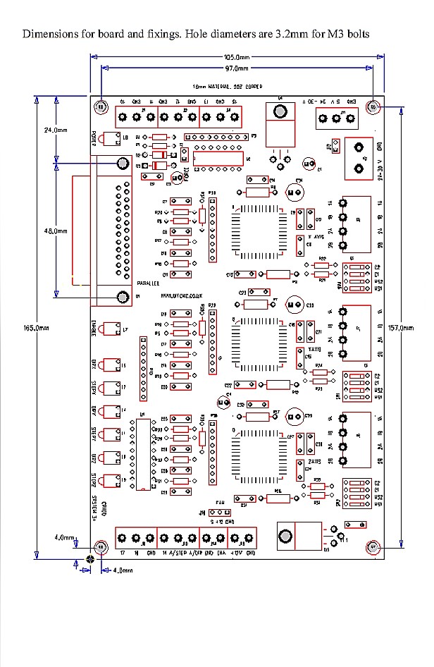

    I have just had a look here -
    https://web-beta.archive.org/web/*/h...cnc.co.uk:80/*
    see next to bottom file
    found the system3 manual and a photo
    for some reason I cant upload the manual !!!
    I'l try and save the pages as jpegs

    John,
    Thanks for that but after doing a bit of searching earlier on the same site I determined it was a System 4 but with only three cards fitted.
    I now have about 5 copies of the various iterations of that System4 book.
    Many thanks anyway.

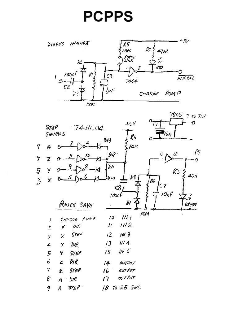

    Hi John
    spindle 2 & pcpps circuits to add to your CRH Design archive
Name:	spindle 2 .jpg
    John
