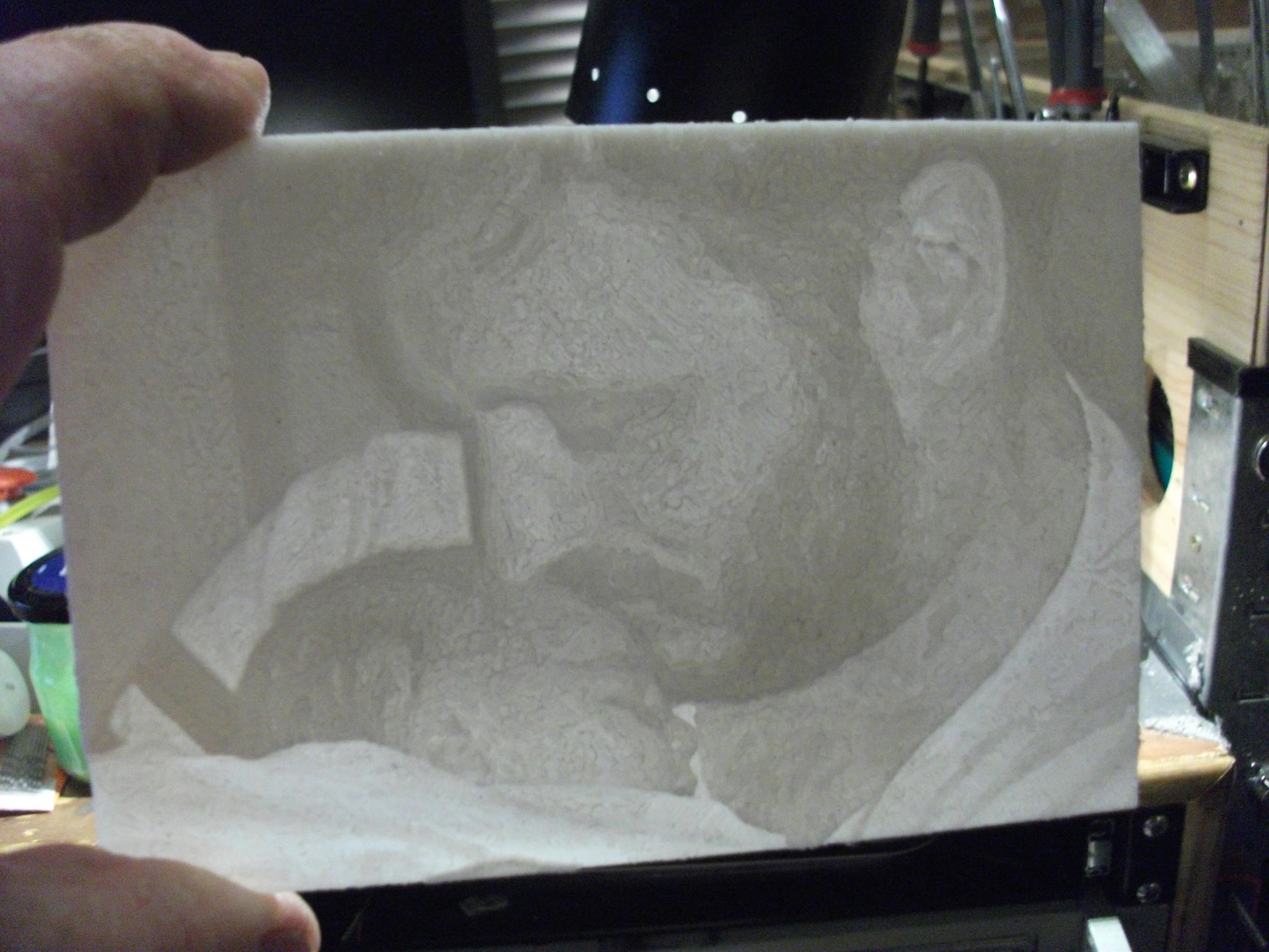

    In the meantime here is a lithophane 3D printed from a photo using Cura. My first attempt, I am very happy with it.
