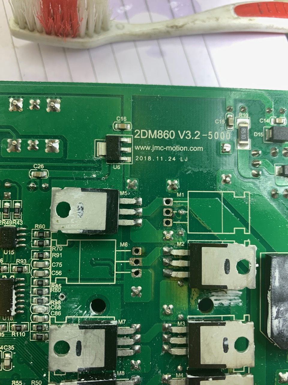

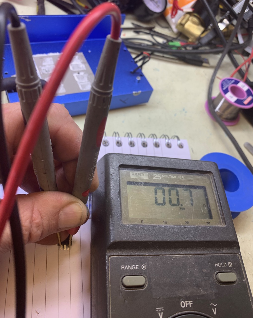

    I'm going to replace MOSFETs marked M1 and M6. I'm going to be lazy and crop the leads from the devices to give me 3 pins soldered to the PCB, but first a sanity check that the device, removed from the board, exhibits the problems measured in circuit.

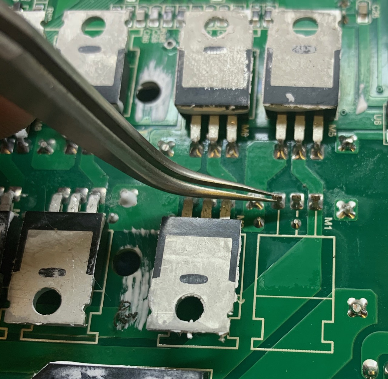

    Next, with tweezers (reduce the thermal mass) remove each pin with the aid of a soldering iron from the copper side.

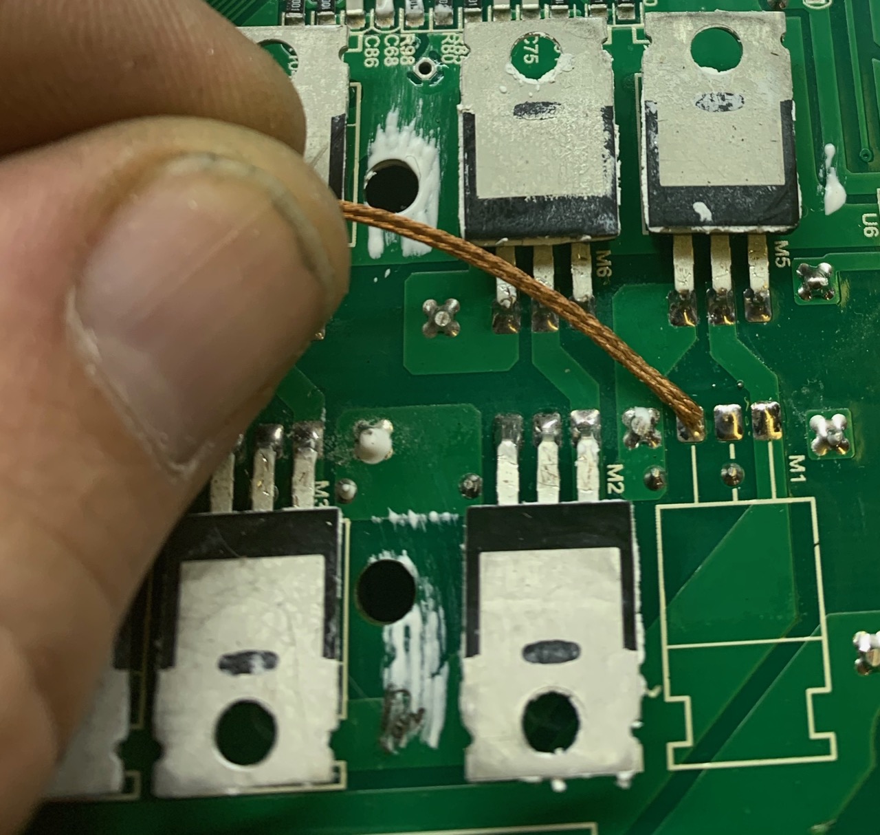

    Next, with solder-wick and the iron, try to clean out the lead holes for the MOSFETs the best I can. In honesty I did 4 this way before falling back on a desoldering workstation - I figured I'd proven the point that this can be done cheaply... but no point labouring this point to myself - use the best tool for the job.

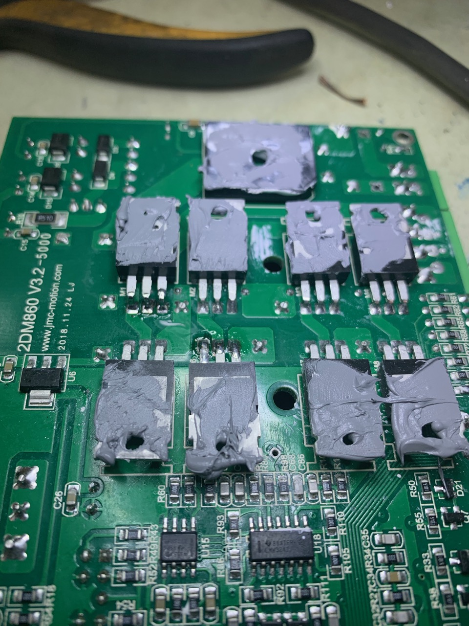

    Note, plenty of heat-sink paste applied to all components.

    You haven't used any tools that most builders aren't going to need anyway to fit all the plugs and sockets on a machine (I'd add a solder-sucker for clearing out the holes) and my only gripe would be the lavish amount of heatsink compound. Nice to think Dean will be sending you a pallette-load of stuff to repair.
  4. #44
    I agree - the problem is twofold here - there are isolating pads currently stuck (I use the term guardedly) to the heatsink - using a little bit of heatsink compound. There's no registration of the actual devices to the pads, and no mechanical means other than the PCB stand-offs (and bolts) to mechanically couple the devices to the heatsink. So, you're relying on the stand-off of the device from the board to mate with the heatsink, and/or the blob of compound to provide a conformal interface with a reasonably low thermal resistance. I've not been able to find from the data sheet if the device tab is electrically connected to the silicon, but a test of one of the fails devices suggests that it is - which warrants considerable caution with maintaining the superficial mechanical registration with the pads. The usual approach of a thin film doesn't work in this situation.
