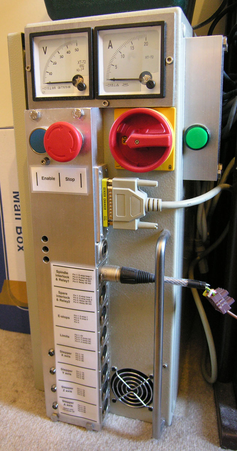

    Did manage to get the control box finished and tested - see attachment - went a bit OTT with blinkenlights and meters but I like it :-). Don't like sticking out cables so put on the alu channel for the XLR sockets. The other bit of channel on the right hand side is where the mains comes in from the back (and there are also two mains outlets for spindle power etc which are also controlled by the main isolator switch). Did an OTT e-stop scheme with time delay relays, links out to e-stop a future spindle VFD, etc etc. Will do a proper write up at some point...
