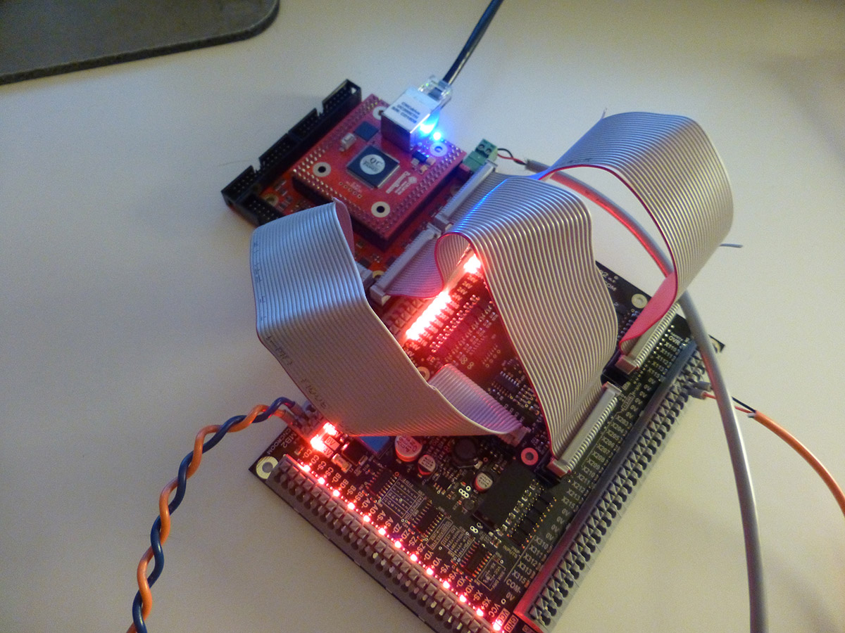

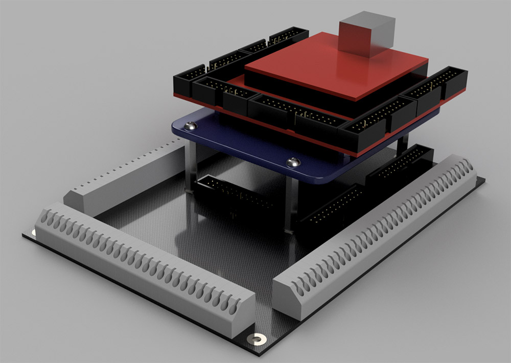

    I'm using a MB2 with my UC300. It's an awesome breakout board. The downside is that the MB2 is made to mount to a Smoothstepper, so you'll have to mount it off to the side, or make a mounting plate, something like this.
    http://www.cncroom.com/break-out-board/smooth-stepper
    It's going to run a little over your budget, but you've already spent a considerable amount on your drives and the UC300, so a little more won't kill you.
