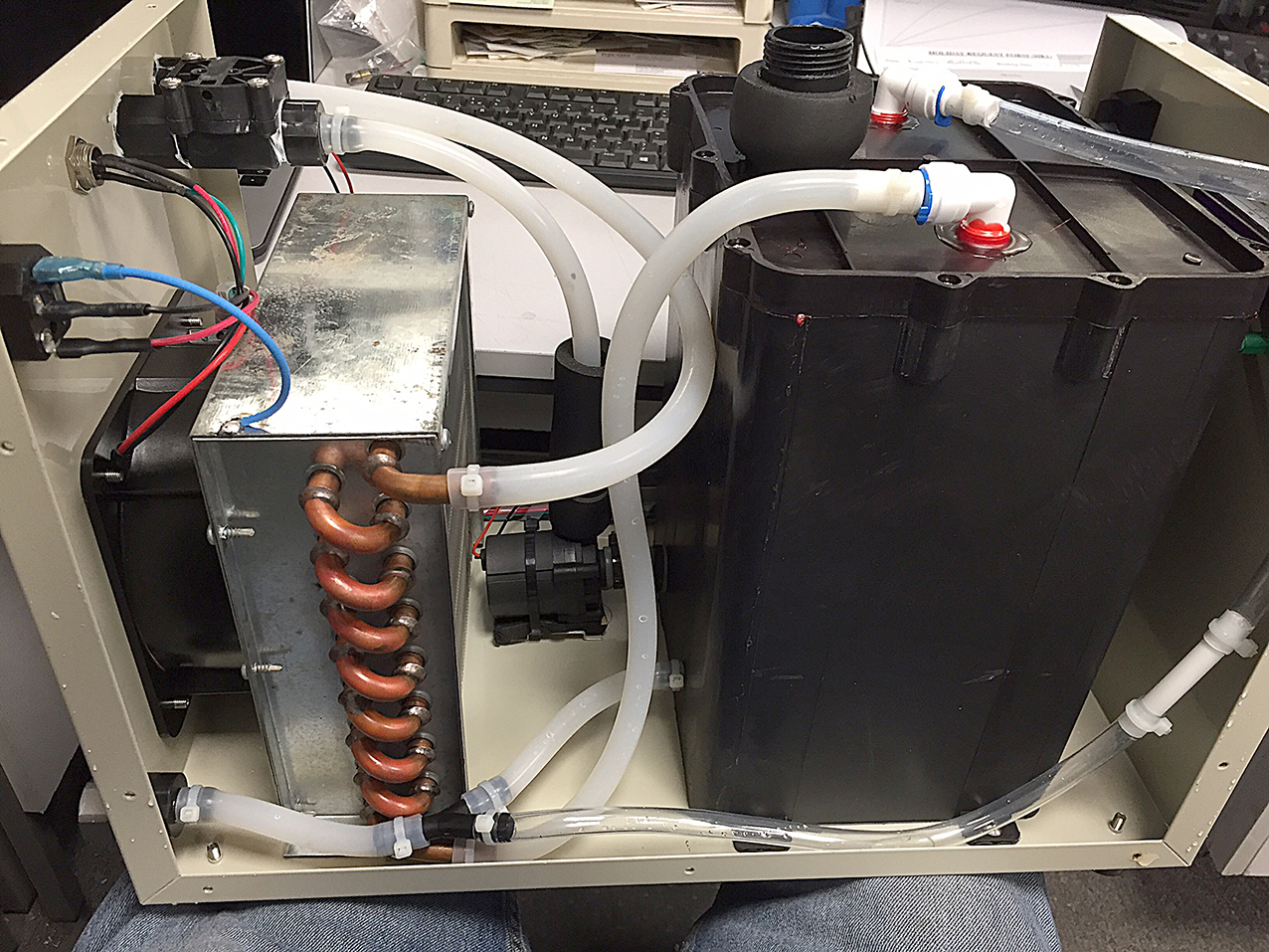

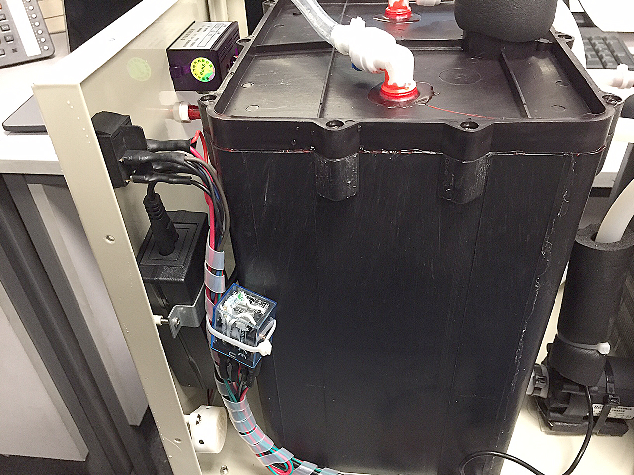

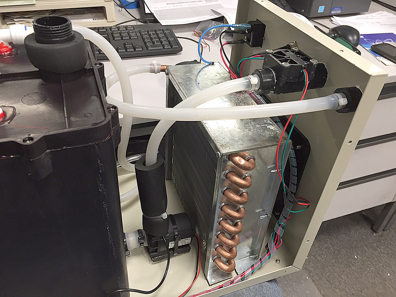

    Chiller arrived today, not really a chiller more an active radiator but far better than a pump in a bucket:)
    I was pleasantly surprised with this bit of far eastern engineering for a change...

    Nice, tidy wiring, earth connected to chassis, no more bare pipe matrix - now we have a nice finned radiator unit, wall-wart psu - nothing wrong with that, flow switch and audible alarm function nicely if you squeeze the pipe shut, thermometer reads ok, even has a liquid level display on the front.
    I might even get another for the 2kw spindle on my mini-mill.

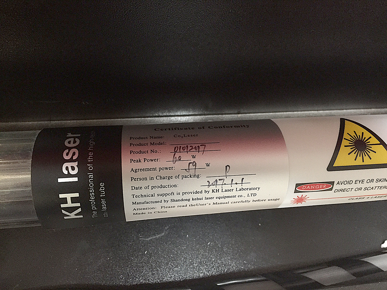

    The tube as suspected is NOT the 60W one i ordered but a 50W overdriven. It's only 1000mm long and a 60W should be 1150mm approx.

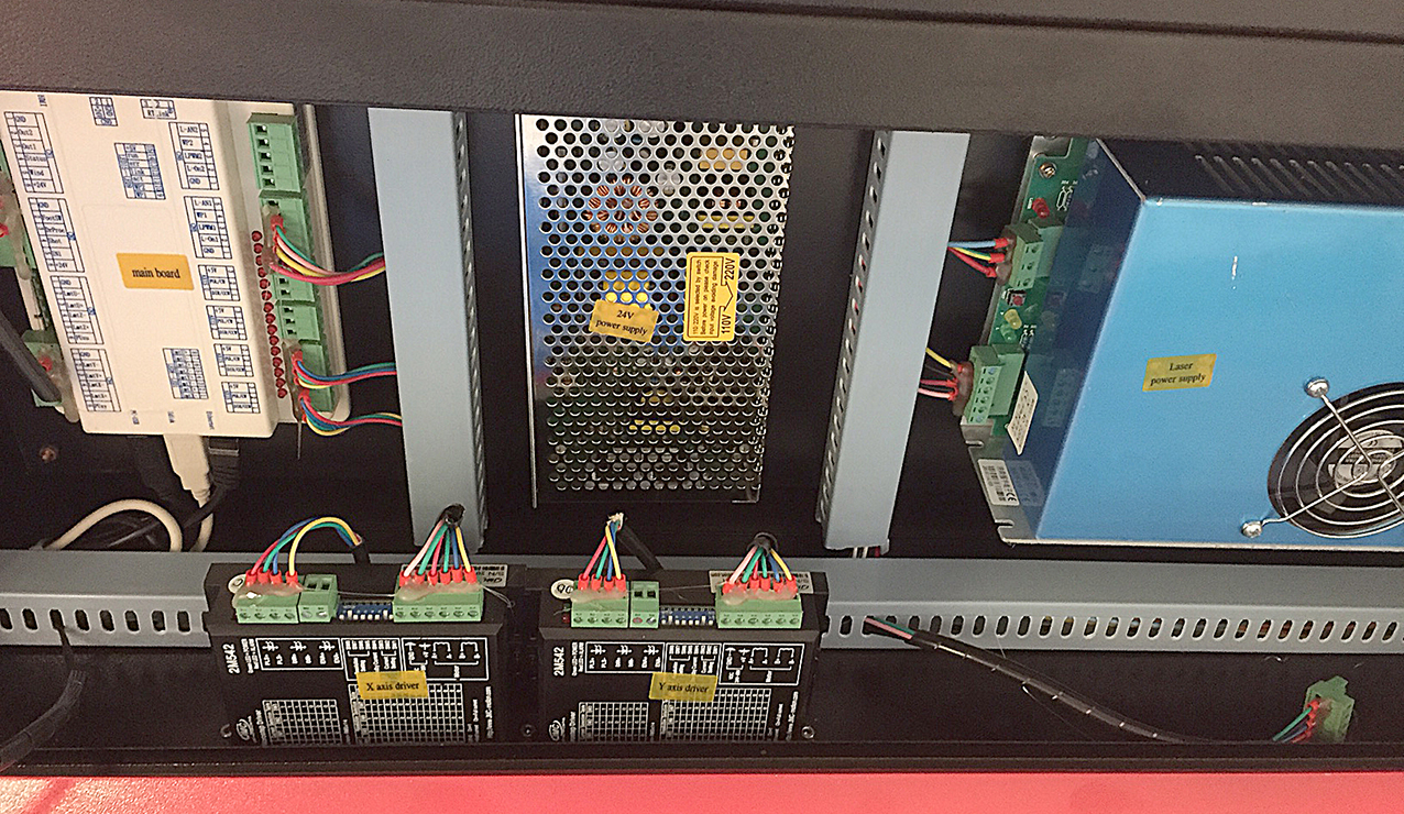

    The wiring seems well done...
    I can't see any loose wires or trapped ones etc, the safety reset button was loose, I have wound the head back/fwd by hand and it seems easy to move to so no jams there. Couple of scuffs on the paint but not worth worrying about.

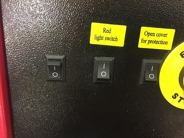

    Beware - there was a little rocker switch on mine that over rode the cover safety interlock switch - it got disconnected very quickly - I'd like to keep the one eye that I have left !
    Obscurely labelled 'Open Cover for Protection' what it actually does is remove the protection of the cover safety switch !

    Yeah i have that one too, i am ok with safety, got goggles etc.
    The cover safety switch was smashed on my one anyway - its all in an email to the supplier tonight along with the fact that its a 50W not 60W etc
