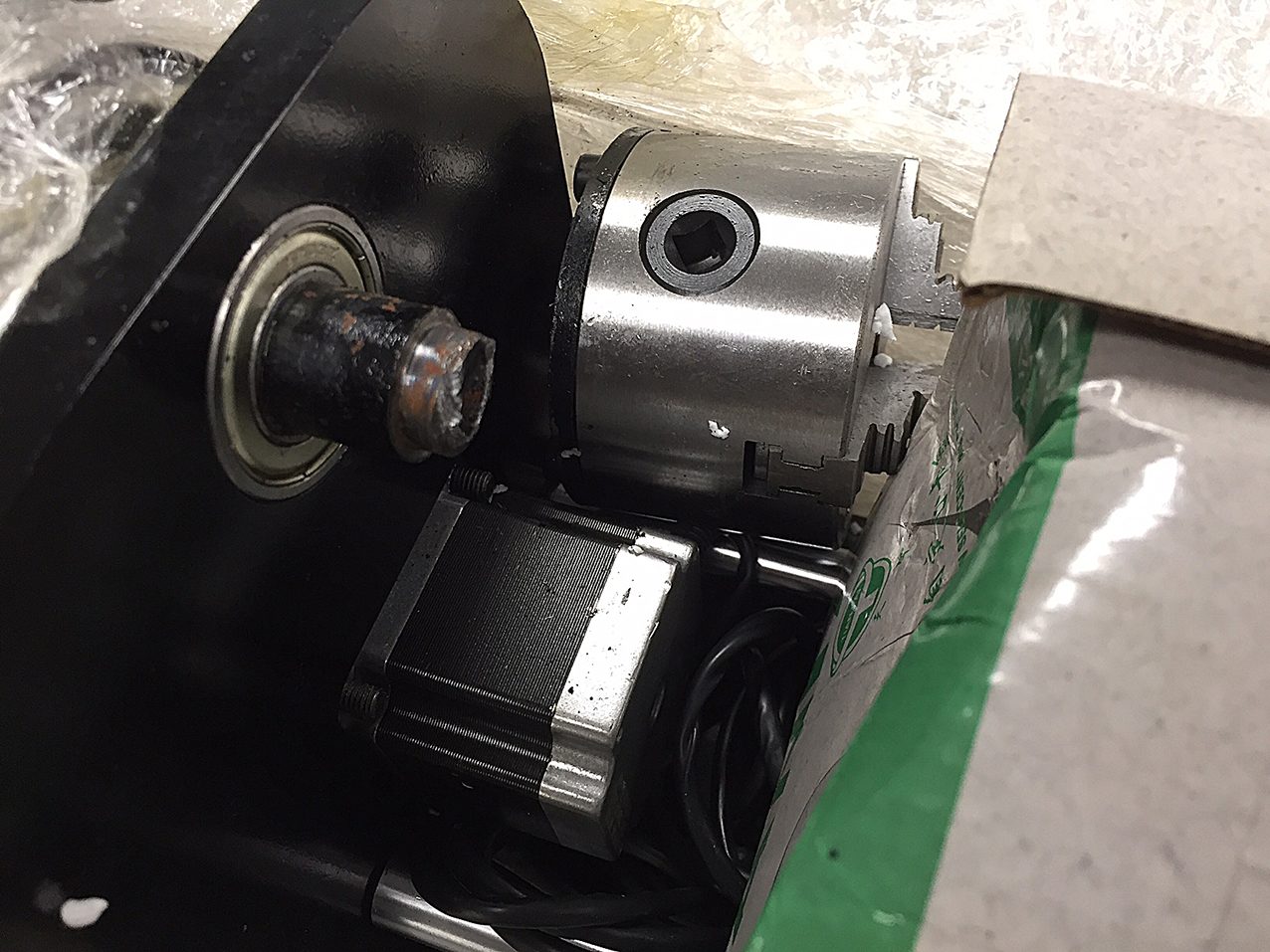

    The rotary attachment arrived today - totally wrecked as the chuck had broken the shaft that mounts it and was loose in the box, unusable and a complete waste - the box that should have held the chuck was in there so why was it fitted??
    My thoughts were previous customer return item.
    emailed supplier with a photo.

    This would be an easy fix - re-weld the plate and true up on the lathe but that's not the point :)
    See what they say in the morning.
  4. #24
    Broken weld, if you call it a weld...

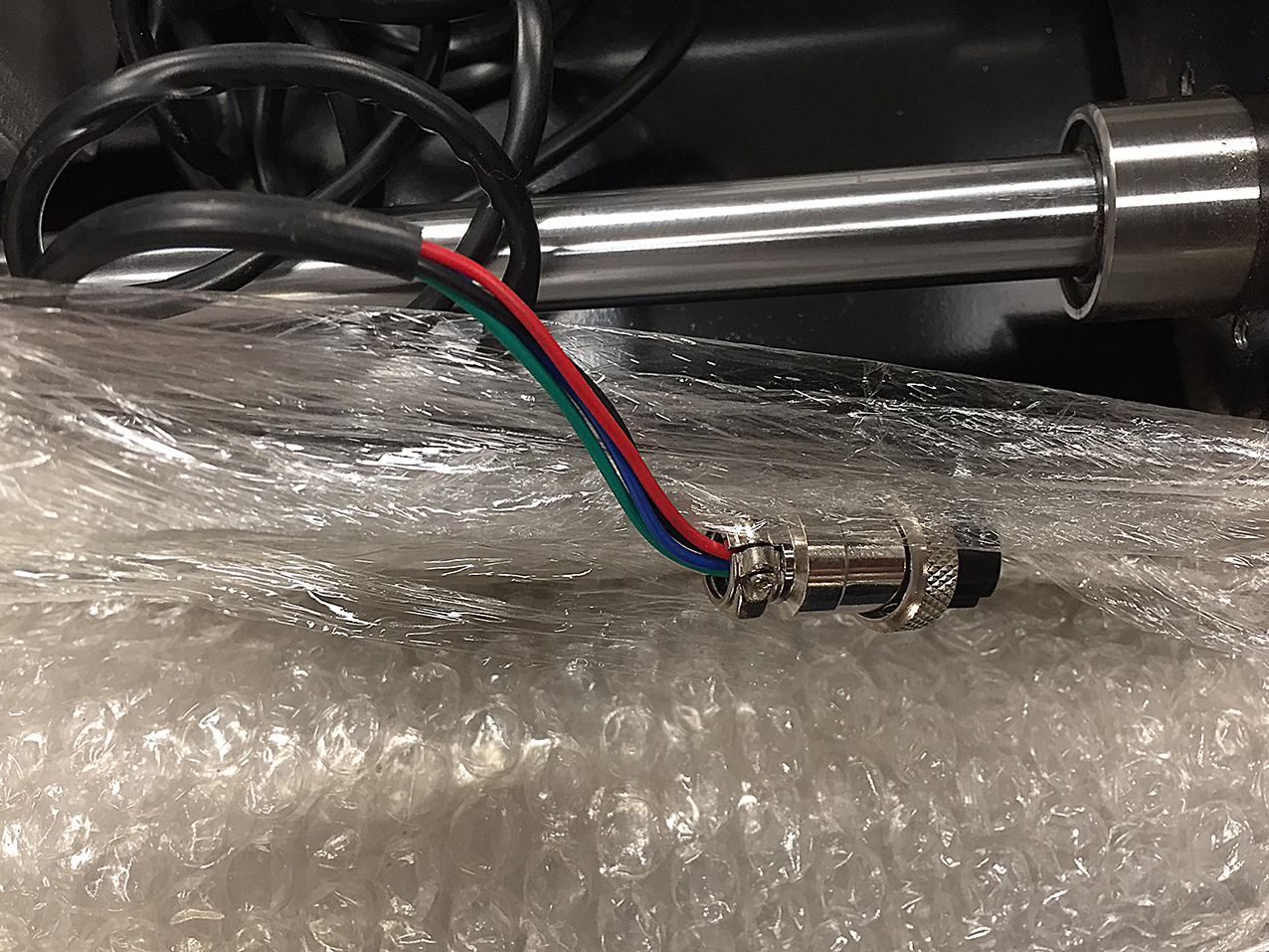

    Nice wiring....

    Oh, and my cable outer also was stripped too far back to use the clamps like yours, but I found that by friction warming the outer by gripping with a cloth and sliding it, I could ease the outer far enough down the wires to get under the clamps (which are too large a diameter to grip, but a bit of the serrated end of a tywrap makes up the gap sufficiently !

    Ground the bird-sh1t off, turned a bevel on the stub so there was somewhere for the weld to fill, nice heavy fillet, turned the flange true to the shaft, refitted it.
    Also drilled a couple of divots for the pulley screws to locate into.
    I'll also replace the crap allen screws which appear to be M6 but have a socket that fits nothing with some proper M6 ones !

    Good recovery Dave
    It has been said before that this Chinese stuff has to be considered a kit of bits
