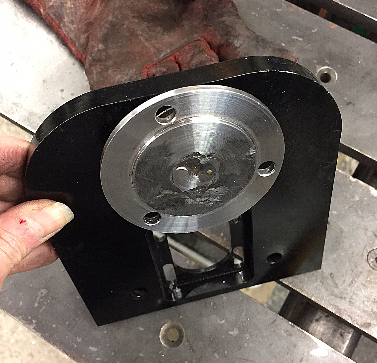

    Ground the bird-sh1t off, turned a bevel on the stub so there was somewhere for the weld to fill, nice heavy fillet, turned the flange true to the shaft, refitted it.
    Also drilled a couple of divots for the pulley screws to locate into.
    I'll also replace the crap allen screws which appear to be M6 but have a socket that fits nothing with some proper M6 ones !

    Good recovery Dave
    It has been said before that this Chinese stuff has to be considered a kit of bits
    I just hate the wastage of materials etc.

    I have to say that you do get a lot for your money, and if they'd only spend just a little more time on those final steps tidying up the silly mistakes they would be supreme value. Beware - that is the future !
    If this is the future then there is not much to look forward to i feel ;)
    I'm on the side of good quality workmanship, taking pride in your work etc, that's what grates my nuts when things like the rotary get shipped with a 4lb chuck fitted on a weak flange - it took some chinese person some small amount of time to make that unit - simply shipping with the chuck in the box and it would probably have lasted forever.
