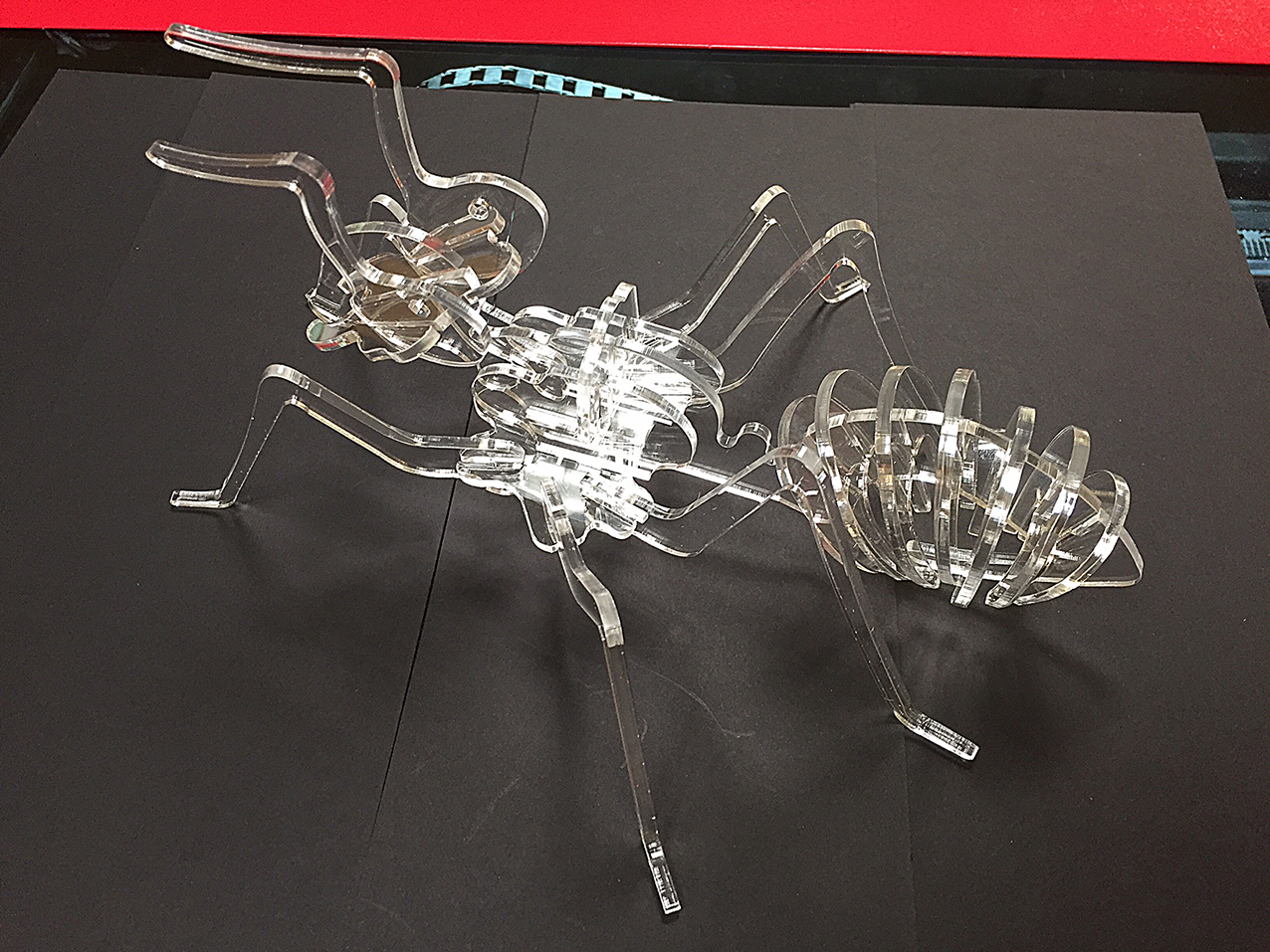

Messing about with acrylic now, good so far but i think it needs tuning properly as not cutting as thick material as i hoped so probably losing what power it has somewhere, mirrors need cleaning too - is Iso Propyl Alcohol ok on them?
22-03-2017 #50
Yes IPA on a cotton bud
I bet that your mirrors need tweaking after shipment
