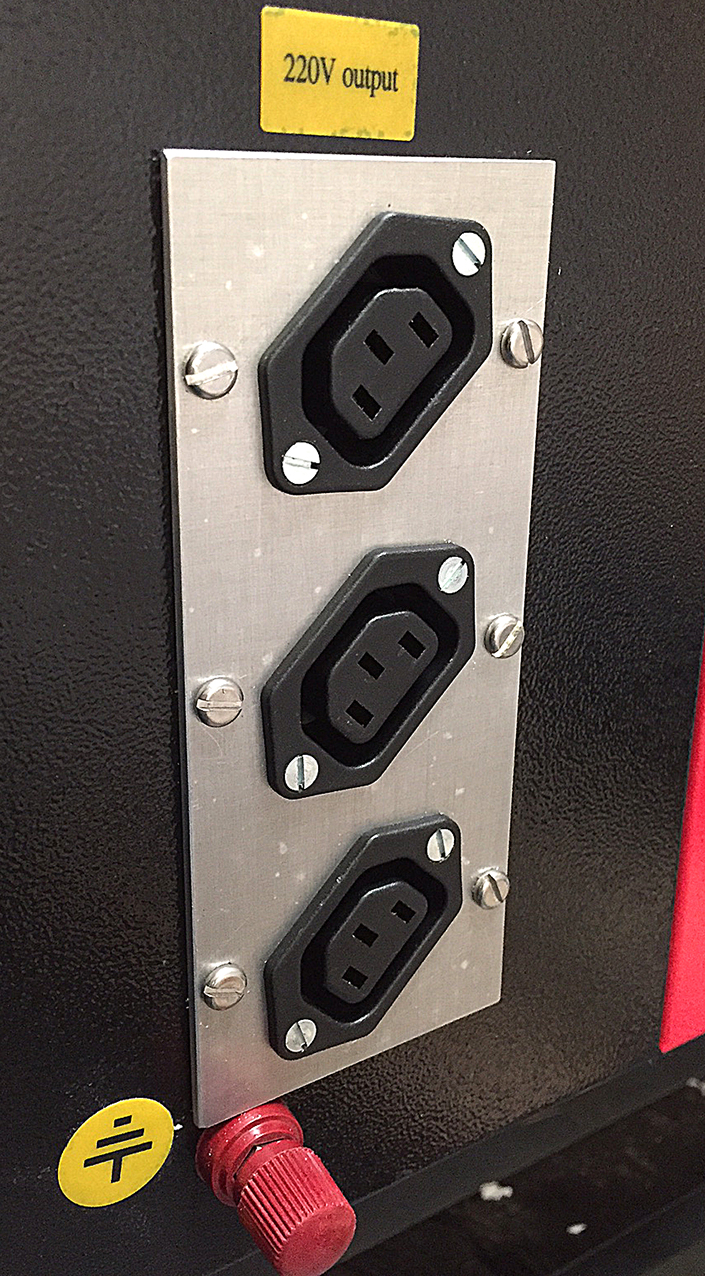

    Tomorrow i'll be replacing the death-trap 'universal' sockets on the back with IEC ones - milled out a nice aluminium plate tonight to mount them in the original holes ;)

    Nice neat socket plate with decent sockets....
    Also fitted a relay to the top socket so i can turn the extract on and off from the front panel :)
