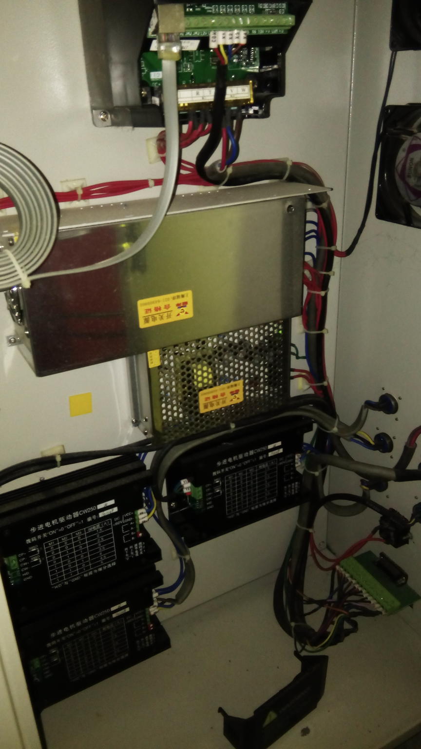

    you can control the spindle from nc studio on the pc however as soon as your raise the spindle speed over 10000 that is when it cuts out, it strats back up as soon as you go back down.

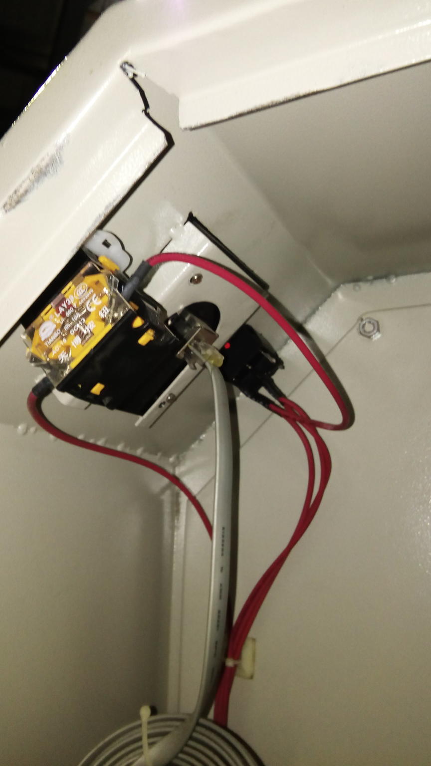

    I will take a look were the grey cable goes when I'm next at the machine.
    If you could tell me what the values should be for each of the program setting that would be great! the setting the chap on cnc zone unfortunately did not help. the spindle is 220v 6A and we are on 240v mains power here in Australia.

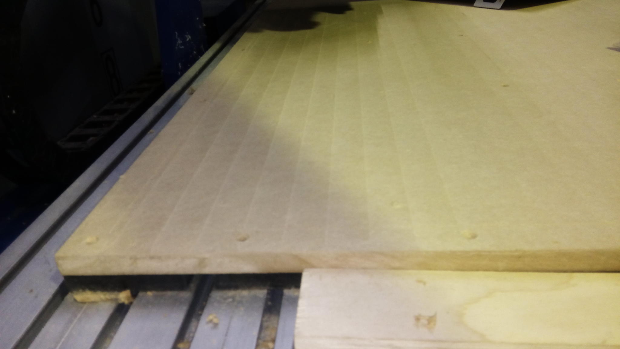

    On the Rails and bed/steps then this sounds very much like the frame or gantry is twisted. It's affectively rotating the tool on it's axis as it moves along the twisted surface rails are mounted on.

    we have been in contact with the supplier however the only manual we can get for the inverter in in Chinese, were that English scanned copy came from I have no idea and I have spend a good few hours searching and emailing around.

    The grey cable in the vfd is just the cable to the second screen on the outside of the metal box.
    The bed level thing still doesn't make sense to me, if it was twisted you would expect it to be out diagonally not even down the axis right? Not sure how well the pic shows it but it goes from smooth on the right to bumpy on the left but the bumps are even all the way down. Something is out but what.

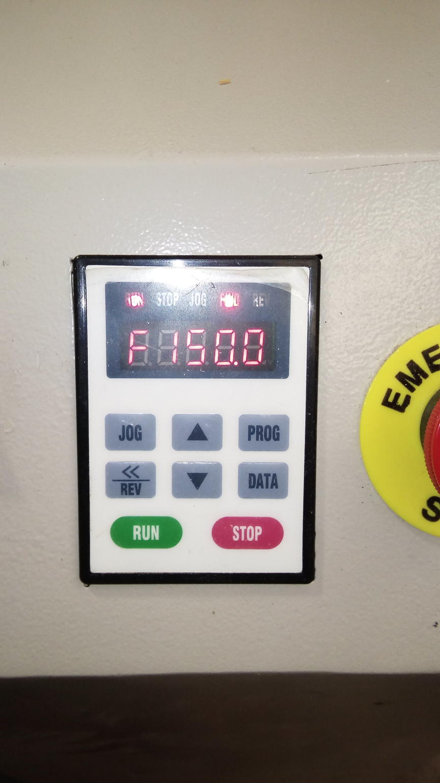

    Ok. The spindle and the VFD.
    So you have GDZ or similar 230V Spindle 3 phase?? right capable of 24k rpm????? + 230V 2 phase VFD
    You have just a couple of buttons connected. I can not see from here which is which so you have to trace them and program them again, after you finish programming the spindle.
    Ok, step by step:
    -PR133 1 restore factory settings
    -PR000 4
    -PR001 4 / dont forget later to check buttons if connected properly
    -PR003 1 / you will never need reverse run
    -PR008 1
    -PR027 220
    -PR29 400
    -PR033 400 / that possibly is not set right at the moment
    -PR038 400
    -PR039 0 / so motor works from 0 to 24k rpm, obviously no much torque when less than 3k rpm/
    -PR040 10 / 3-5 is also ok for that motor, but 10sec to be on the safe side/
    -PR104 to PR111 - check if you buttons are properly programmed, / start stop etc. You don tneed reverse, so use it for sth else/
    So thats it. It should work ok now.

    cheers many thanks will try that next time I am up there!. the only things buttons on the box are a power switch, kill button and a second vfd panel.
