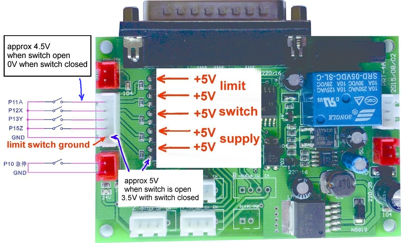

    It drops to about 2.8 - 3.0v
    Hi Kev
    the voltage drop on the printer port pin to 2.8 - 3V is too small
    you should have it dropping to near 0V when the switch closes
    assuming the opto-isolators LED is powered from +5V
    this is what I'd expect for the breakout boards limit switch input
    corrected diagram

    Sorry my mistake, misunderstood what you said the voltage when the switch is presses is zero volts

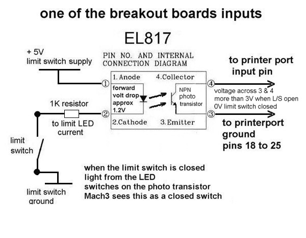

    Hi Kev
    do you use two seperate power supplies for the breakout board ?
    I have made a correction to the diagram in post 12
    this is how I expect the breakout boards input circuit to be
Name:	the breakout boards EL817 input circuit.jpg
    from the limited detail in the photo of the breakout board the two regulator IC's appear to be LM317 plus resistors = 5V regulator for the 74HC245D IC's
    LM2576S switching regulator = 10V regulator for the analogue VFD drive
    John

  5. #15
    Hi John. There is a 24v which I think is for fan and 5v which is for the drivers. I've been playing around with it all night but still no joy. Just a silly question but should the switches be carrying voltage ? Because mine aren't
  6. #16
    Lives in East Lothian, United Kingdom. Last Activity: 15 Hours Ago Forum Superstar, has done so much to help others, they deserve a medal. Has a total post count of 2,994. Received thanks 376 times, giving thanks to others 9 times.
    There should be voltage at the switch, which makes me think you've not got the board powered correctly.
    What power supply do you have connected to the board?
    And do you have a link to any kind of manual for the board?
  7. #17
    yes ,
    you should measure a voltage across an open limit switch wires
    about 4V if the input circuit has a 5V supply
Name:	tx14175 bob input voltage & current.jpg
    John
    PS
    a photo of the breakout boards supply terminals will be usefull wth
    a diagram of the breakout boards supply connections
