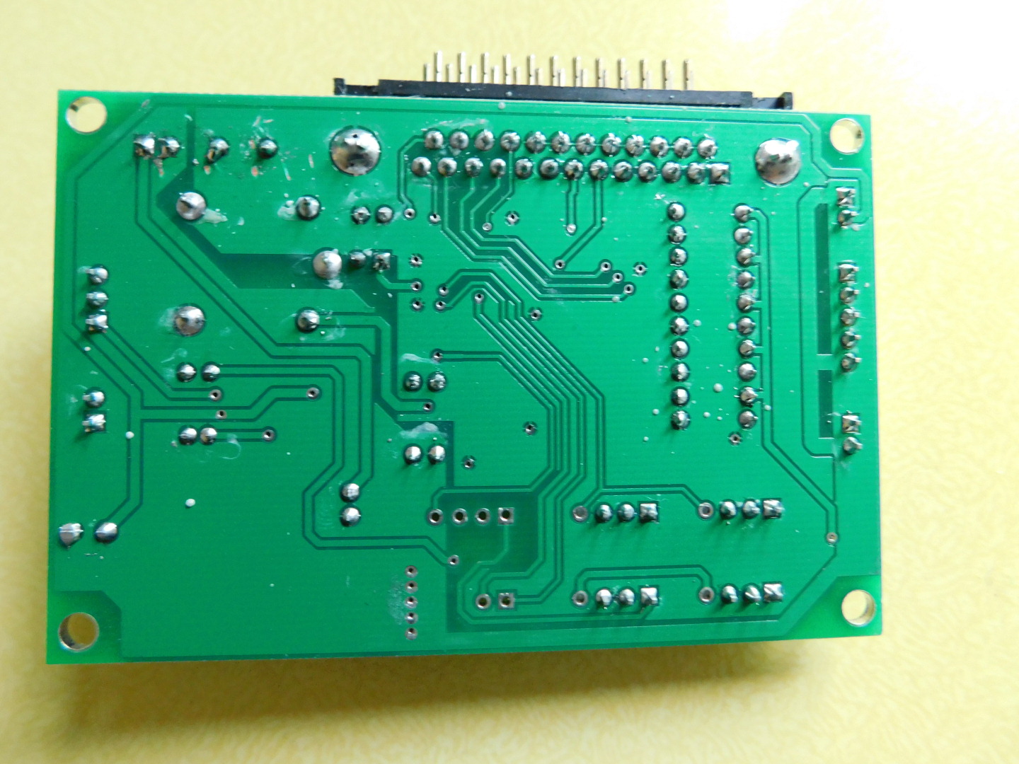

  2. #32
    Good morning, here is a photo of the underside of my bob;
    Kev
  3. #33
    Lives in East Lothian, United Kingdom. Current Activity: Viewing Forum Superstar, has done so much to help others, they deserve a medal. Has a total post count of 2,994. Received thanks 376 times, giving thanks to others 9 times.
    So if the 24V LED is lighting up, and you've got no voltage at the top left pin on the opto's, then looking at that, the fault can only be the throughhole/via.
    If you connect 24V to the board, looking at the front of the board, follow the track from the 24V LED to the via at the T-junction in the track. You should get 24V there?
    If you do, then flip the board over and see if you still get 24V on the opposite side of the via.
    If you do, then follow the track up and check to see if you get 24V at the optos.
    If it is a faulty via, applying pressure when you probe could be enough to re-connect it. If that is the problem, the easy option is to put a little bit wire through it (drill it out slightly if needed), and solder it on both sides, and that should reconnect both sides of the PCB.

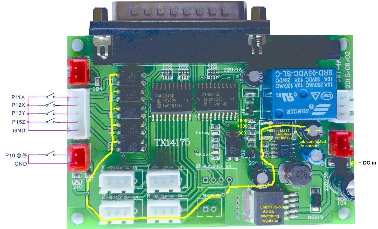

  5. #35
    Hi Kev
    using the photo's from post 3 and post 32
    I have traced part of the supply circuit powering the opto-isolators
Name:	tx14175 bob part of limit sw supply track.jpg
    the track from the opto-isolators starts of on the underside of the board
    then near to the 24V LED passes through a "via" (a plated through hole)and
    then another "via" next to the missing B axis connector
    the track ends at the + connector of the capacitor next to the LM317 regulator
    the photo is not clear enough but I expect the capacitor + terminal is connected to the metal tab on the LM317 which is connected to the regulator output
    the 1800 ohm and two 300 ohm resistors set the LM317 output to 10V
    looking closer at the LM2576 switching regulator it has -5.0 at the end of its part number indicating its the 5V version
    ( LM2576S-5.0 = 5v ouput )
    if a Via is open circuit the copper pads can be cleaned and a copper wire passed through and soldered to remak the connection
    since the "24V LED" lights the only Via to check is lext to the LED
    John
    PS
    check there is continuity from the limit switches 5 pin connector common terminal and the DC power in negative

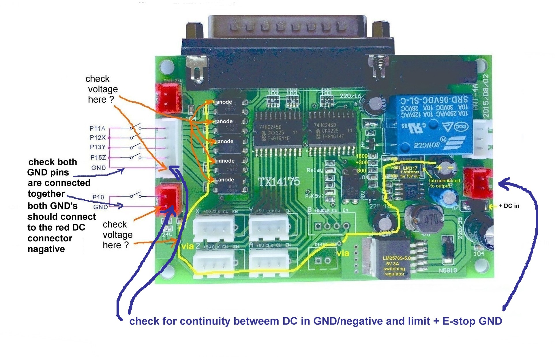

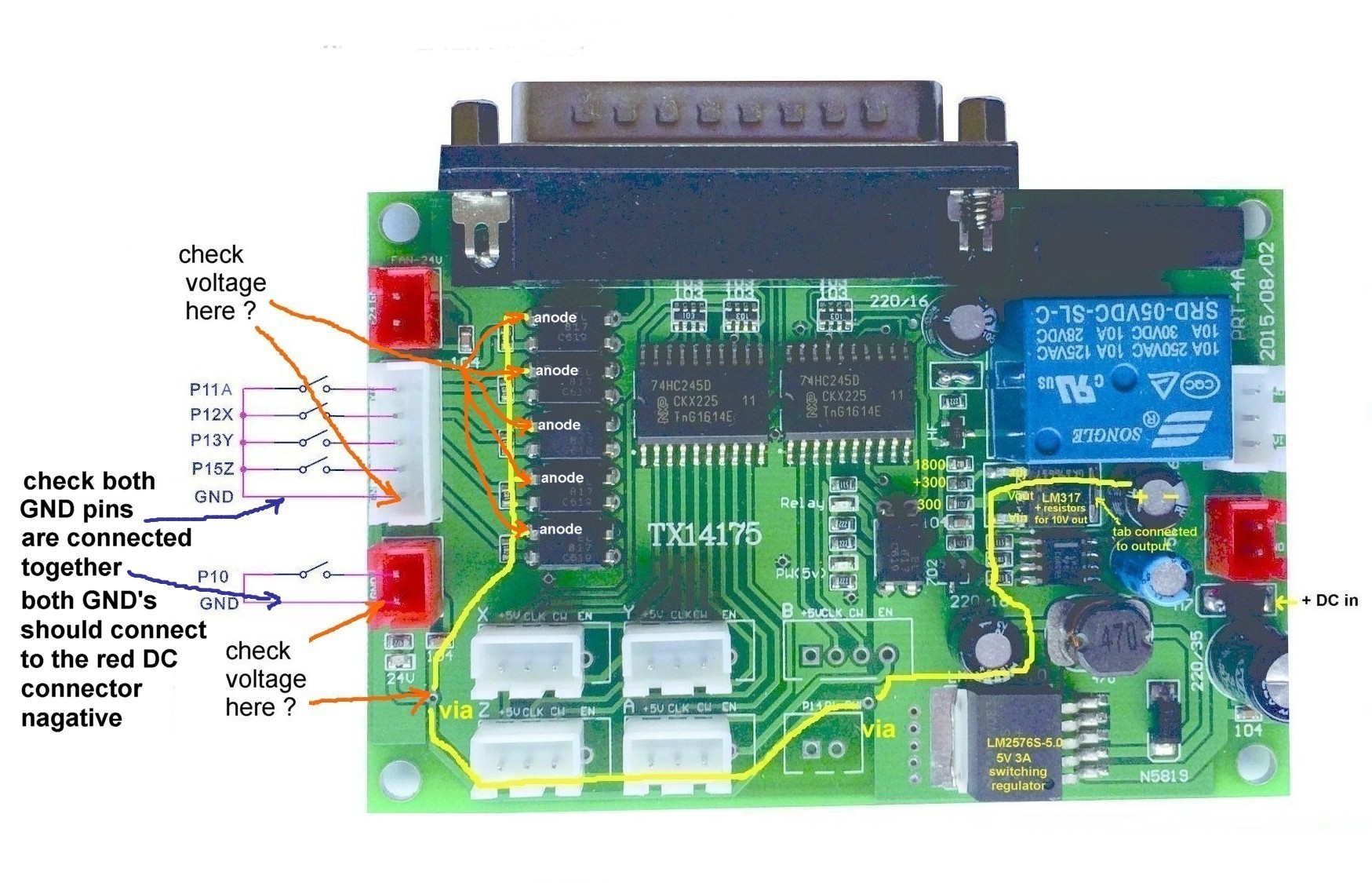

  8. #38
    Hi Kev
    you have done some of the tests I had on this diagram
Name:	part of limit sw supply track.jpg
    you may have an open circuit limit switch common
Name:	part of limit sw supply track part 2.jpg
    John

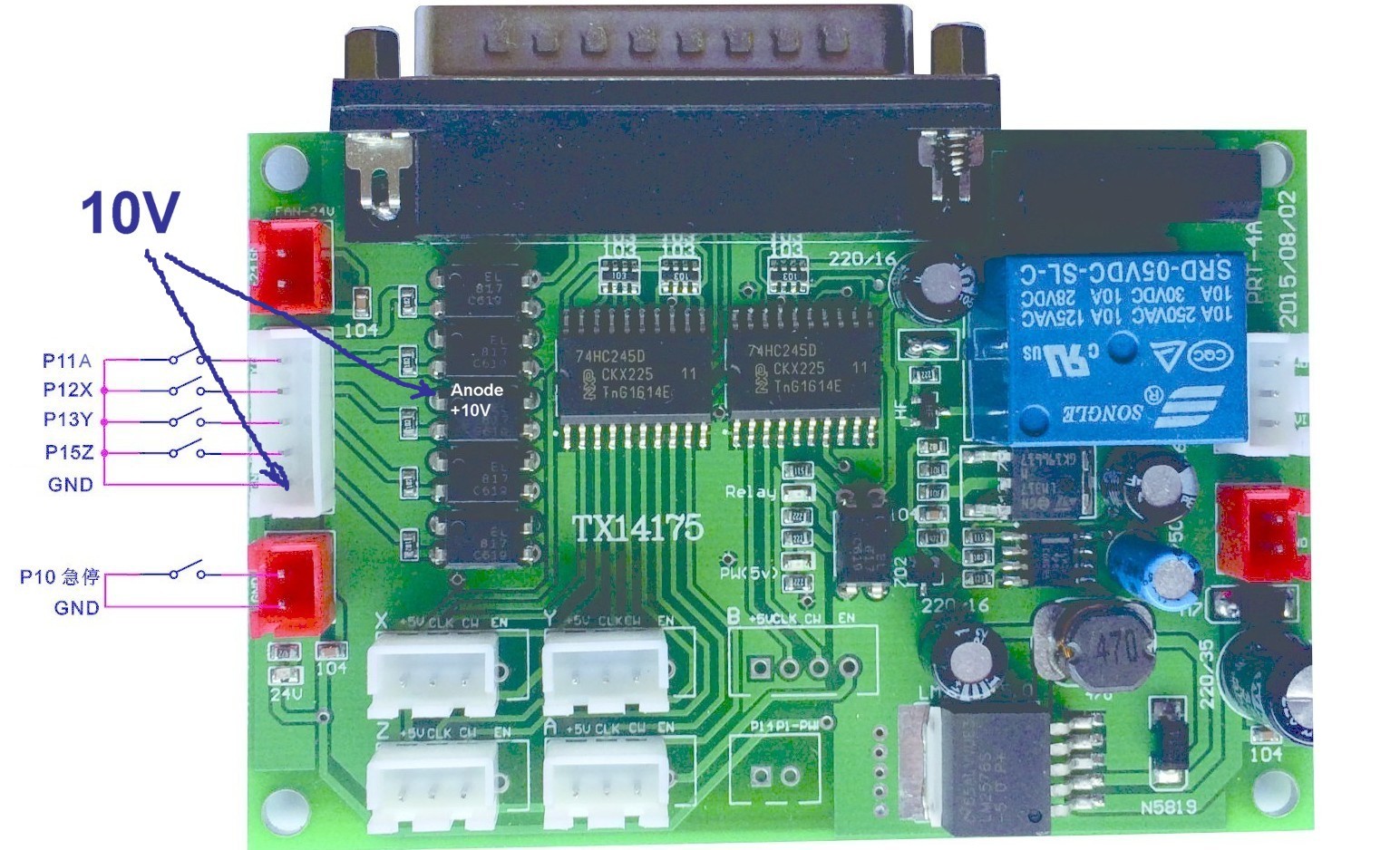

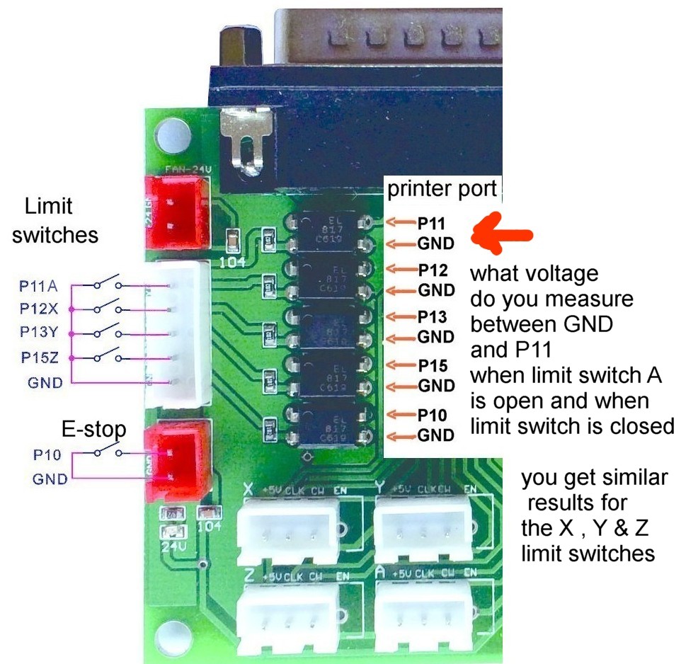

    Hi Kev
    if this is what you have measured
Name:	tx14175 bob 10V.jpg
    then I would have expected mach3 to see the limit switches operating
    provided mach3 is set up correctly and the printer port is working
    the test results for this should prove the breakout board is working
Name:	tx14175 bob printerport input terminals.jpg
    John
