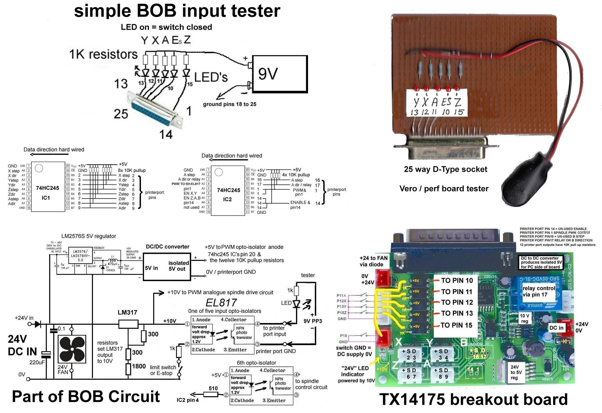

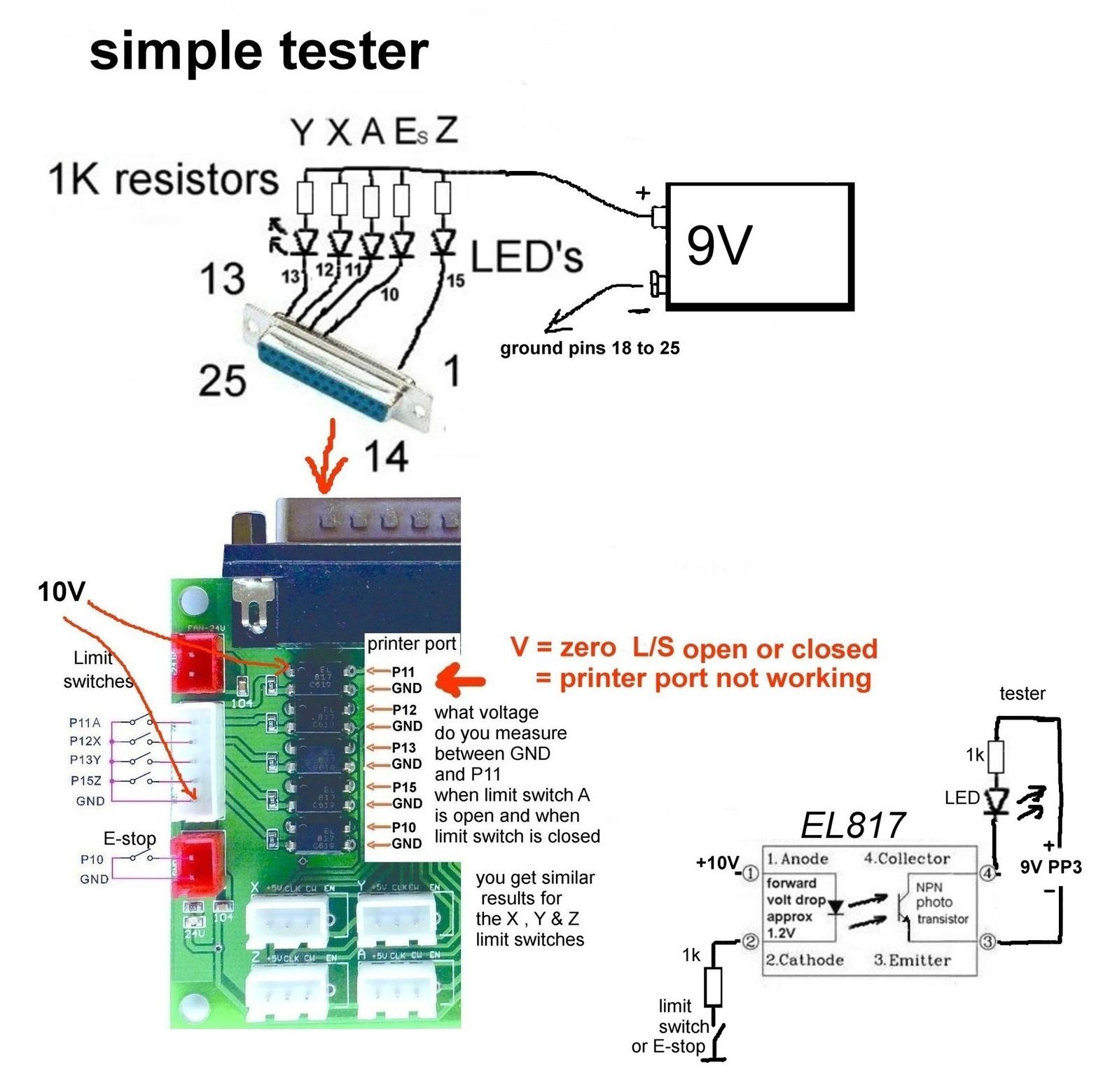

    Hi Kev
    I think a simple tester would prove if the breakout board is working
Name:	bob limit switch tester.jpg
Name:	breakout board input tester.jpg
    John

    Lives in East Lothian, United Kingdom. Last Activity: 15 Hours Ago Forum Superstar, has done so much to help others, they deserve a medal. Has a total post count of 2,994. Received thanks 376 times, giving thanks to others 9 times.
    John, I suspect you've got the optos in the wrong order.
    If you look at the traces on the top side, I'd say the top opto is P10, and it's track runs down the outside of the limit switch connector to the E-Stop connector. The tracks of the other 4 optos seem to match up nicely with the Limit Switch connector, and I wouldn't expect the bottom opto track to run the way it does if it was going to the E-stop connector.

    Hi m_c
    from post 45 "John, I suspect you've got the optos in the wrong order"
    you are correct
    now I have looked more closely
Name:	Limit Switch tester & partial TX14175 circuit.jpg
