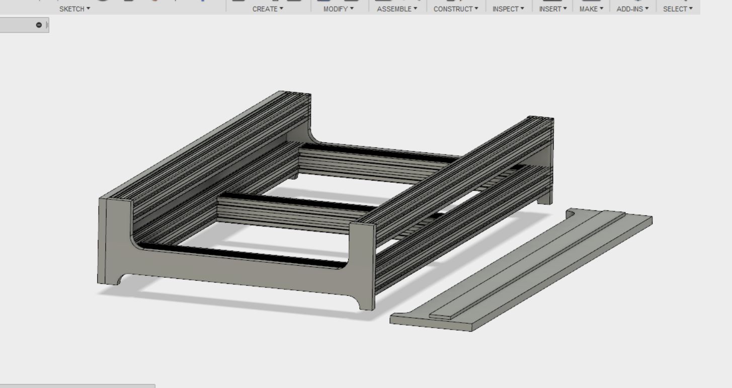

    Any pictures of a 'strong' 600 x 900 size machine I should be using for inspiration?
    My first build from signature, that i did for a friend. Free plans in Sketchup are somewhere in the build. if you are not happy with gantry you could do that from alulminum L shaped or box shaped, though i dont see a reason. that machine is 400x1000x180 but you can widen it without changing anything. all else stay same. It can support up to 5-7kw spindle without any problem. but put a 2.2kw or 3kw spindle there and you have it.
    I dont know what exactly you are looking at, Charlie? Why the indecision? The above said is easy to do and i could send you the plans for free if you dont find them in the thread. I could send you for free also the plans of my second machine, but you have to shorten it yourself for half sheet and figure how to put it together, cause i simply dont have a time to support that plans on every step of the way. Each of them will result in a machine that is tested, proven and without any weak spots
    As Dean said my designs could not be the greatest innovations, but both machines a build, tested and have no faults.
    PS. I have not cut aluminum lately but here is a short video i made once. 6mm bit, full depth i believe at ~2000mm/min. Perfect cut and perfect mirror like finish, though can not be well seen on video. listen to the sound of the machine, then go youtube and compare. Did i say Z fully extended...
